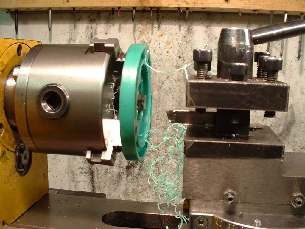

            I just turned the existing plastic covers so they would fit with the roller bearings in place, I can't remember exactly what I had to do but it was fairly obvious looking at the job. Over many years I haven't had any problem with swarf getting past them to the bearings.
            Also don't pack the bearings solid with grease, best only to fill about 30%. This should also avoid significant squeeze out of the grease.

              I found this from when I wrote up my bearing swap:
              "It is now possible to remove the 45-tooth bull wheel, wangle out its key and remove the long plastic spacer, followed by the plastic bearing shield which is held in place by three cap head screws. The two ends of the mandrel are covered by these plastic bearing shields. I found that I had to recess the inside of the bore of each shield by 2mm to clear the inner races. Unfortunately this only came to light once I had swapped the front bearing. I therefore had to recess the front shield by hand using a burr in a mini drill. An alternative is to recess the rear shield before removing the mandrel, swap it for the front one at the appropriate time, and recess the other shield when the mandrel is re-assembled. Unfortunately, to do this you will have to temporarily replace much of the drive gear. Whichever way you decide to proceed, the front shield will also need to be released before the mandrel is extracted. This is easily done by poking an Allen key through a hole in the mandrel flange."
