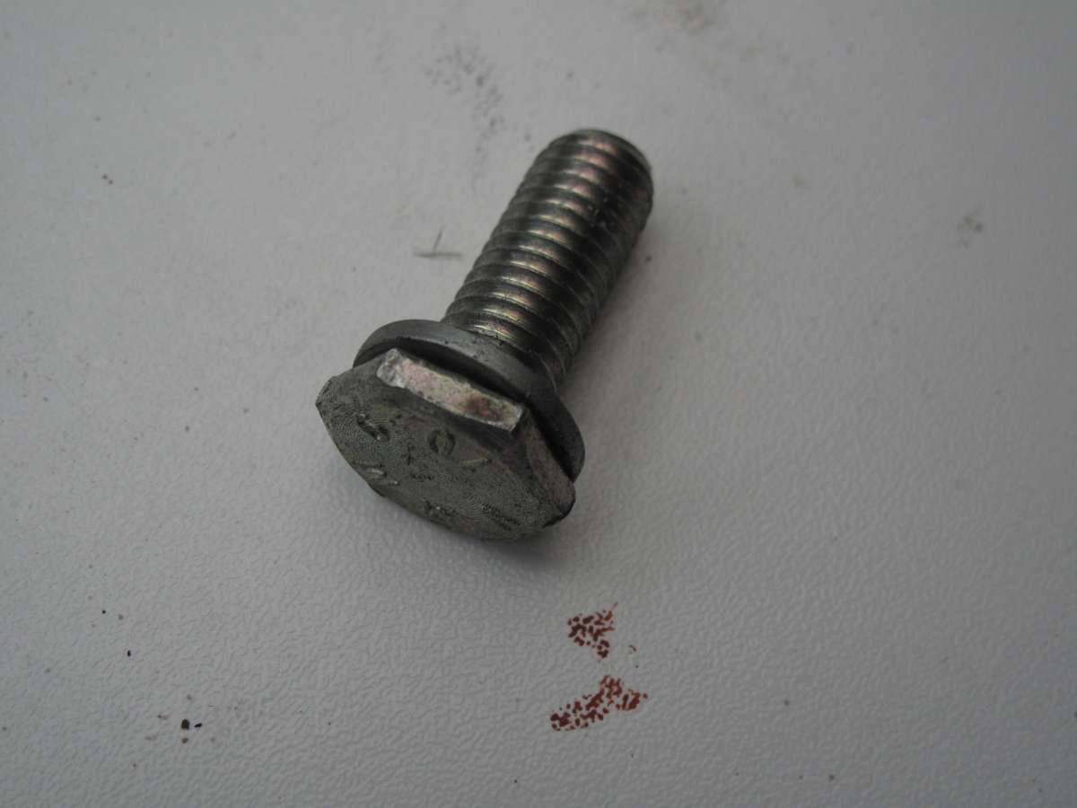

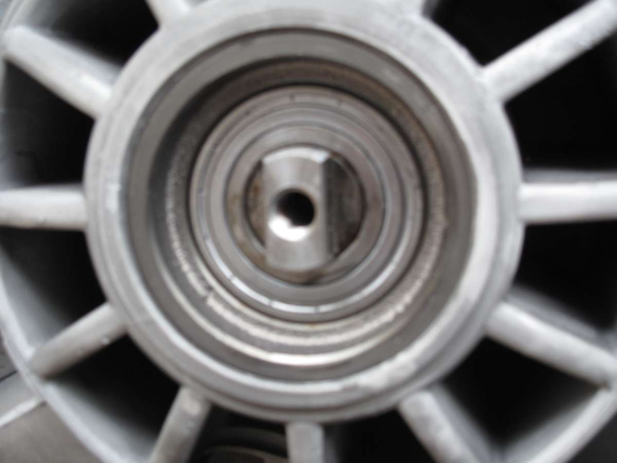

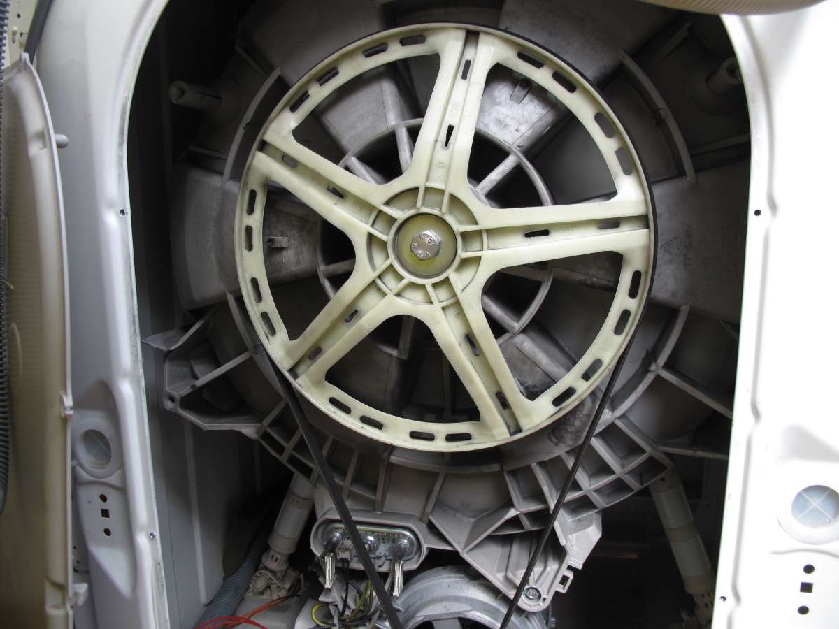

                                    Here is a few pics: the outer drum, a close up with pulley removed showing the bearing and housing, and the pesky 17mm low profile bolt.  The latter seems intended to put off maintenance/repairs.  I was lucky to find a 6 point socket and breaker bar without universal joint. I wedged a piece of bar in one of the recesses to brace the pulley, luckily for me no locktite was present considering the plastic pulley if I need to heat the bolt.
                                    Now I only have to figure out the extraction method.  Those with an observant eye will notice no bearing code, crafty B*@@ers have hidden it on the inside! IMG_6394IMG_6395IMG_6396
