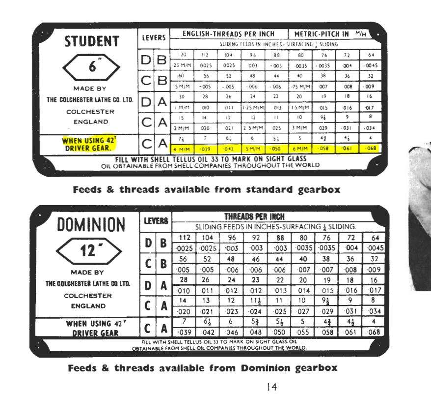

      Hello to all , I have a Round top Colchester Student lathe rebuilt it some years ago only used it for general machining as I have lovely Exe 3.5 ” lathe that I have also rebuilt that I use mainly all the time as its so handy ,a good friend is trying to make a replacement spindle nut for his Abora milling machine the nut is 62mm x 1.25mm which he cannot cut on his lathe with out buying a 127t gear, looking at my Colchester the screw cutting chart states that it can cut a 1.25mm pitch thread by using a 42t gear on the headstock and a 21t gear on the leadscrew with the gearbox levers set at D&A and the tumbler shifting arm inline with the 1.25mm pitch on the gearbox setting chart on the gearbox with the machine set at these positions I tried to cut a thread it was miles out measuring the thread it was 4.5mm pitch I have re checked the setting and are correct to the Colchester manual this is the first time I have attempted to screw cut on the machine so if anyone has any ideas what I am doing wrong they would be greatly appreciated.

          Please link to the manual you have so we can all read and hopefully come to the same conclusion. The one I see only uses the 42t gear as a driver in position C/A for 4mm, 5mm and 6mm metric pitches. It says that 36 pitches can be cut using the 21t driver, but the remaining 9 (at the coarser end) need the larger driver. This makes logical sense. It does not make sense to use a large driving gear for a fine pitch thread.

                    The way I read the manual is that you do not need the 42T for 1.25mm pitch, only the pitches on the bottom row of the chart need the 42T which as it replaces a 21T will double the other pitches from the CA range.
                    There is also no mention of changing the gear on the leadscrew , only changing the 21T driver for the 42T. But as you don’t need the 42 just leave as it was.

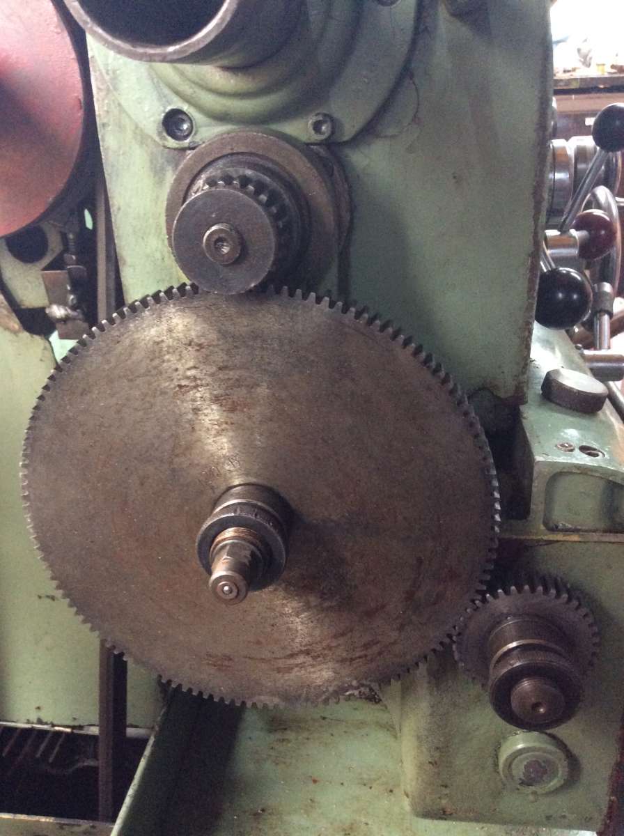

                            I have a suspicion that the 35T should remain on thegearbox imput and that the 42T is just stored there when the 21T is being used a sthe driver, Bernard should be able to confirm. That is why just changing the headstock gear from 21 to 42 doubles the available pitches from the line above.

                              Yep you are right mine is 21/120/35 and I also have a 23/24/26/27/28/42/48/127 in the drawer which is where they’ve been since i bought the lathe.IMG_3932

                                Thanks for confirming what I thought.
                                So geartrain shoudl be 21/35, that equals 0.6
                                OP has 42/21 which equals 2
                                2 divided by 0.6 means the leadscrew will be turning 3.33333 times as fast as it should
                                3.333333 x 1.25mm will give a pitch of 4.167mm
