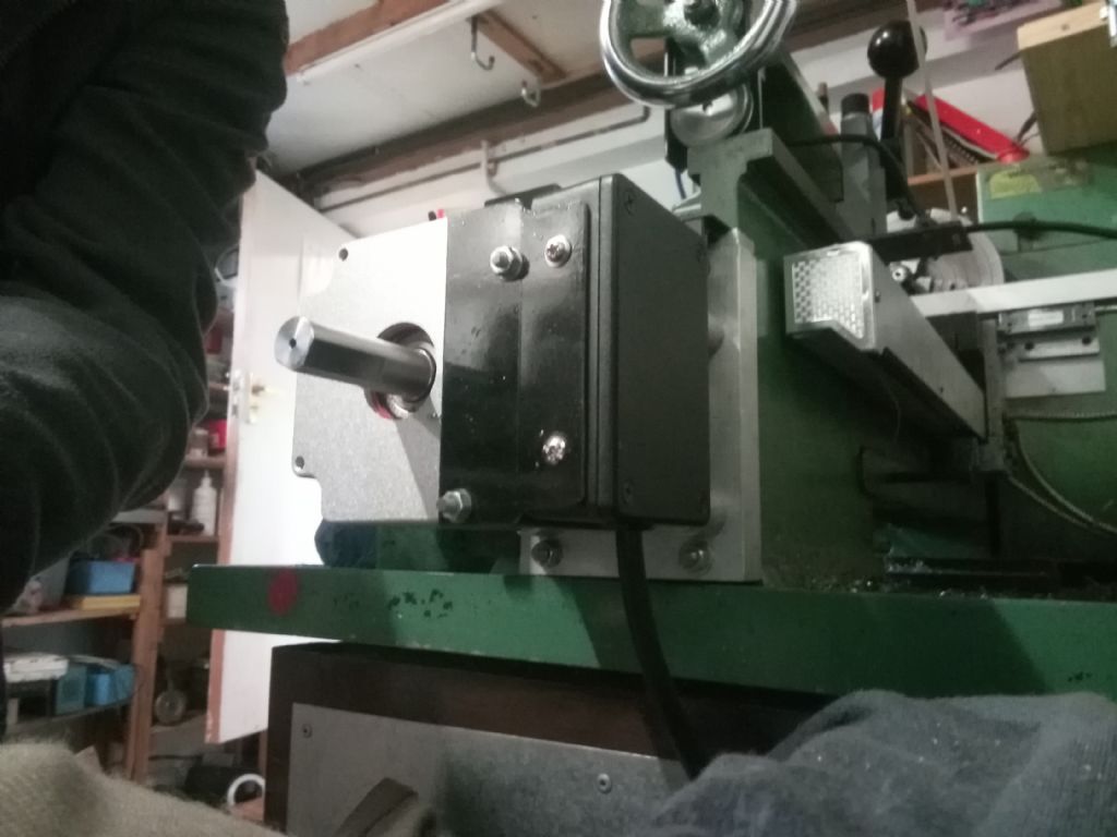

          duncan webster 1
            @duncanwebster1
            What I did was make up some longer bolts to replace those which hold the whole thing together and use them to hold a plate to the end. This plate protruded beyond the connector and supported a plastic box, in the side of which I had a grommet to support the 4 core cable. My motor didn't have a plug socket arrangement, so soldered connection inside the box
            Not a brilliant photo, but it might help. I'll take a better one if it would help

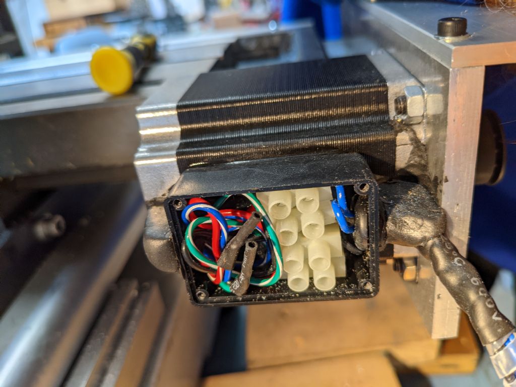

                    John Haine
                      @johnhaine32865
                      Sugru is excellent for "potting" since you can mould it round the item and it supports itself.
                      Another method I used on the steppers on my lathe and dividing head, which have flying leads emerging from the motor, is to drill a hole at one end of a small plastic project box, pass the wires through the hole into the box, and glue it down on the side of the motor with Araldite.  Then terminate the flying leads with terminal strip inside the box on to multicore cable run through a grommet, screw on the box lid, and if necessary use a tie wrap round the flying lead for strain relief.  Will post a photo if I can find one.
                      This is the X axis drive on my VMB mill.  It uses a Type 23 stepper so a bit bigger, you would need a smaller box.  In this case the 8 flying leads from the motor needed some interconnect to put the windings in series, so they are soldered and heat-shrink sleeved, then the non-commoned ends connected to the choc bloc segments to connect to the leads to the driver – this could have also been soldered to save space.  The leads were actually led in from the end of the box, and protected by moulding Sugru around them.  At the other end the cable I made up has a spiral nylon binding, fixed at the otor end with heat shrink, and again moulded in Sugru.  Box lid has been unscrewed to get this shot.
                      Edited By John Haine on 19/08/2021 12:00:28
                      Edited By John Haine on 19/08/2021 12:23:42

                          #558959
                          duncan webster 1
                            @duncanwebster1
                            photo below, but mine is a much bigger motor. There is a slight bend in the plate to accomodate the draft angle on the plastic box, and 2 of the motor securing screws have been replaced with longer. Mine were tapped into the outer end plate, not recessed like the OP's. It's not the easiest place to take photos, can't get camera far enough away reallyimg_20210819_120001.jpg
