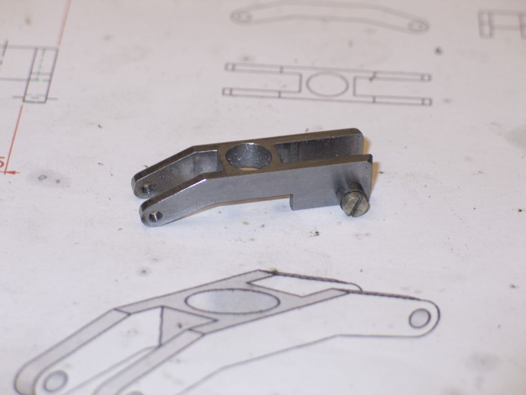

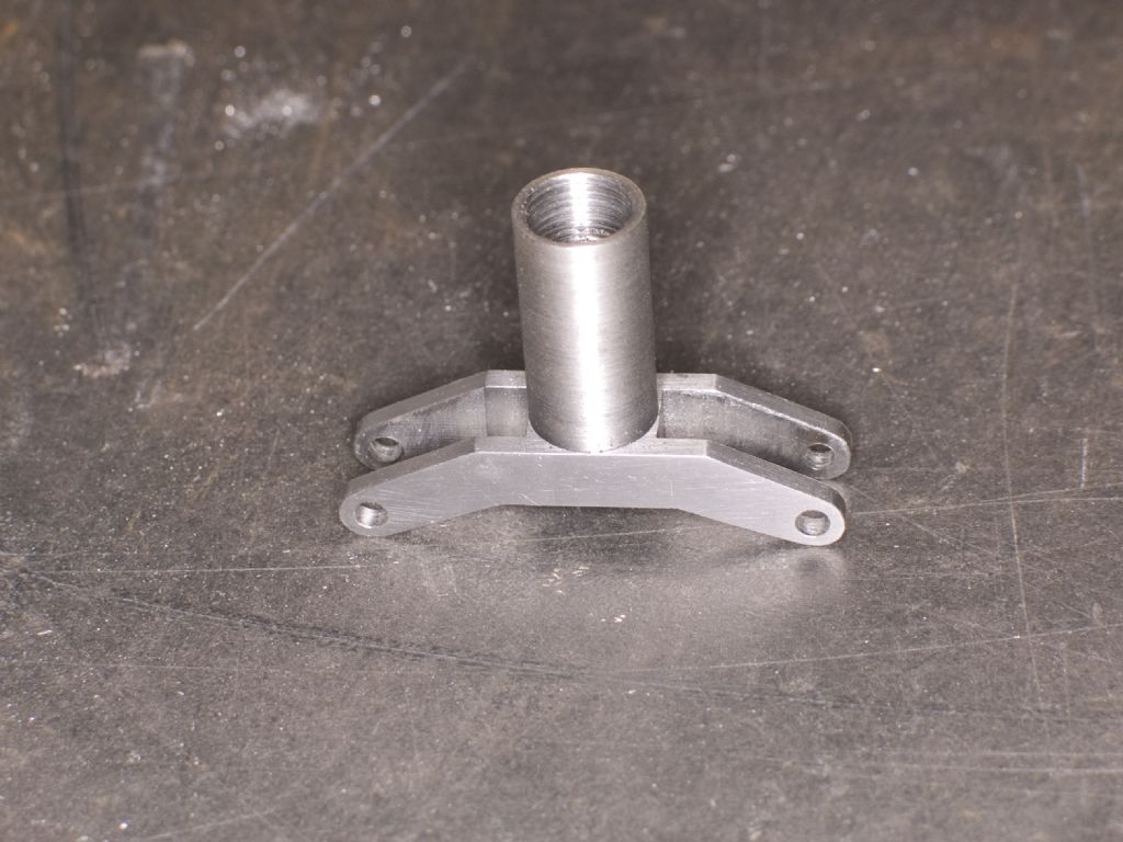

            You could make some hardened filing buttons and use a selection of files with progressively finer cuts to get a good finish.
            This should give you an idea of what I mean.
            Phil
