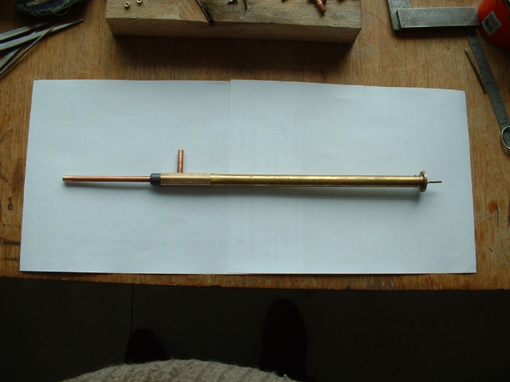

                        Here's one I made for my 2½" gauge Helen Long:
                        If I remember correctly, the thread on that is 3/8" Whit. The seat is bearing grade PEEK which contains PTFE and Graphite. The spring was supposed to take up any backlash in the thread but proved to be unnecessary,
                        I made a couple of smaller ones for two Tich's that used 5/16" Whit threads.
                        As Fizzy says though, ball (gas) valves are very good if you have the room to fit one. Just make sure it is rated for the pressure and the temperature.

                          Could John Baguley be persuaded to post drawing of his Tich regulator, save me dreaming up my own?

                            My little Tich has the same type of regulator as John Baguley's posting shows above. It's been what must be getting close to 30 years now since I made it, and it has been problem-free.
                            I believe that the thread was 1/4-20 UNC, and the end of the spindle was about a 45 degree taper, but that's from memory. The 1/4-20 thread was the coursest thread I could find in my taps and die collection.
                            The regulator has been problem free.
                            Just another thumbs up for that design.

                              Thanks for the postings, all very good information, one question I have if anyone can answer it is the quantity of steam I could pass through one of that design. I am building a 3 cylinder 5" gauge Royal Scot, Martin Evans design, the regulator he shows is a sliding plate on the top of the regulator body, the body is shown with 2 x 5/16 holes so my concern is whether I could get sufficient steam through a screw type regulator.
                              #185414
                              duncan webster 1
                                @duncanwebster1
                                2 off 5/16 holes is huge, you will get away with a lot less
                                http://www.engineeringtoolbox.com/flow-velocity-steam-pipes-d_386.html gives recommended speed for high pressure saturated steam, work it out from there.
