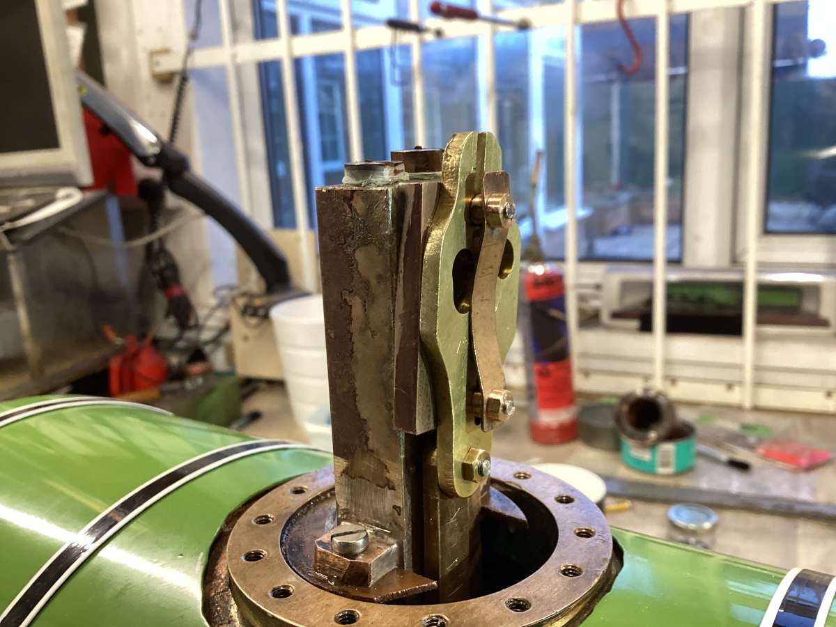

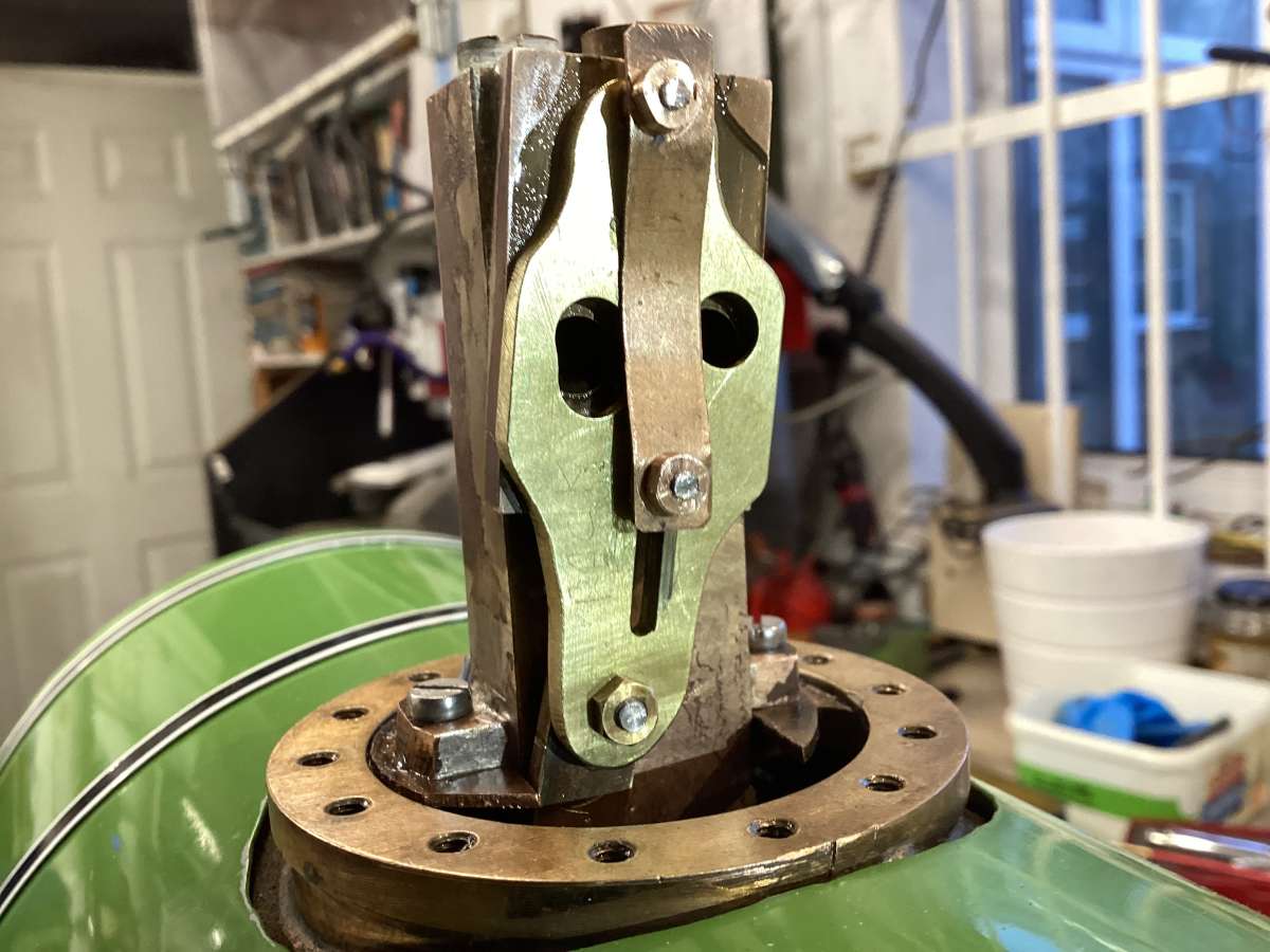

      am on the final assembly of my 71/4 Beattie well tank 2 4 0 no.314, as reboilered   in 1892
      Before  putting the boiler into the chassis I thought it prudent to test that all the fittings held pressure, glad I did as several problems materialised, all solved except for the regulator.   This is mounted in a tall dome, and it’s a real pain to get it off the boiler, some 34 fixings along with bushes, glands and gaskets etc.   it takes quite a while to get it fitted and everything  in correct orientation.  I know this  because I’ve had it out several times already.
      The trouble is, the thing just won’t seal.  I thought I’d got it today, after careful lapping with Timsaver abrasive. This is a brilliant product  because it breaks down in use and becomes inert so the risks from not fully removing it doesn’t exist.   The sliding valve felt very smooth and totally free from any indication of  grit or problems.  It pumped up to 50 psi, then I got very wet from the discharge from the superheaters.  The air went very blue!
      I’m now at a total loss of what to do short of making another regulator to a different design  or trying to modify this one .  The body  and spring are from bronze  with a brass slider.
      Any suggestions, or perhaps some idea of a suitable alternative design which could be modified to fit?
      IMG_1392IMG_1391IMG_1386

        It’s an unusual design, perhaps based on the full-size.
        Full-size regulators commonly were slide-valves but usually rectangular. The unequal size ports ease opening the valve and give some sensitivity.
        Can you scan its drawings and post them here? That might reveal some inherent design weakness making it very difficult to make the sliding part seat properly.
        I wonder if the action of the link may push the lower end of the slide outwards, or twist, it a fraction possibly not even visible by eye, but enough to leak. Especially if the various pins are nice neat bearing fits!
        You could assess any such unwanted movement with a DTI: lubricate the faces first with soapy water so as not to score them.

            If you’re absolutely sure that both faces are absolutely flat (don’t lap them against each other, they should both be lapped independently against a really flat surface – I use a mirror glass) then there are really only three other options:
            1. The faces are being ever-so-slightly separated by the operating linkages.
            2. There is some dirt or swarf trapped between the two faces.
            3. The leak is coming from somewhere else: perhaps a porous regulator casting, or a leak in one of its soldered joints,  or a leaking joint in the steampipe, either at the regulator or smokebox end.
            I had to fix all of these before I finally got my own Stroudley regulator to seal properly.

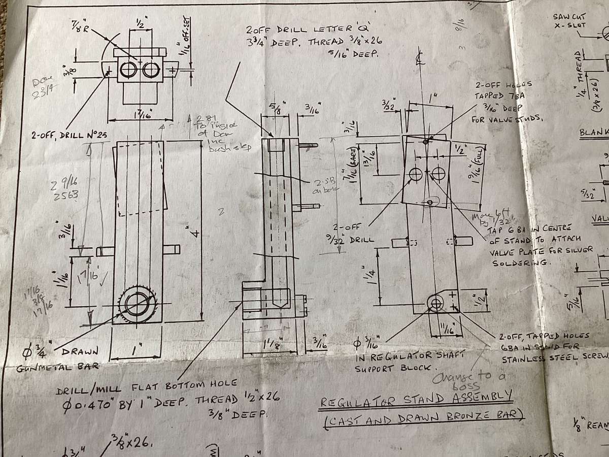

                  No, there’s so much work gone into it that we don’t want to replace the whole regulator if we can cure the problem!
                  Stephen –
                  Aha!

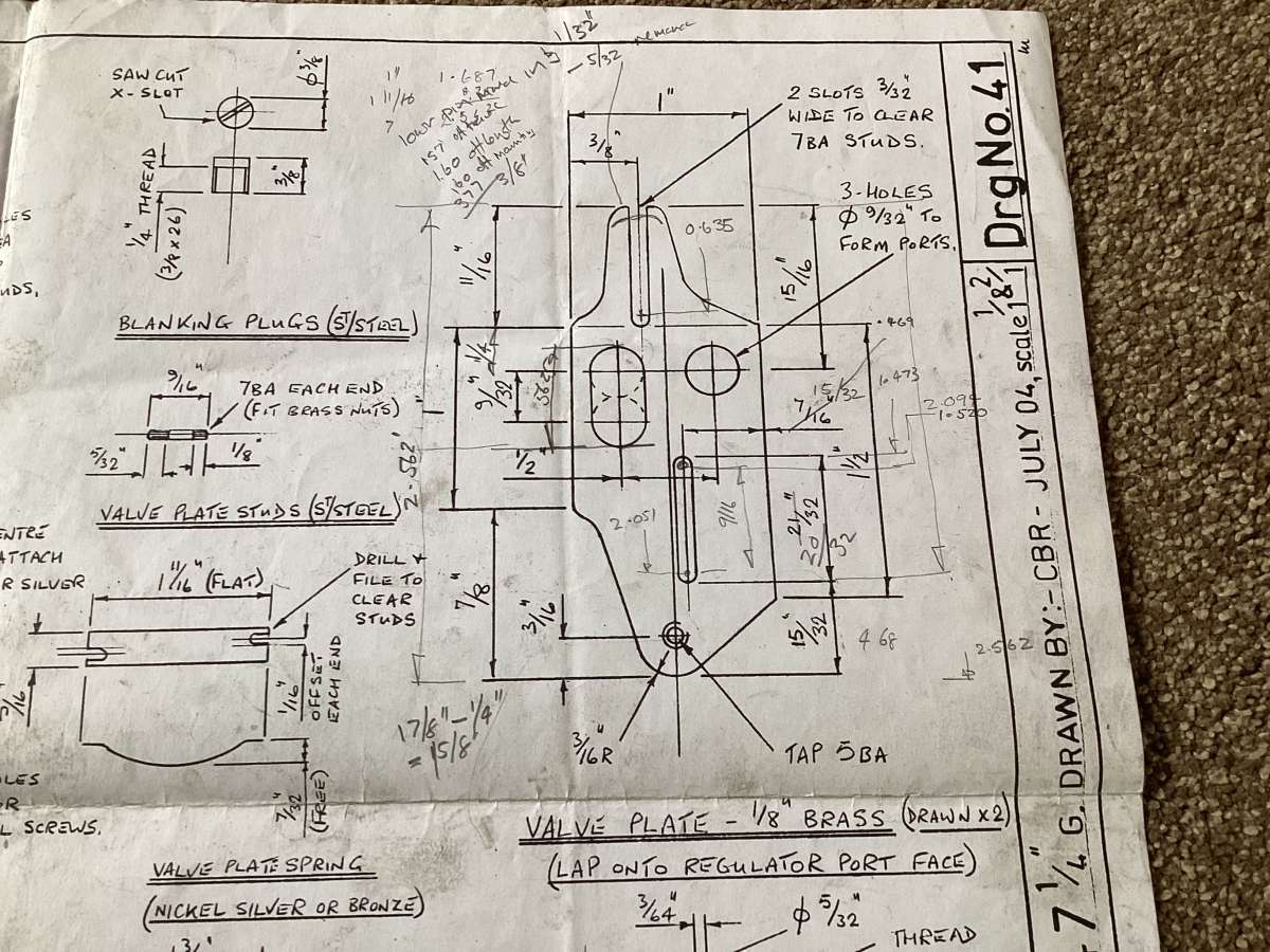

                  You could be on the case there, now Zan’s shown us the drawing.
                  It recommends lapping the Valve Plate and Port Face to each other.
                  That is a recipe for introducing tiny concave / convex faces that separate the components when operated. Especially given the Valve Plate is an odd shape and a lot bigger than the Port Face, making it difficult to lap them together to sufficient accuracy.
                  {Ghastly dimensioning “system” that CBR used for this odd-shaped part!}
                  Zan –
                  Try as Stephen suggests: lapping the two parts on a third, flat surface.
                  I’d test them first by blueing the surfaces then rubbing them on the lapping-plate to see if that shows anything. Use marking-out fluid or felt-tip pen.
                  [The old, or original, way to make surface-plates and similar was to scrape or lap three at a time to each other in rotation: Plate A to Plate B, B to C, A to C.  Using just two risks a concave / convex match.]
                  Regarding the regulator not closing on the run, if that happens pull the reverser straight into mid-gear and apply the brakes. Not the opposite gear except in emergency, as that can damage the locomotive.
                  I had to do that on our club’s loco on its first ever event – for a somewhat similar fault though its regulator is the rotating disc type. I forget what we eventually diagnosed, but I think it was slight un-flatness. We didn’t need replace anything, just improve what was there.

                      Make sure the pivot and slot have plenty of play.  If either are a bit tight they can tilt the puck and hance the leak.
                      Alternatively, inspect all the non moving joints from regulator body onwards in case you are barking up the wrong tree.

                                You have a seal at 50psi and you say it leaks at a higher pressure, just a thought have any of those pivot studs / stud broken through into the steam port and causing a weep into the port at the higher pressure.
                                MichaelR
                                #839844
                                Zan
                                  @zan

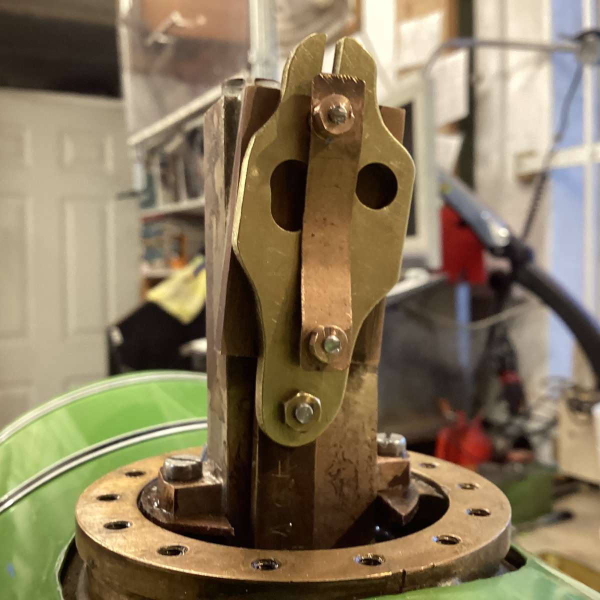

                                  Hi guys been trying to find a solution and not been online , thanks for  all the advice but:-
                                  Dave I had eventually found the posts  on the other website and  tried the top hat PTFE bushes thinking this as you say would solve any lack of a poor mating fit mating fit between the body and the valve.   I was very careful with the finish on the working face.
                                  no different yet again which was a real surprise, I tried a thicker rim and larger diameter with a good clearance into the valve holes for a second attempt, failed again.
                                  checked the connection to the superheaters, no problem
                                  lapping done on a glass plate and on a precision ground flat. No difference used  engineers  blue to test fits but I didn’t use the fitting of three  item method as in producing surface plates ( in one session )
                                  eased all the pins to check for binding  pivot studs bottom in the holes
                                  Never really had a true seal , once the drops of water starts with any rapidity at about 50 psi it then drops slowly continuing to drip

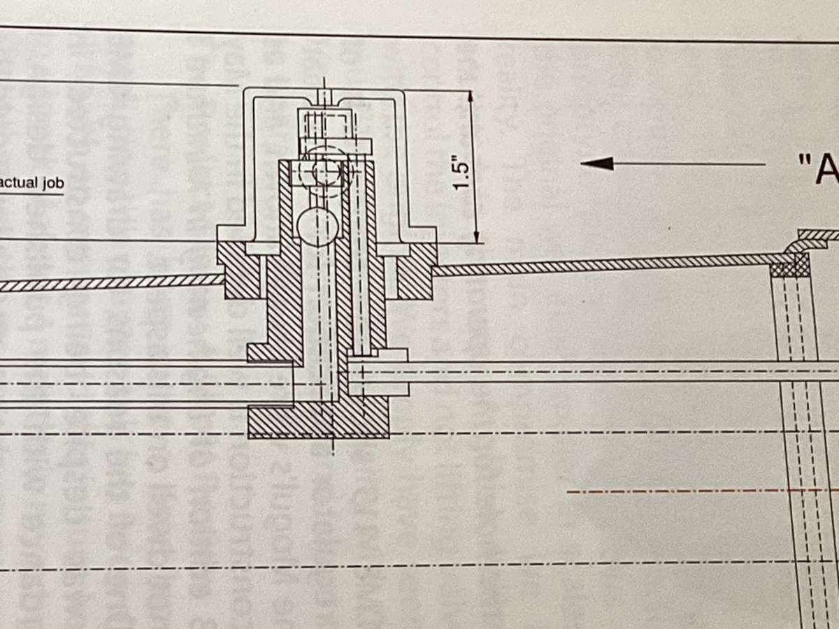

                                  iv just made a wood model of a new regulator based on Gordon Smith’s design to ensure it would go in it’s very tight. I have  done most of the cad work, but got to modify again as the 4.1mm and over 3” deep  hole for the push rod would be virtually impossible to a keep straight, the side walls would have to be only 1/16” wide,  but it wouldn’t fit it’s the extra width and it won’t fit through the bush. ( see my first photo for the setup)
                                  The rod will now be in guides on the rear face of the regulator  making the body 5/16” less front to back.    I have a suitable bar of lg2 (sae660?) for it, which I got for a song years ago, just checked the current price — couldn’t believe it! Over £50!
                                  The main difficulty with this design is ensuring a good seal with a 1/2” ball, would a PTFE seat seal  pressed in work? PTFE does tend to expand under load and would this seal round its edges?
                                  OH……just thought about the plugs at the top, could they be the problem? As it’s all stripped down yet again,  I’ll  clamp a plate with a neoprene gasket onto the body to seal the ports then hydraulic  test from the outlet boss  that will also check all the silver solder joints which was suggested as a possible fail point made earlier.

                                    The plugs – yes – examine them. One might be leaking down its thread.
                                    Seal it with ‘foliac’ or similar high-temperature coumpound. Not PTFE tape, which can send tiny strands into untoward places.
                                    Once the engine has been steamed that screwed joint might seal itself further.

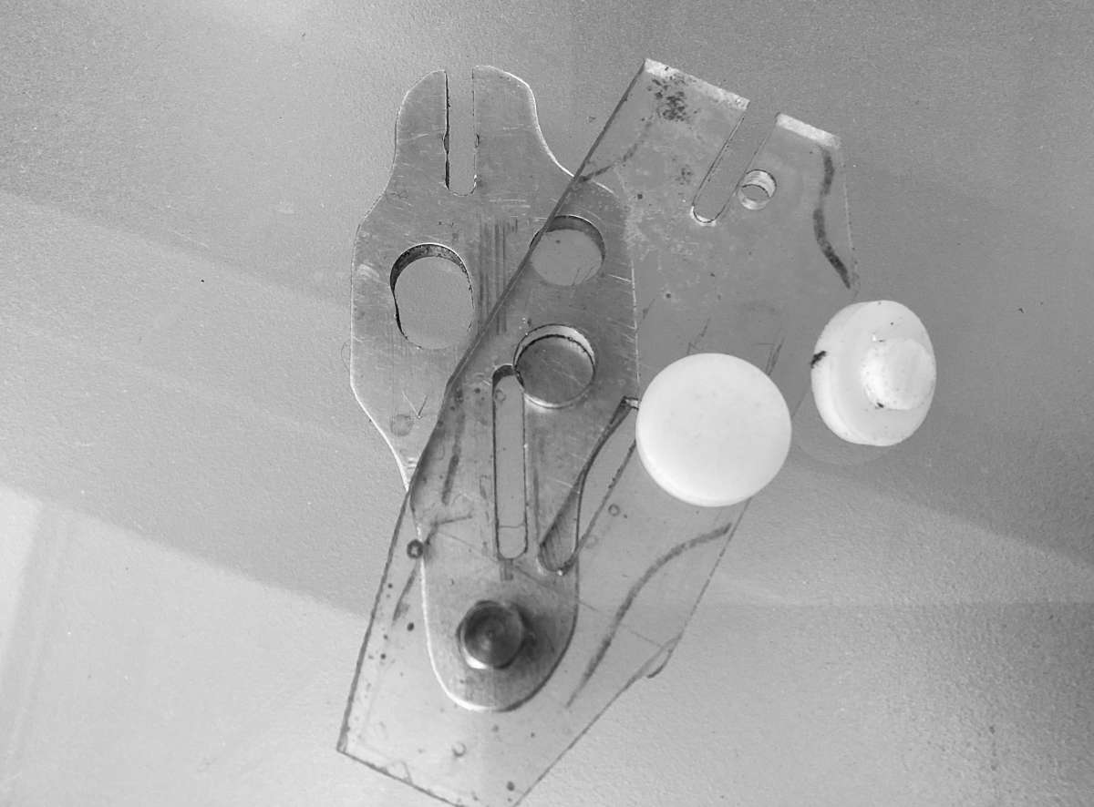

                                      Solved!!!!
                                      it took a long time with several different tests and modifications.
                                      the final solution proved to be the top hat bushes and a new valve plate.
                                      The photo shows an acrylic trial plate to ensure the PTFE bushes would seal the original holes in the regulator body. An initial trial with the bushes in the original valve plate as in the intro photos proved to be no good as the regulator lever was closed where it was open, and thus removed access to valves on the boiler manifold.
                                      as it was there was only just enough room to get things in place, seal the delivery holes and allow a steady opening.  Even now the holes are not fully uncovered.
                                      i had a good look at Gordon Smith’s design with the poppet valve, and drew it up in Fusion 3d.  The trouble was it only allowed a very small opening round the ball and not a lot of lift. The net result was a fully open setting having only 8 to 10% of the original design
                                      guys
                                      All in all its a great relief and final assembly of the loco  to completion SHOULD BE relatively easy…..
