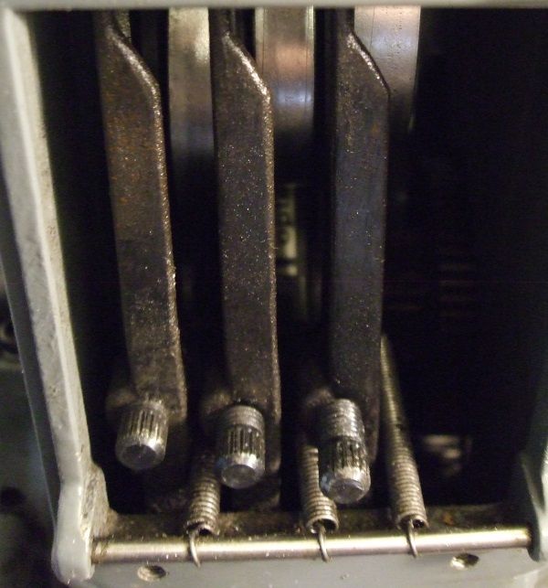

      I have successfully (I think) inserted a set of new belts on my Myford Tri Leva lathe. It looks like I need to adjust the individual belst and the what I think is the adjusters have an unfamiliar head:
      What tool do I need?

          I have owned my Tri Leva for many years and have never seen a special tool for these although somebody else may know better.
          My adjusters rotate using simple finger pressure after the roller arm has been pushed inward to release the slotted end of the adjusting screw from engagement with it, the slot must be returned to vertical alignment again after any adjustment and check it is properly engaged. I find this operation a bit tricky to do and difficult to explain so hope it makes some sense.
          A manual helps greatly do you have one?
          Your screws look a bit chewed up so maybe somebody tried turning them with pliers or something without disengaging the slotted end.
          Here are photos of the screw and slotted end, hope that it helps explain things.11c91a29-aeef-4533-a96f-817c74f212c9.jpeg

            Posted by John Greenwood 2 on 09/04/2019 18:00:08:
            Also the head stock is very stiff. The white metal bearings were a bit scored
            Hello John. V8Eng and I were discussing Tri Leva maintenance the other week.
            1. I was adjusting those thumb screws over the weekend. Those thumbscrews have a slot milled in the end that cup the pulley blades (see V8Eng pictures above).
            2. You thus need to push the pulley blade from the front of the unit, since a spring holds the blade within the slot when that lever is in the up position.
            3. Whilst the blade is held back (under spring tension), simply twist the knurled head to get the require pulley-on-belt tension once that lever is depressed.
            Hence do NOT attempt adjusting the thumbscrews till the blade is away from the slot – you will simply bugger up the thread as V8 has alluded to!
            Ask again here if I can help any more – the chaps on this forum have been very helpful to me over the years nerd

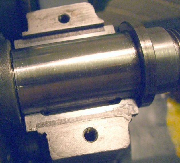

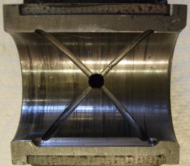

                            I had concluded that the the main bearing was much too stiff and needed to be sorted before adjusting the belts.
                            I removed the top shell of the front bearing and gave the exposed sufaces a very fim wipe wth kitchen wipe and three-in-one oil
                            upper bearing
                            Shaft bearing
                            I then reassembled the top shell with the bolts tighten but not hard. I find that I can turn the shaft with my fingers or with any of the three belts.
                            I propose to tighten the bolts hard and see if the it gets stiffer.
                            Should I expect to need to "run it in"?

                                Following on from my last post, I ressembled the tri-lever meshanism and with a bit of adjustment was able to run the machine on all three speeds. I tightened the shell screws as tight as I could, and there was no discernable increase in stiffness in the bearing.
                                I reassembled all the rest of the parts and ran the lathe and tested the levers. There were some squeaky sounds and a few times the fastest speed belt became disengaged.
                                I made some quite small adjustment to the alignment of the belt pulleys and now it seems to back to the status quo (anti bellum).
                                Now I can get back to the job I was doing!
                                Thanks to all of you that have contributed to this thread.
