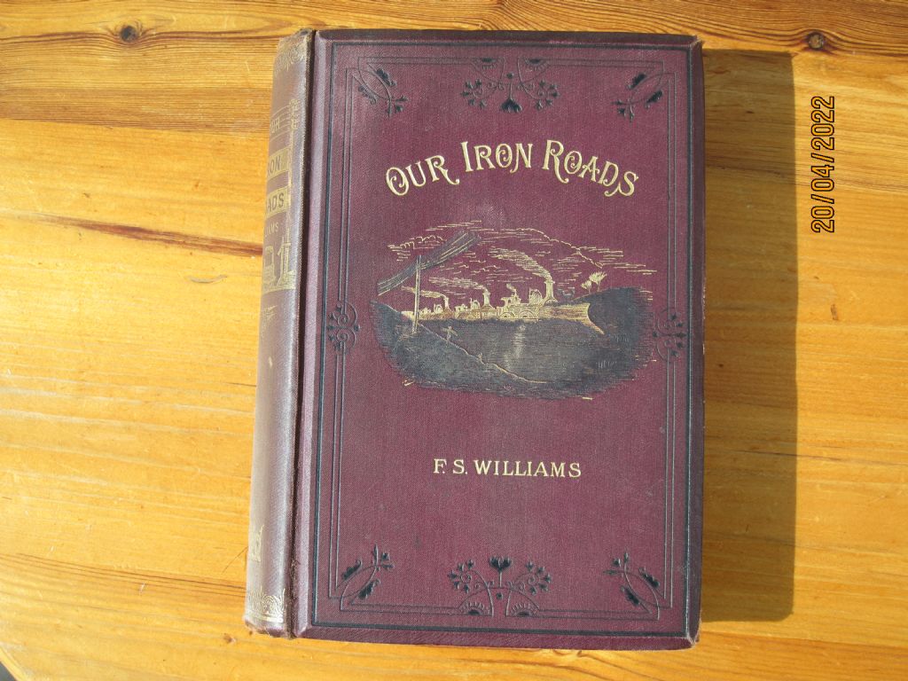

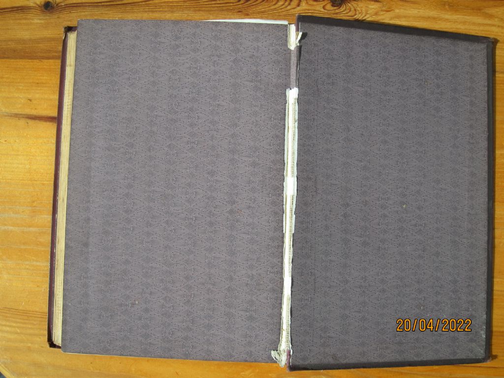

                The book in question is a section sewn and is over 100 years old although of no particular value.

                    That's a nice example of period decorative case work, and the outer joints and textblock sewing appear sound.
                    I would carefully slit the mull and tapes at the inner joints, remove the textblock from the case, use starch paste to soak off the original spine linings, reinforce the sewing if necessary, re-line the spine adding a calico hinge on both sides, lift the paste-downs for a couple of inches and insert the textblock back into the case, pasting or gluing down the new calico hinges underneath the lifted paste-downs to strengthen the inner joints. The original paste-downs can then be re-pasted down over the new hinges and the splitting of the endleaves at the inner joints disguised with carefully toned Japanese tissue.
                    The binding will then be sound, and as much of the original as possible will have been preserved.

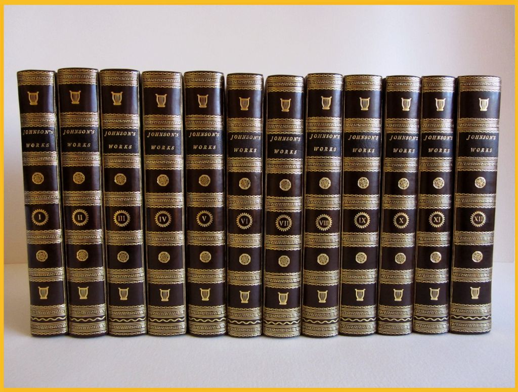

                          Below are before and after shots of an early nineteenth century edition of Samuel Johnson's works I did a few years back. The books are in hand-stained calf and tooled in 24 carat gold leaf.

                            Very nice and much more in the appearance they would have had when first bound.

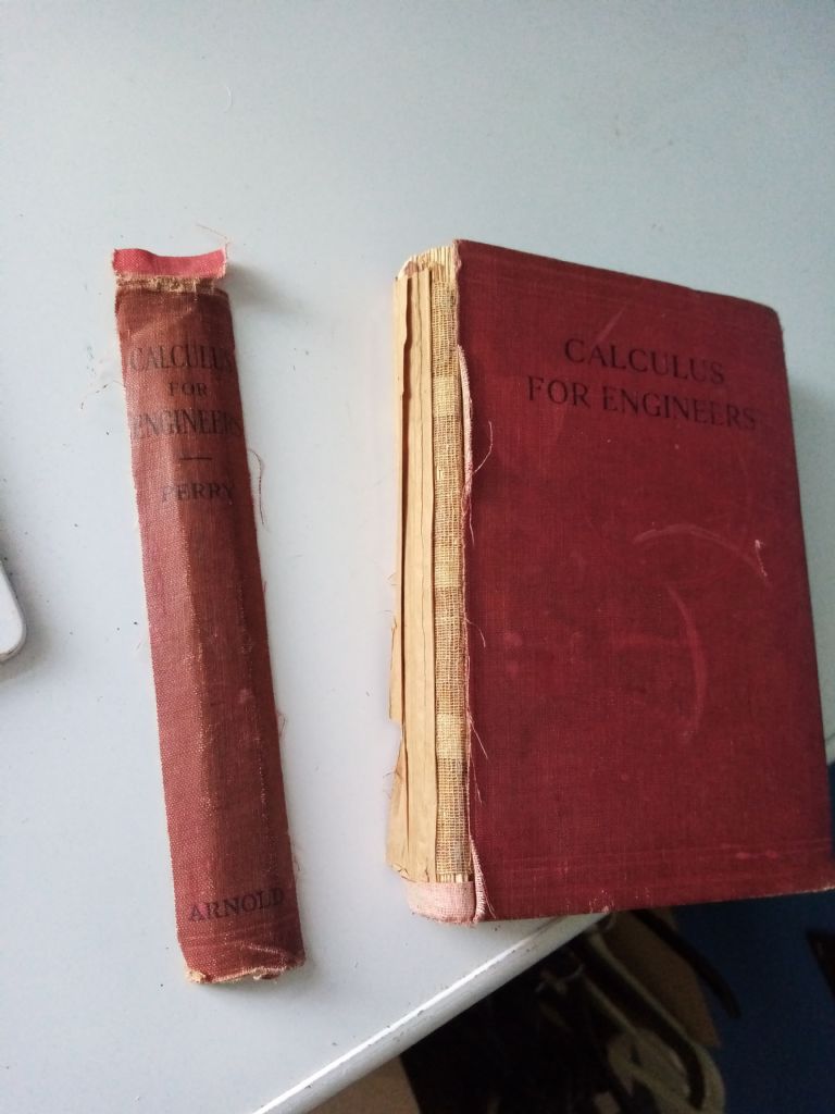

                              So as we've got into book binding, how do I repair this
                              It's not of any great value, just sentimental as it was given to me by a friend (now deceased), I don't mind if it looks repaired, but it might as well be reversible in case whoever I pass it on to wants to do it properly. I don't want to have to buy vast quantities of materials, this is very much a one off. Book binding is far too skilful for me.

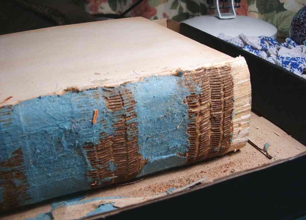

                                Posted by Peter Low 4 on 21/04/2022 08:25:06:I have had to work on books that had each section held together with rusted staples.
                                Me too. See the one pictured, which consisted of two large folio volumes both in an equally horrendous state, even though the rusting wasn't too advanced. The machine that did the stapling was called a Brehmer wire stapler, I believe. I was tempted to buy one when it came up for sale recently on eBay just so that I could destroy it and have my revenge.
                                Duncan, the task you're faced with there is a cloth re-back. Have a look at Angela Sutton's video of the process. The image quality on the video isn't good but Angela is a Society of Bookbinders member and won't teach bad habits.
