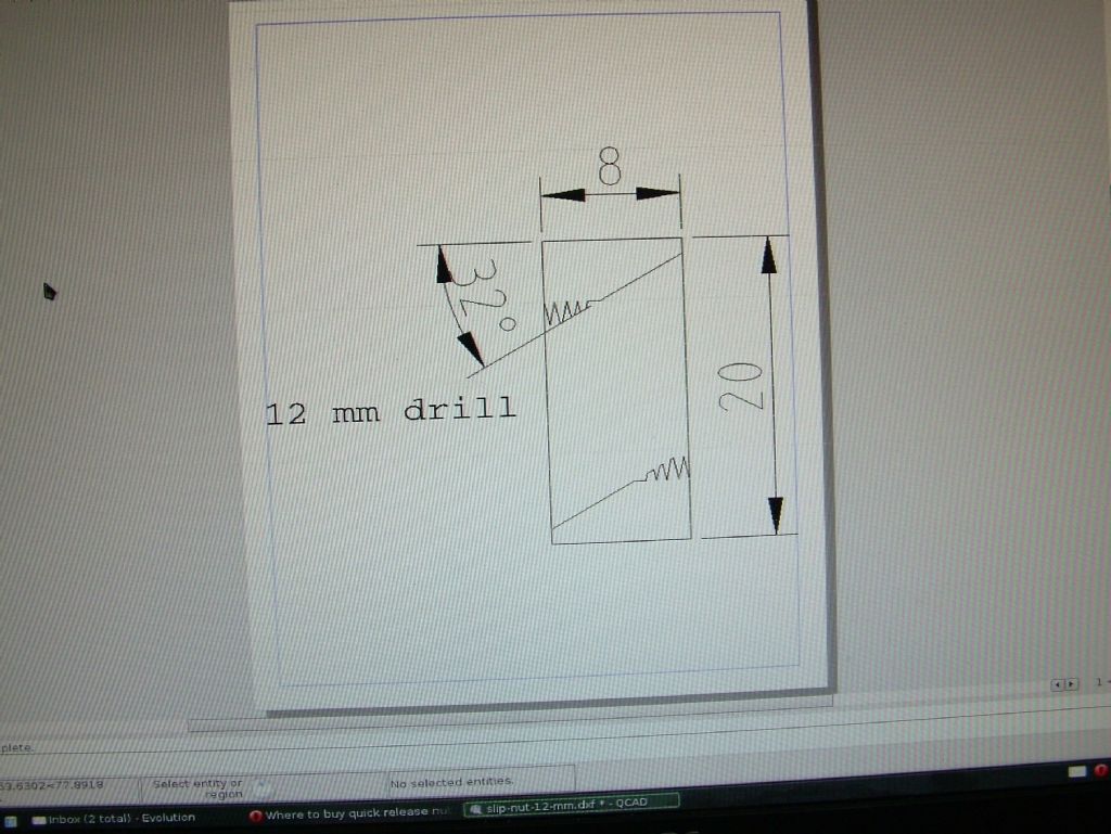

                        Hi Added this sketch of 12 mm Slip Nuts we fabricated and used to quickly remove machine guards

                          Brian G:
                          Thanks for the video link but I couldn't get the drawing, etc link to work.

                            Does anyone have a feel for how the maximum grip of such slip nuts compares to a normal full nut?
                            It seems that the maximum tightening torque will be less than that of a full nut. But how much less? Wild guess says about half that of a full nut torque would be prudent assuming similar lengths of full thread with the stud decently perpendicular to a flat surface for the nut to screw onto.
                            Thinking of using as an alternative to very hard to start nuts but that would only be OK if they can be done up tight.

                                    I realise the eye-nut in the first photo is purely a neat version of a wing-nut for the clamp, but I would wary of so modifying an item of lifting tackle lest it find an opportunity to re-live being lifting tackle.
                                    That is one area where you need maximum thread and no risk of an angular pull detaching the fastening.
                                    On which note if the pull is at all angular to the axis of the thread, the eye-bolt or eye-nut should be the collared and screwed down to full contact, with a washer if necessary.

                                      The (unmodified) eye-bolt was replaced by the knurled quick nut.
