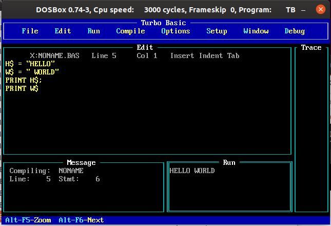

                                  The semi-colon syntax works for me. This is TurboBASIC 1.0 downloaded from AbandonWare and running on Ubuntu 19.10 under DOSBOX
                                  Note HELLO WORLD on one line in the Run box, bottom right. The semi-colon stopped PRINT H$; from throwing a newline as would PRINT H$
