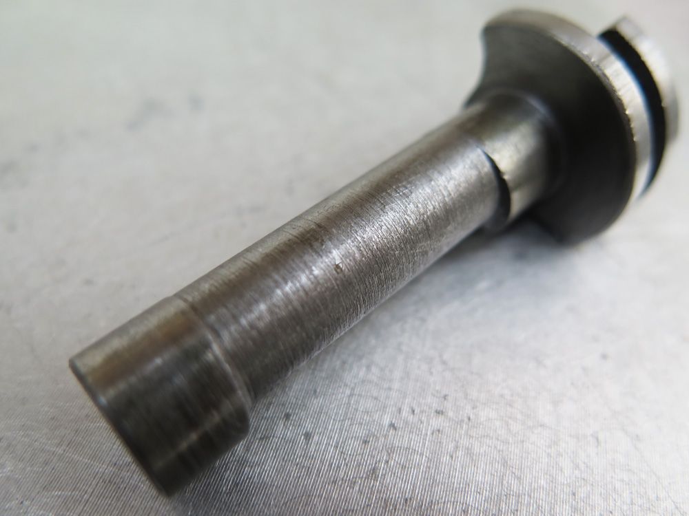

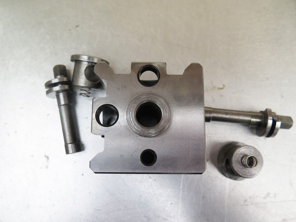

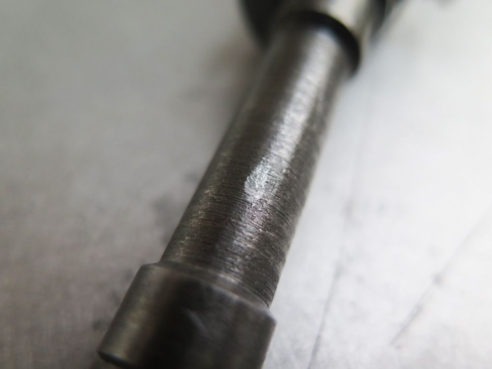

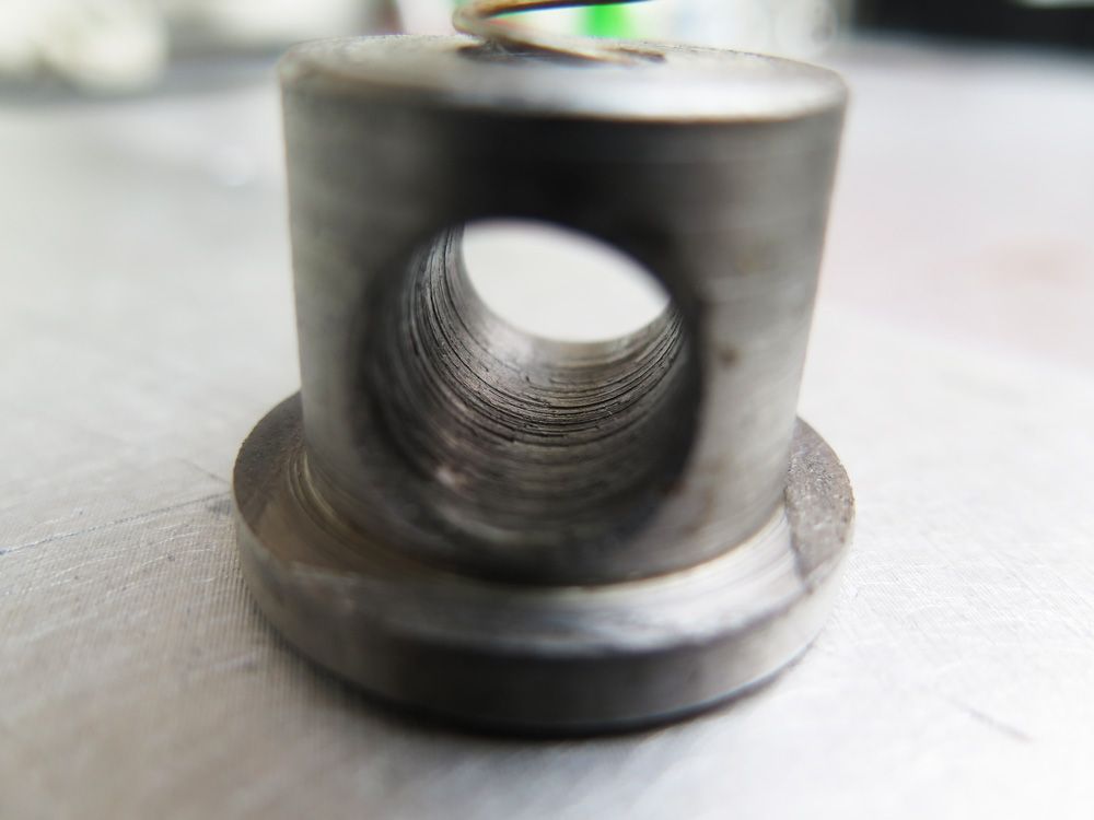

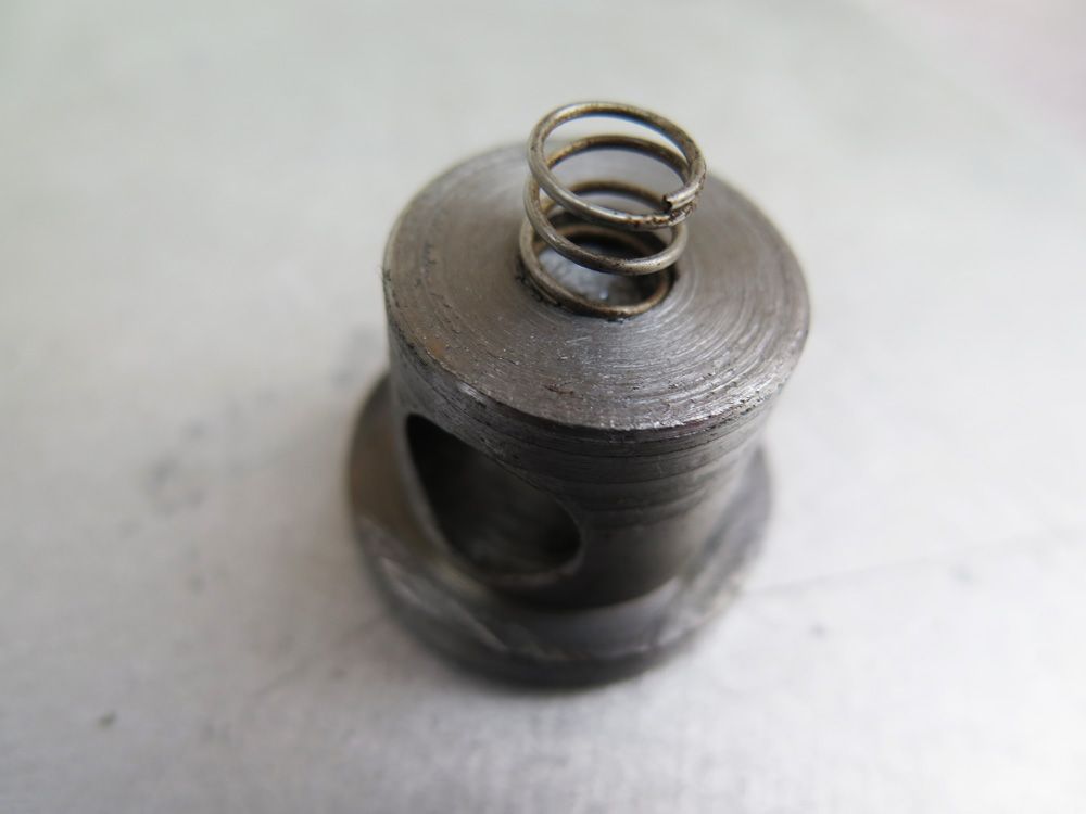

                    Posted by Nick_G on 29/02/2016 10:19:32:
                    If I get chance later I will take a few photos and post them here.
                    Nick
                    Here we go.
                    On this next image you can see the small area that was making contact by the mark left upon it. The material is also quite soft so I presume some flexing will also take place.
                    Inner bore.
                    So we have a badly finished and poor material cam shaft and a horrible bore for mate against. – It really was never going to end well was it.? sad
                    Nick

                      Sounds like the answer is to buy – check as per photo's and if no good send it back. The bit that pulls back the holder should be square not round.

                          I think the surface finish on some of those bits nearly qualify as a rasp or a plowed field kind of territory.
                          ps. having taken a closer look, i think i actually own this model! I dont think i noticed anything wrong with mine(no part off jumping atleast), but atleast i now know what i can blame my poor surface finish on steel on!

                              Posted by Nick_G on 29/02/2016 11:13:01:
                              Here we go.
                              Nick
                              That really is rather nasty, Nick
