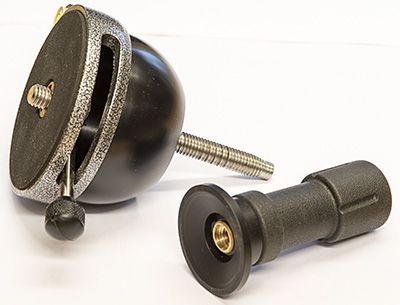

      New to the Forum and to proper engineering. I need some advice please.
      I do a bit of photography and have a tripod head I want to modify. The head has a clamping handle with a female thread which screws onto a fixed stud. I want to make another handle so need to make a new female part to fit the existing stud.
      I think the thread is metric M10x1.5. I have a set of metric taps and dyes and the 1.5 thread checker fits the male stud perfectly. A piece of M10 all-thread fits the stud like a glove. Angle, pitch and thread depth all match. The major diameter of the stud and the all-thread are both 9.7mm.
      But…an M10 nut that fits the all-thread won't fit the stud and the all-thread won't fit the female thread in the handle. It's not that they are a poor fit, they won't even start. I have wiggled and wangled to no avail. I am stuck. Any ideas on what is happening and what I should do next?
      Many thanks.

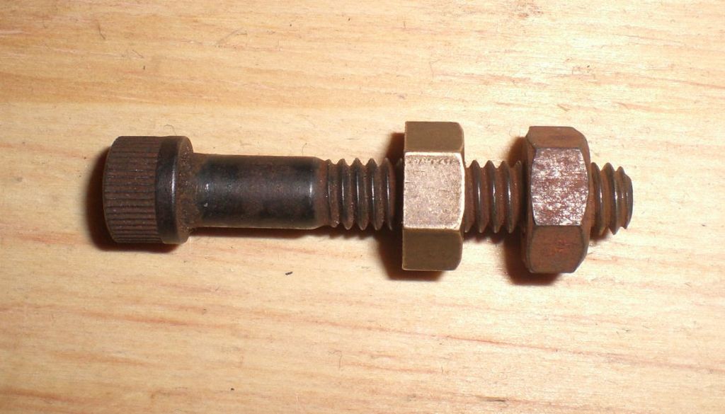

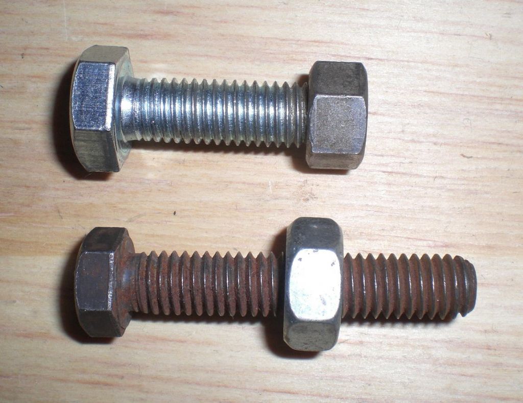

                                            Hi, while all the Whitworth and UNC threads from 1/4" to 2" with the exception of 1/2" have the same TPI and allthough not ideal in highly stressed parts the standard nuts are, in my experence, mostly interchangeable. I've known fitters who have mistaken both 3/8" Whitworth and UNC threaded rod as M10 because they find a M10 nut screws onto them easily, and the same goes for 3/4" Whitworth and UNC and M20 nuts, but when I've pointed out to them how sloppy a fit they are and then comparing the proper nuts that do fit, which will not screw on a know M10/20 thread, they soon realise thier mistake. The standard length of Metric threaded rod is always I Meter length, whereas the standard length of Whitworth and UNC is 3Ft.
                                            Below is a photo of an M10 bolt with an attempt to screw on a 3/8" UNC nut and a 3/8" UNC bolt with an M10 nut screwed on happily.
                                            The photo below shows a 1/4 UNC socket head bolt with a 1/4" Whitworth brass and steel nut happily screwed on.
                                            Regards Nick.
                                            Edited By Nicholas Farr on 30/12/2013 13:40:47

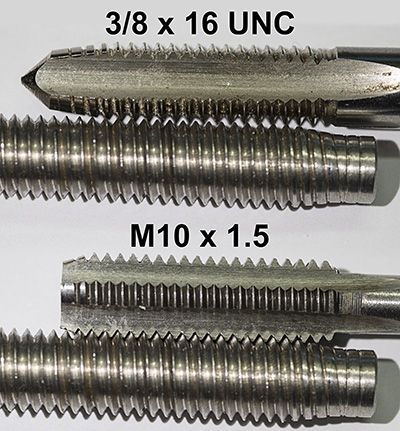

                                                Mmm……….. This doesn't seem to be working.
                                                I have now got the taps and dies. I have made 3/8×16 UNC and BSW females and neither of them fit. So am scratching my head again. I rechecked the dimensions and it still looks like the M10x1.5 is closest. So I made a nut with my M10x1.5 tap in an oversize 9mm pilot hole and even that wouldn't fit.
                                                I have emailed Gitzo and asked them what thread they put on the tripod head.
                                                Have also made some photos to show the thread and the handle I want to replace and how the Metric and UNC taps mesh with the male thread. The mesh with the BSW is no better than the UNC. I must be missing something.
                                                My thanks for the additional information from Harry and others. I will let you know how things progress.

                                                    Dave,
                                                    That's certainly nearer to M10 x 1.5 … although it still doesn't look quite right.
                                                    It may be an illusion, but it appears that the contact area changes from one flank to the other; which suggests that the thread pitches are slightly different.
                                                    We'll have to keep guessing, until Gitzo replies.

                                                    #139667
                                                      Posted by Ian Parkin on 04/01/2014 17:32:48:
                                                      It,s not something like a 2 start thread?
                                                      making adjustment quicker?
                                                      pitches will line up but a standard single start nut wont go on
                                                      Ian,
                                                      I think you are probably right !!
                                                      The helix angles do look very different.
