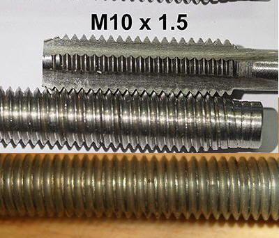

      Hi Dave, looking at your photo, to me it looks strange and as others have said, it may be a double start. While they were posting, I've taken a photo of a M10 threaded rod and have stitched part of your photo just above it and to me the angles of the threads look different. I know it may be due to camara angles and all that, but the two rings around your thread at the very start may suggest a double thread.

        Well done Ian. Brilliant. Just checked and it is a 2-start thread. Something I never considered.
        Can't even begin to think of what that means if I want to make one! Will have to think about it.

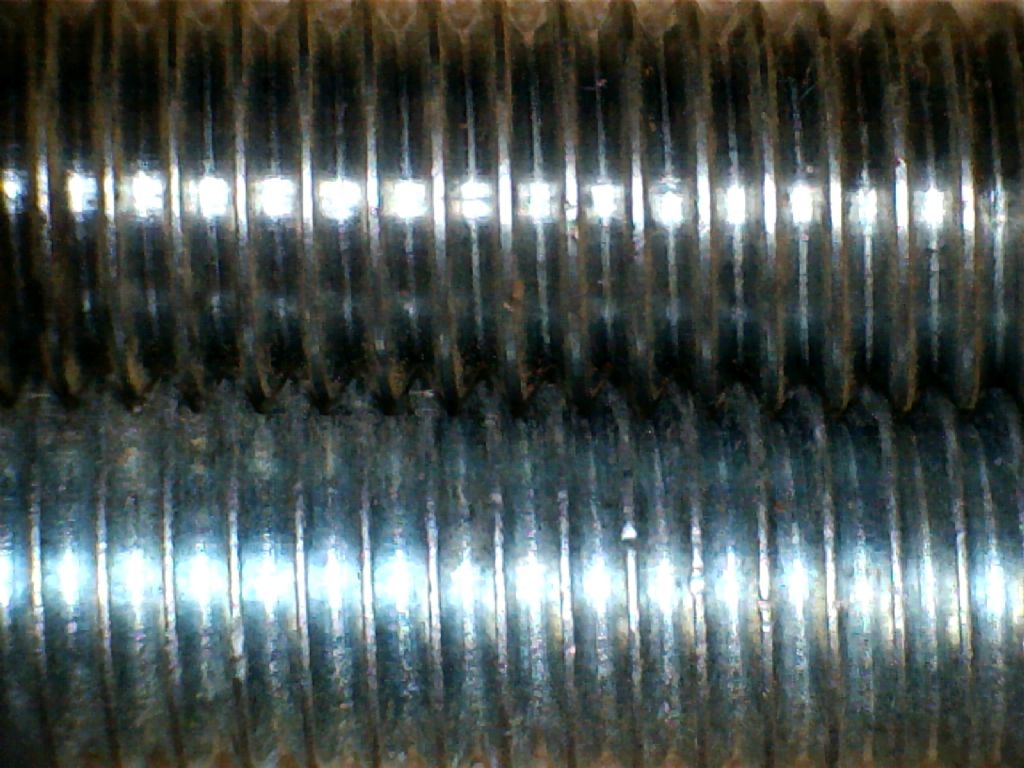

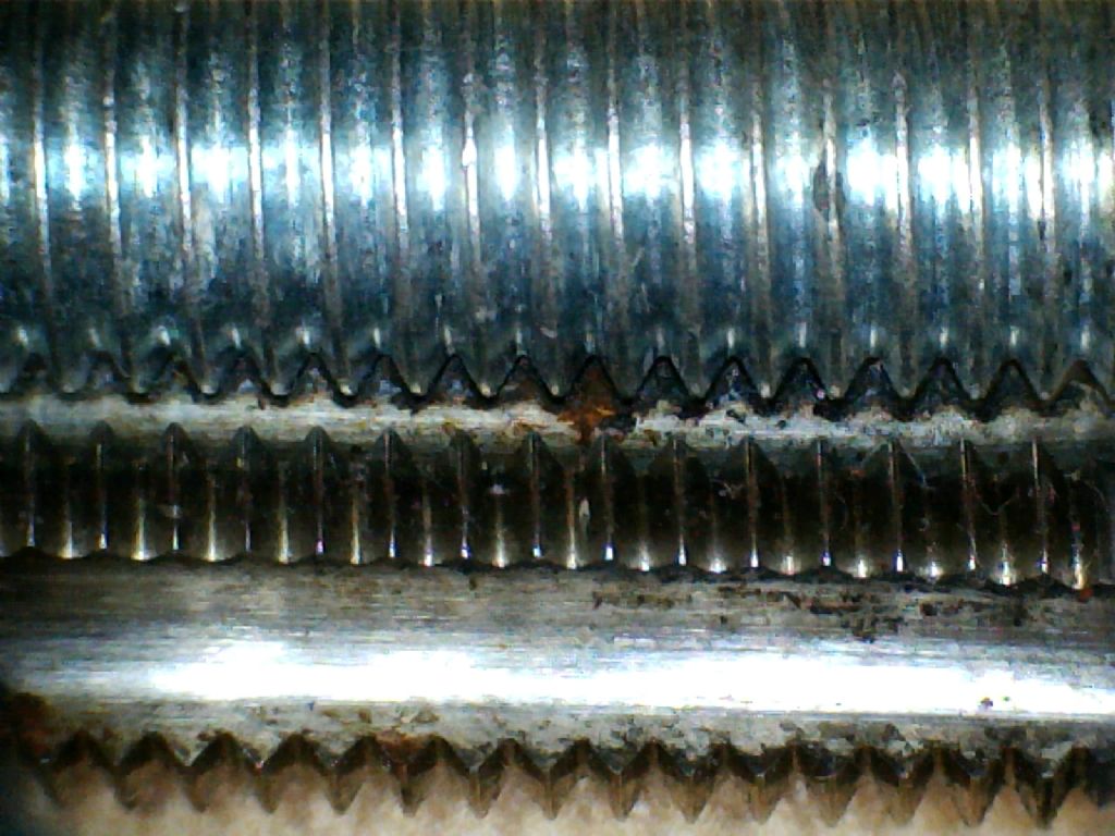

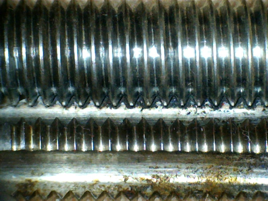

                      Hi MichaelG, I take your piont, however when comparing a tap against a full thread you get a clearer view than when comparing two full threads together.
                      I must have used a mile or two of "all-thread" in my time and have never noticed any significant difference between that and good quality bolts, but then it has always been industrial grade and not the toy town stuff you can buy at rip off prices from DIY stores.
                      Below is a piece of all-thread compared to a bolt, a bolt compared to a Goliath M10 x 1.5 tap and a piece of all thread copared to the Goliath tap with my USB microsope. I cannot see any significant difference between them.
                      Regards Nick.

                        Thanks, Nick
                        Very helpful photos.
                        At least that confirms that some decent all-thread is available.
