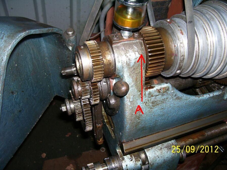

                                          @hth
                                          Hi
                                          This old Colchester has a thrust bearing located on the main spindle somewhere but I cannot find it as yet . I have not dismantled anything and it is difficult to see what's in there . I think the thrust bearing is hidden inside the small gear that drives the back gear ? Any info appreciated . Mike
                                          #204123
                                          Ady1
                                            @ady1
                                            If I was you I would get a proper manual, that's a high end manual machine tool you're messing with
                                            There's bound to be a yahoo type group with the experience and details you need to get going
                                            Edited By Ady1 on 13/09/2015 12:50:23
                                            #204138
                                            John McNamara
                                              @johnmcnamara74883
                                              Hi Mike
                                              The thrust bearing on mine was located between the main bearings against the right side of the left spindle bearing. The thrust bearing itself was a large ball thrust bearing from memory about 20mm thick. the main bearings were bronze bushes. you have to keep them well oiled or they will seize.
                                              To remove any play the thrust bearing is tightened against the spindle by a large threaded ring at the left hand end of the spindle that also retained the drive train gear and a collar. you will need a pin spanner. you should find the bearing under the small cover to the left as seen in your photo.
                                              The back gear on mine was under the spindle within the headstock.
                                              It was made from cast Iron as was the bull gear. The gears were badly damaged when I got the lathe. I had to repair teeth on the large back gear and replace the small pinion altogether. I also had to make up a new bull gear from one scrounged from a dealer not easy to find. It was a big job.
                                              If yours are intact without missing teeth you are lucky. Clearly they do not like to be overloaded.
                                              You will probably find there is only a single half nut that engages the leadscrew for screw cutting this is moved down onto the leadscrew by a lever. It too is cast Iron, it is guided by a 3/4 inch (from memory) cast iron spigot. I managed to break that one day while cutting a heavy thread. The fix for that was to bore a slightly smaller hole in the nut body and Loctite in a stepped 3/4 inch mild steel pin to replace the cast iron pin… I still have the pin! saw it the other day in a box….
                                              For Colchester not a good design. It was bound to break one day. Mild steel is better.
                                              The gears on the back of the apron are open. there is no sealed gearbox I would dismantle the apron and clear out the detritus that has accumulated there before greasing everything and reassembling.
                                              One nice feature of the lathe is how easy it is to adjust the headstock alignment. Just loosen (firm not too loose) the 4 bolts that clamp it down (Look up under the headstock between the ways) You can then adjust the spindle axis until it is perfectly parallel to the bed via small jack screws under each end of the headstock.

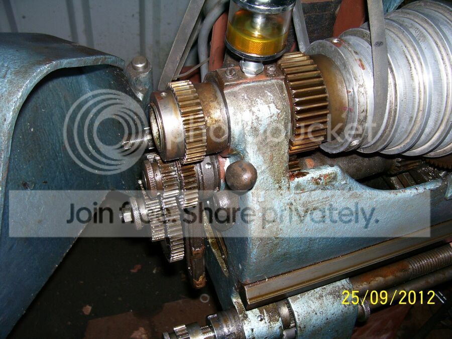

                                              #204206
                                              hth
                                                @hth
                                                Thanks John
                                                That is interesting and very informative .
                                                Another one of these lathes has turned up , a chap up at Wangaratta has one .
                                                I took this pic. I removed the cover but I Cannot see any thrust bearing ????
                                                Mike
                                                Edited By hth on 14/09/2015 12:27:57
                                                Edited By hth on 14/09/2015 12:37:30
                                                #204234
                                                Ady1
                                                  @ady1
                                                  Not unusual for it to be out of sight
                                                  The "usual position" would be for it to be just rearward of the small cog at the end of the pulleys, nestling inside the rear headstock bearing carrier on the right hand side, so it could take the pressure of cutting/ between centres work etc
                                                  Around position A
                                                  Edited By Ady1 on 14/09/2015 13:41:46

                                                  John McNamara
                                                    @johnmcnamara74883
                                                    Hi Mike
                                                    There are a couple of subtle differences between the headstock on your lathe and the model I had.
                                                    On mine the thrust bearing was visible when you removed the cover. I notice the leaver for tumbler reverse? (or is it to engage the back gear) the setup is different to mine.
                                                    It would be interesting to see a photo of the one that has turned up in Wang.
