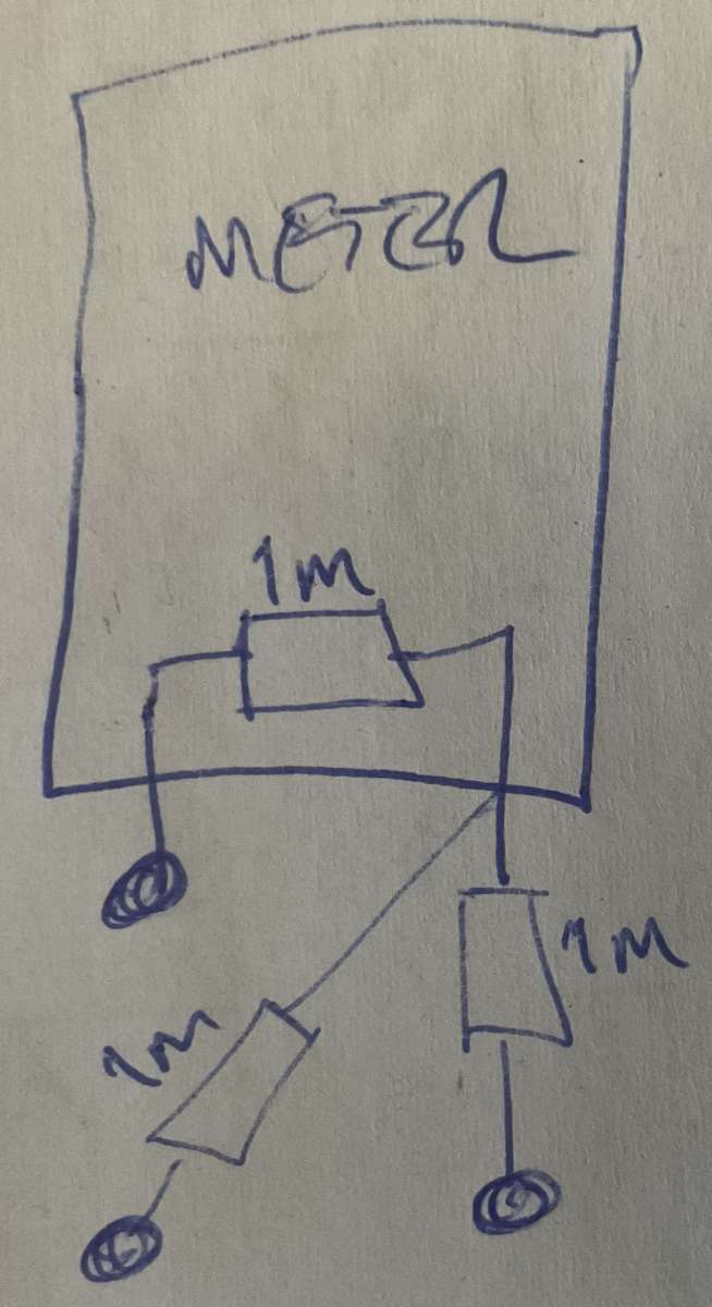

                          Hi Andrew,
                          The 3 phase adaptor is just two 1 Megohm resistors that create a star arrangement with the meter imput resistance, also 1M, to create an virtual neutral. You only need it if you don’t have access to a neutral.
                          The scope output is a bit unusual. It’s a 2mm socket at the base of the 4mm voltage input sockets. I used plugs like this :
                          https://www.rapidonline.com/sks-hirschmann-938420100-mstf-2mm-straight-blade-plug-black-07-1229
                          With heatshrink over it rather than the normal cover.
                          There is a switch in the battery compartment to select RMS or instant output.
                          The manual is here: https://elektrotanya.com/itt_mx220_mx1220_power_clamp_meter_owners_manual.pdf/download.html
                          I’ll sell you a 3ph adaptor if you really want one.
                          Robert.

                              It should be here in a couple of days. I have a few 5% 1 Meg resistors – would this be the arrangement for the three phase adaptor?:
                              IMG_1407
                              #843730
                              Robert Atkinson 2
                                @robertatkinson2
                                Yes, that is the correct configuration. Make sure the resistors are rated for the voltage. I’d use something like this https://uk.farnell.com/yageo/hhv50sft-52-1m/resistor-1m-1-0-5w-1-6kv-axial/dp/4667307

                                          Oh, regarding the voltage rating of the 1 M resistors, they’re 1/2 watt, fairly large ones, so hopefully up to the job. I bought them a while ago, to use in making a Gabriel electrode for a Jacob’s ladder. Two in series have held up against the 8 kV from the neon transformer.
                                          For the three phase measurement, let’s say it goes L1, L2, L3 from left to right in the my diagram above; I assume the current clamp is clipped round L1?
                                                Correct. If you want to check a different phase you should measure voltage (direct connection to meter and current on the same phase. Should not need to bother with a motor and proper 3 phase supply but could be interesting on a static or rotary converter.

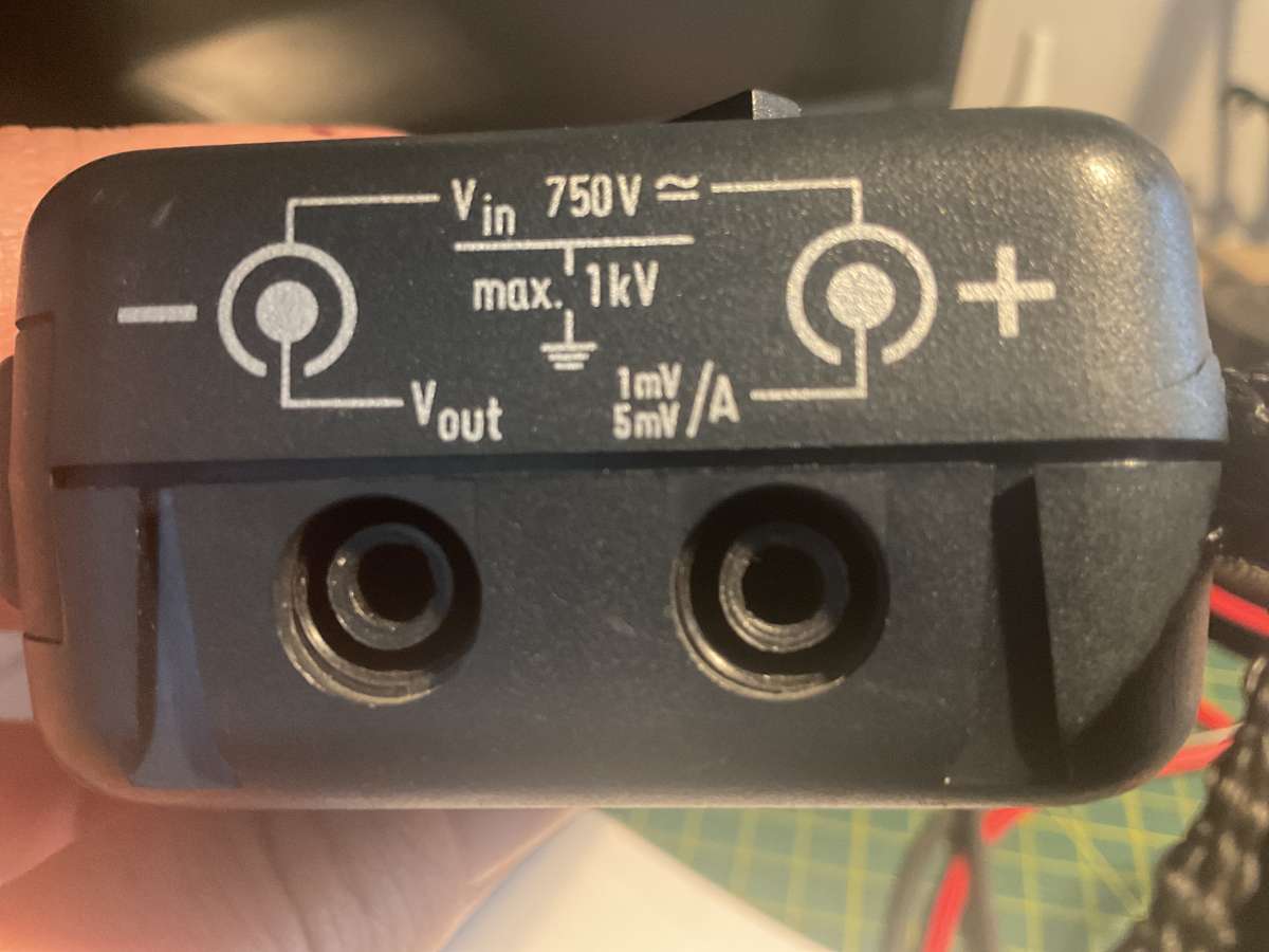

                                                  It’s here. Can I check something?
                                                  The manual says the measured voltage should go in the 4mm banana sockets, but this diagram suggests it should be the outer contact. What I don’t want to do is feed 415V into the scope output.
                                                  #844047
                                                  Robert Atkinson 2
                                                    @robertatkinson2
                                                    A standard 4mm plug is used for the voltage input. Should be a safety shrouded type for mains. The ‘scope output is a 2mm socket at the bottom of the 4mm socket. No way a 4mm will touch it. I assume the scope output isn’t isolated fron the voltage input so this stops you using both at once.
                                                    Don’t forget it works with DC so you can play with batteries or the car without using dangerous voltage. If you put multple turns of wire around the curren jaw the senstivity is multiplied by the number of turns.
                                                    Robert.
