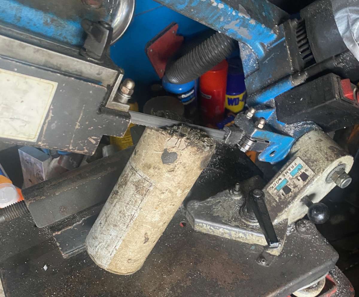

                      I have a small bandsaw, like a Femi and use a wax stick to lubricate the blade. It is in a big stick about 70mm dia and I just run the blade thru the end before cutting metal. The wax is also good for lubricating hand saws for cutting wood. The saw and the stick are about 7 years old and the wax does not cause the band to slip on the rubber drive wheel.
                      I use bi-metal blades on my saw. They cost a little extra but last way longer than standard carbon steel blades.
                      Wax

                          I have also run my bandsaw dry but it cuts better with a little lube, less friction and the blade lasts longer.

                            If it has rubber bands on the wheels, it is likely not a very good idea to get them oily.
                            #828177
                            Paul Lousick
                              @paullousick59116
                              As I have already said, the drive wheels on my bandsaw have rubber rims and they have not slipped in 7 years while using wax lubricant. Oil would be different.
