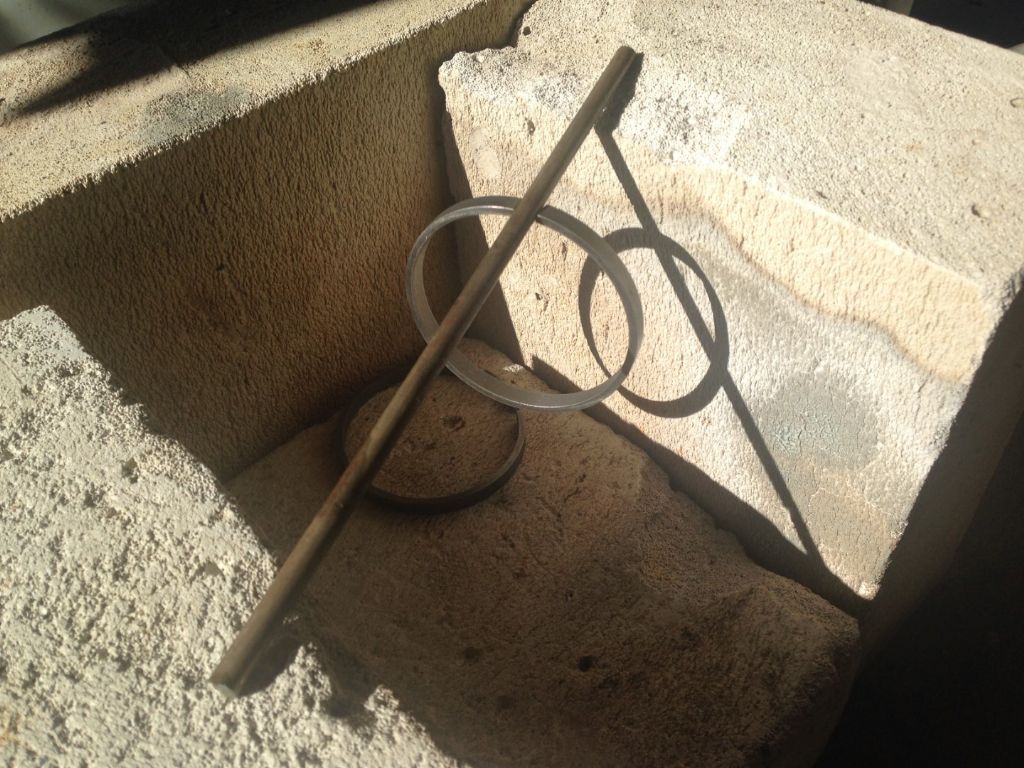

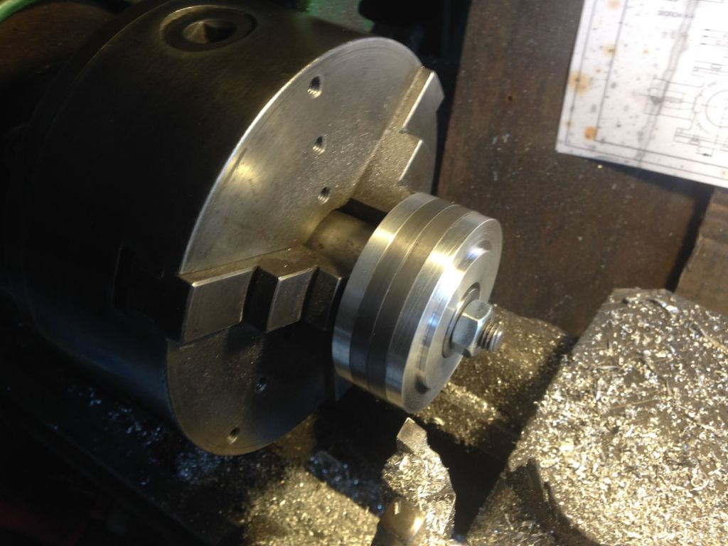

          The bore on my traction engine is 2 3/4" dia and I made the rings with a clearance fit on the bore using a formula of 0.001" per inch of diameter. (Some builders recommend making them 0.001" oversize on the bore which allows for them to wear down slightly when beding in and be an exact fit). Mine are very wide rings compared to that used in an IC engine and the piston is made in 2 parts so that the ring does not have to be stretched over the piston head.
          The ring was split with a 1mm thick Dremel cutting disc. This does leave a small gap when assembled in the bore but the 2 rings are fitted in the same groove with the gaps spaced 180 degrees apart. The theory being that there is no gap as one ring is sealed by the adjacent ring.
          The spring in the rings was set by holding the gap apart with a piece of 6mm bar and heating the ring all over untill it fell off the bar. The gap in the rings was left expanded to about 3-4mm and a ring compression tool was required to squash the rings for insertion into the bore. It seems to work OK with very little sliding resistance.
