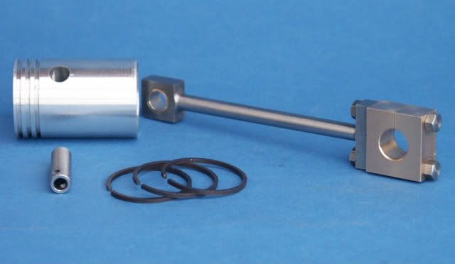

                Yes definately CI. I use the Trimble method of splitting and then heating others prefer to make the ring with a larger diameter and cut a section out.
                Make a couple more than you need just incase of a mishap when fitting
                These and these are some I have made
                It would be hard to get steel to split in the same way you can cast iron and I'm not sure mild steel would hold the spring when heated.
                J

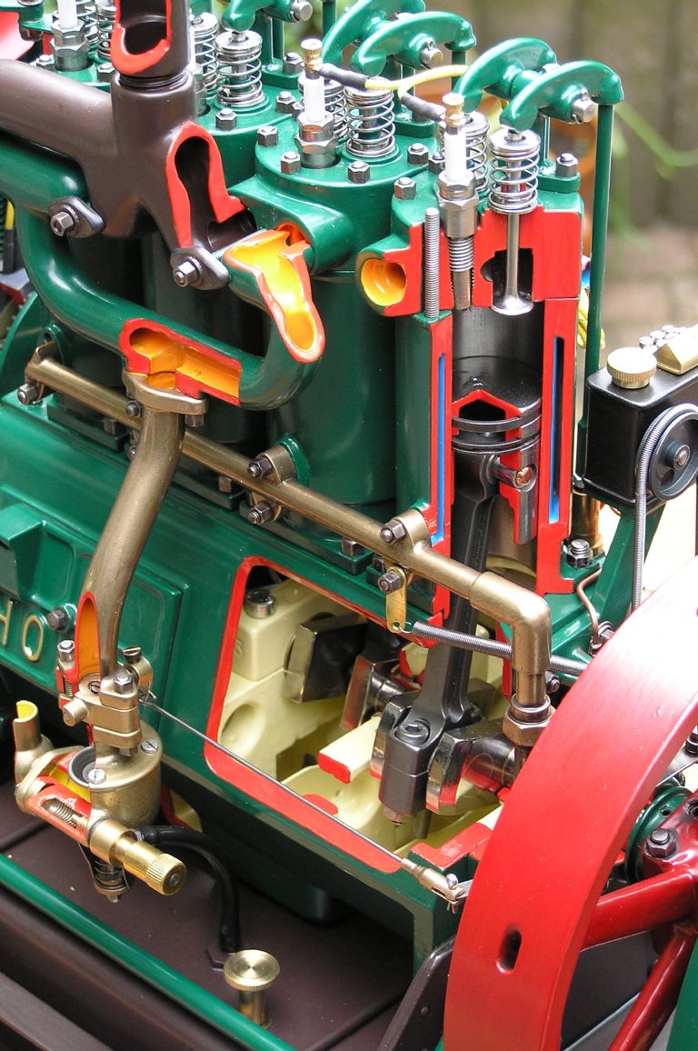

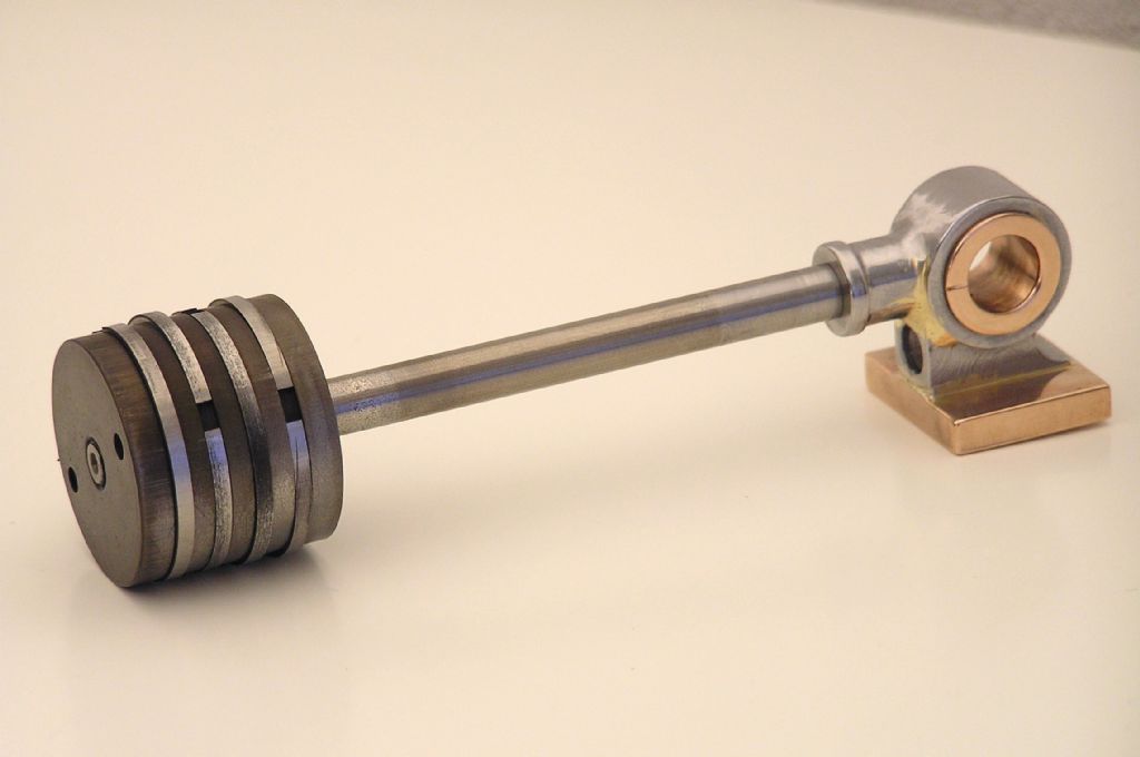

                Johan van Zanten
                  @johanvanzanten
                  Hi Don,
                  I have made a lot of IC engines over the years and I mostly use continually cast c.i. for the cylinders and piston rings. For slow revving engines I use c.i. for the pistons too. I use the George Trimble method to make the rings. This method appeared in the Strictly I.C. magazine February – July 1989.Oil control rings made by this method give also good results and with some care you never break a ring. On the photos you see my diesel piston (not run-in yet) and my Holt engine with oil control rings.
                  Holt 75 engine    /2Diesel engine   /4
                  Good luck with your engine.
                  Regards, Johan.
