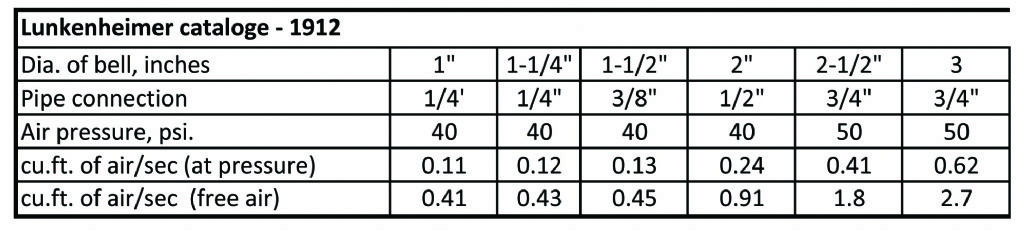

It is going to require a lot of air/steam to make a decent sound…
I read somewhere that unnecessary whistling was strongly discouraged during the steam-age because it's so wasteful. How much steam does a whistle use? Does anyone have any figures for full-size or model locomotives?
More usefully perhaps, the diameter needed to achieve a given flow depends on length too – 10 metres of ⌀3mm pipe offers much more resistance than 0.1m of ⌀3mm, and heat loss from long pipes makes them even worse. In practice, driving a big whistle calls for largest shortest pipe that can be managed: a long small diameter pipe is likely to throttle the whistle. I vote for the biggest diameter that looks OK on the engine.
