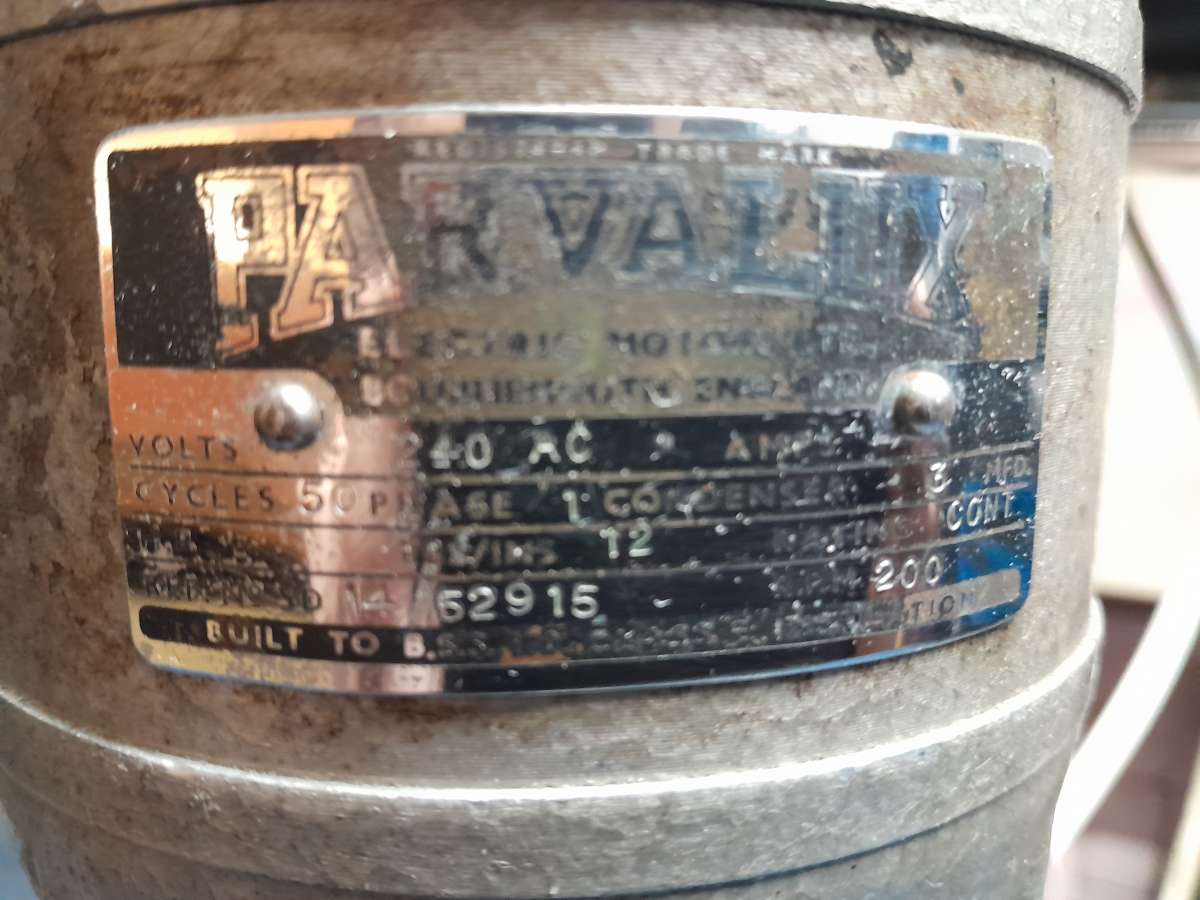

      i have a small Parvalux motor with reduction gearbox. it wont run so i thort i would ask before i take it apart. it has 3 wires out 1 black and 2 white and a capactor . black wire to power. white wires of motor and cap joined together as instructed on capactor . it just hums its free to rotate. tested with no load. i bought it second hand and have never had it running. idea’s please.

          Robert Atkinson 2
            @robertatkinson2
            Model number and a picture of the motor and data plate(s) please.

                        #839866
                        martin haysom
                          @martinhaysom48469
                          motor
                          thanks for the replys
                          done a few checks
                          105 ohms across 2 white wires
                          53 ohms across black to white wire
                          and same to other white wire
                          capacitor is marked 3uf
                          dont know how to check it but cant charge it with a megger

                              #841559
                              martin haysom
                                @martinhaysom48469
                                update. new cap arrived and fitted. motor would not run so i took the motor apart except the gearbox would not come off the shaft could find nothing wrong so put it all back together and it worked. the gearbox is full of nice clean grease but i would still like to strip it as i think some thing is not right
                                #842159
                                martin haysom
                                  @martinhaysom48469
