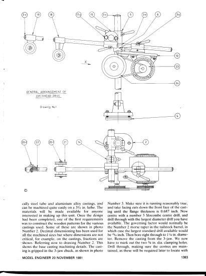

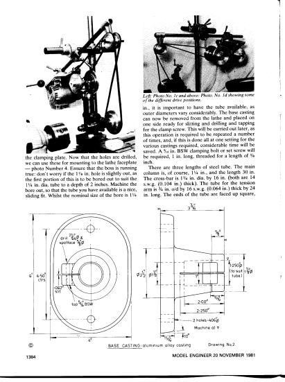

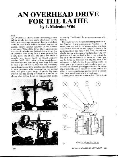

There are a number of overheads shown and Malcolm also developed a fairly sophisticated version (with a small motor mounted at the rear) which I believe was published in ME (not got time to dig it out this morning) and at one time a kit of parts for this device was available from Malcolm (not sure if it is still is though).
