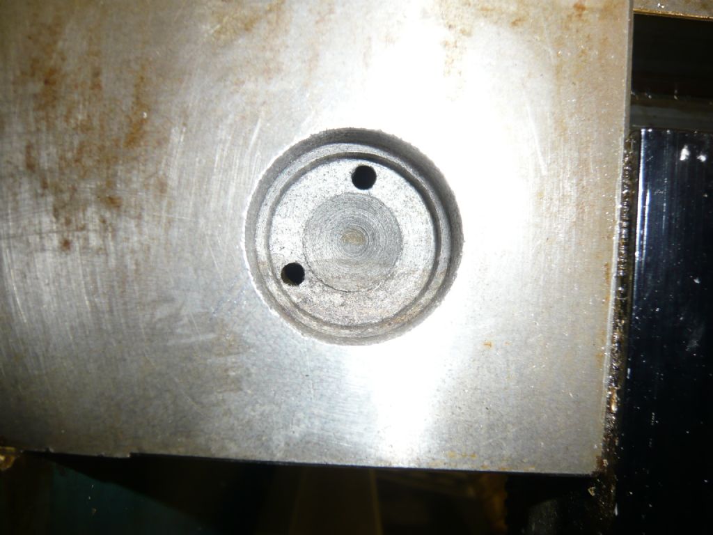

                                #433330
                                Brian H
                                  @brianh50089
                                  Old Mart, you are correct that it needs a wash out, and now it's had one!
                                  Here is a picture of the housing and as can be seen, one of the holes is at 8 o'clock, meaning it would never drain completely.
                                  Brian

                                  #433356
                                  old mart
                                    @oldmart
                                    Maybe their logic in putting the hole there was to show oil even if it was empty, the required level being from 1/2 to 3/4 up the glass. Some of these sight glasses are pretty vague as to whether they are full right up or empty.
                                    Forget my thoughts on a groove.
