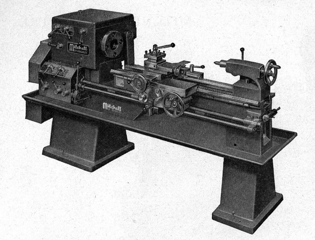

                    Hi Marc, don't know if this is any help to you, but it looks like you have this model.
                    Regards Nick.
