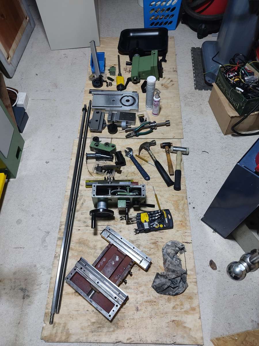

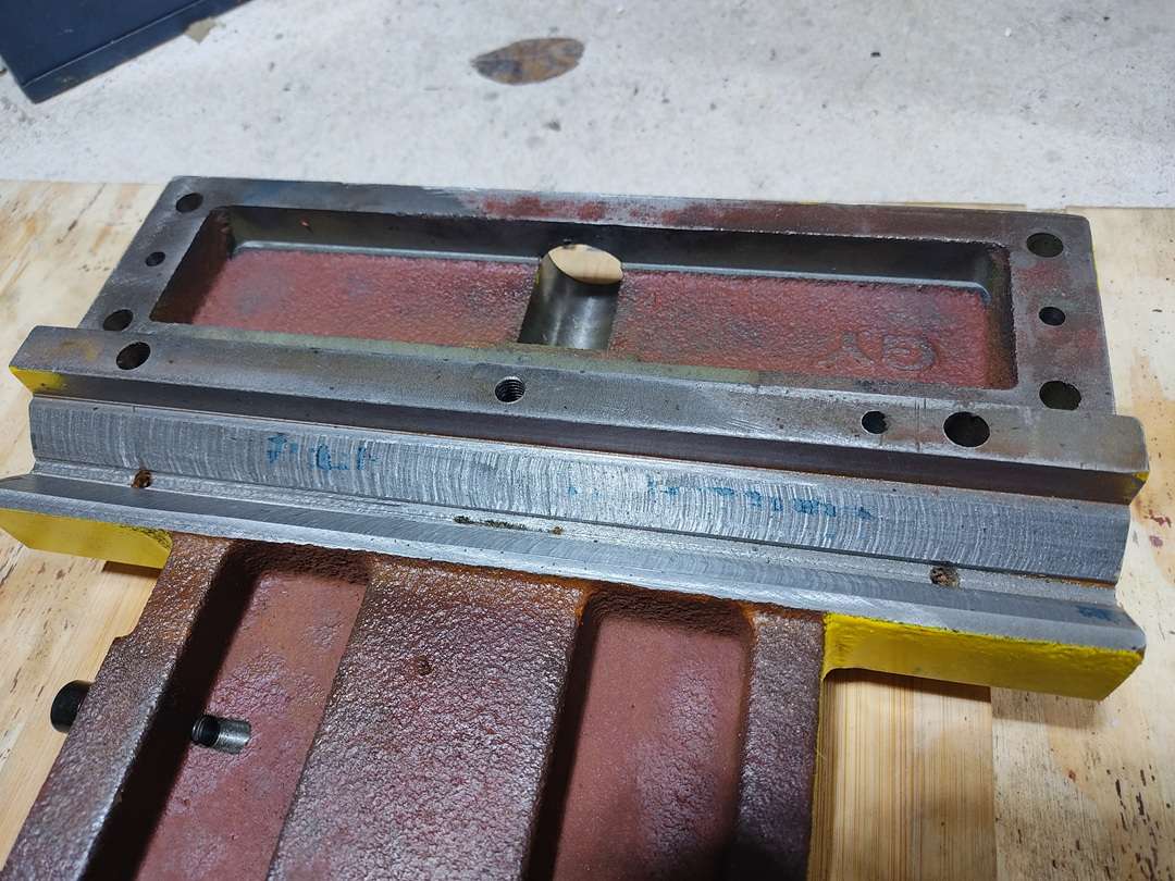

      Hello everyone,
      I purchased a new Warco D330 lathe a couple of weeks ago. Overall it seems like a decent machine, however I made the decision to strip it completely and give it a deep clean after seeing the amount of grinding dust/swarf that was  sloshing around in the headstock. Every surface felt very gritty, with obvious signs of grinding dust…which can’t have been from any deburring being done (there is even a sign on the machine to wear gloves to avoid being cut 🙂
      Lathe
      Still it’s from China so I can’t expect too much, and you get a lot of features for your money I think.

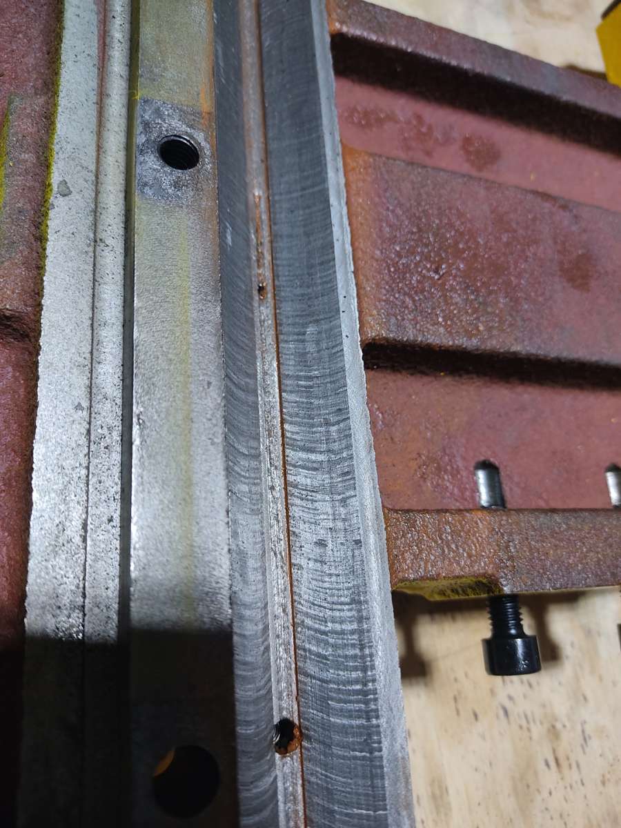

      The components were looking fairly decent as I went through the process of stripping the lathe, however the vee section of the saddle is horrendously rough. It almost appears as though whatever machinery they used to rough the vee section in, went too far leaving too little material for final finishing, and it was left at that. Its hard to capture on camera but I estimate it would take at least 0.5-0.75mm of a surfacing cut to bring a smooth surface to the vee’s (i.e the difference in height between the valleys and peaks of the machining swirls). I have not yet had an opportunity to blue the bed up to see what the actual bearing is like however.

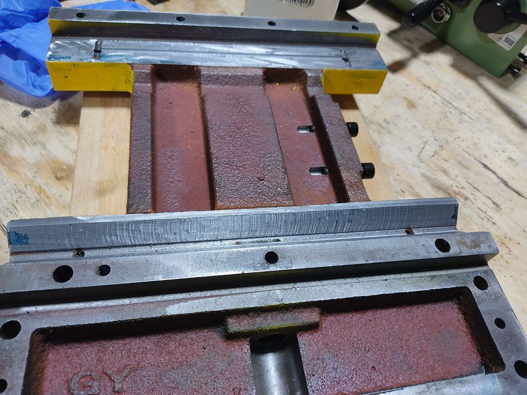

      Saddle

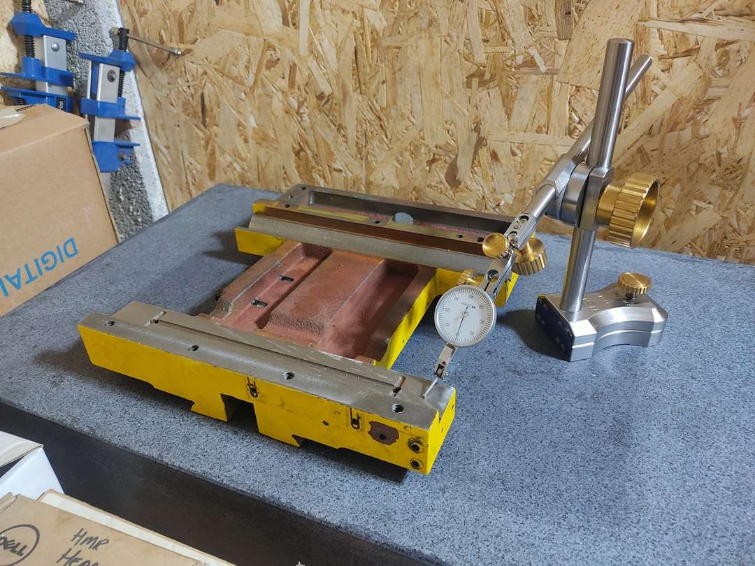

      The flat section of the saddle seems to be fairly flat and parrallel to the top however, around 0.03mm deviation along the length of the flat section.
      DTI

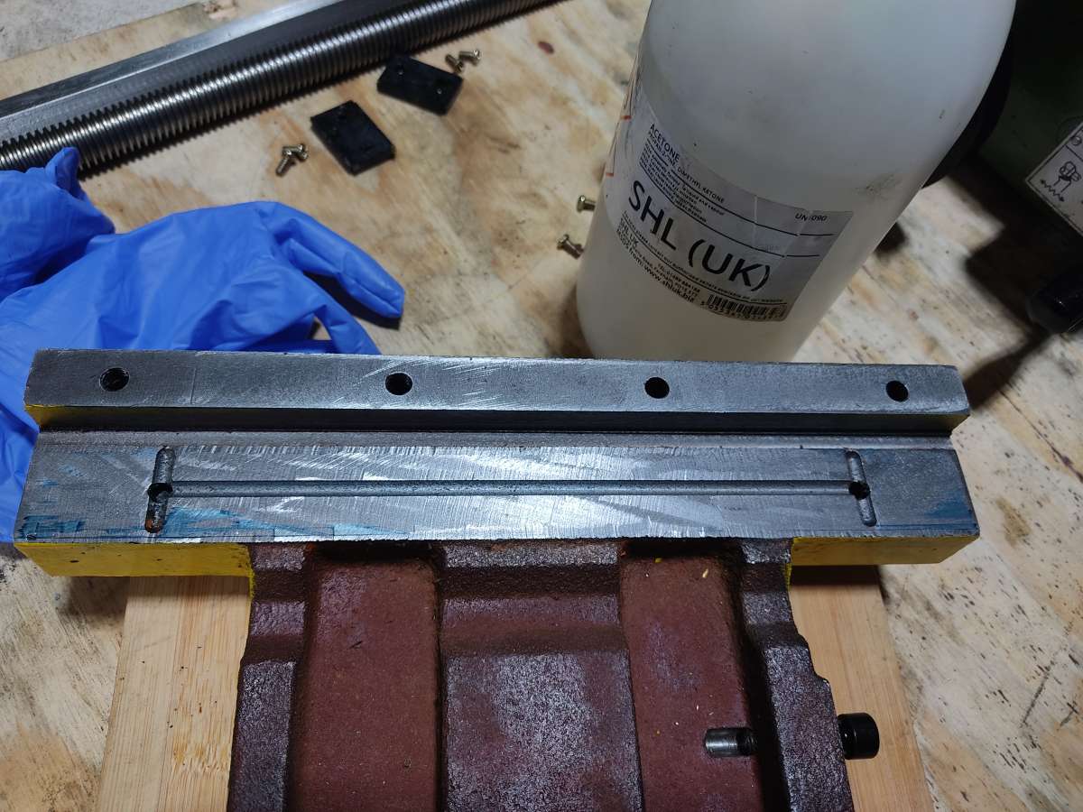

      My question though is what to do about this? I’d like to improve things while the machine is apart to maximise it’s useful life and prevent rapid and uneven wear to the saddle as well as the bedway.
      The options as I see it are scraping it in, although removing this amount of material may cause issues with how the apron interacts with the feed gears, and the half nut etc.
      Perhaps I could fit a strip of Turcite to the saddle and scrape that in?
      The other option I considered was using a slideway epoxy to essentially fill in the gulleys of the rough machined area.
      I’d appreciate any thoughts or input on this…what would you do?

        I would send it back to Warco as “not fit for purpose”.
        Andrew.
        #798927
        Pete
          @pete41194
          That picture is disgusting for how it left the manufacturer. And it shows the value of pulling even a new machine apart for a thorough inspection, cleaning and de-burring. With some but maybe not all lathes, the saddle ways are recessed a bit in the center area, and the actual saddle ways are only bearing on a few inches of each end for the front and rear ways. Given that the cross slide is above that, I’m not sure I’d agree with that method. And more bearing surface is going to wear slower.
          If your 100% sure you have the skills to properly scrape it in and still maintain all the proper alignments. Turcite would be the way I’d go, and for the reasons you’ve already mentioned. While your checking the fit against the bed ways with the ink, I’d also want to indicate the cross sides dovetail across it’s width to each other and the bed, along there length, and parallelisum. I’d think there’s a fairly good chance those may be incorrect. If so, your going to need to scrape the carriage bottom surfaces into alignment for that as well. I might understand how it’s done, but I don’t think I’ve got the experience and skills to be sure of my success for a job like this. Have you got a high precision machinist level to get the bed leveled for these checks?
          While it’s not the fault of Warco, I’d be sending pictures and any misalignment numbers I found to them as well. They can’t demand the manufacturer’s do better unless they know about issues like this. You also have a warranty and fit for purpose laws.

                I’m inclined to say that the pattern that can be seen on the Vee surfaces is fairly typical of the mechanical scrapers they tend to use rather than any lingering marks from initial roughing out machining.
                Sending it back is an option but a replacement is likely to be similar so what option are you left with. refund and then what to buy maybe a new Harrison/Colchester if you can still get a manual one but don’t expect one of them for anywhere near the same price.
                Also the surface you have it stood on on your granite plate is a non contact surface so possibly not the best one to be taking measurements from.

                    Those look like machine marks with a blunt cutter, looks like it’s tearing the surface.

                            I recently took the saddle off* my (much smaller) Warco lathe and found a similar finish. Since I’ve had it for a couple of years now, and it works perfectly satisfactorily, I didn’t worry about it.
                            Put it back together and if it works properly that’s all you need to do.

                              I’d start by establishing whether or not this condition matters!  A poorly finished bearing surface is a problem, whilst roughed out metal that doesn’t touch anything isn’t.
                              The D330 looks like my WM280 except it’s bigger, more rigid, and has extra features, notably geared speed control.   In which case the saddle may be fine, but I don’t know without seeing it.  In principle, not good for the whole saddle to bear on the bed because that increases friction, is hard to lubricate, and it doesn’t improve accuracy or rigidity.   I advise Mark to put the saddle back and check what it actually runs on: if the touching surfaces are rough maybe speak to Warco!
                              The conversation will be a severe test of Warco’s willingness to support the customer because Mark has broken the warranty conditions, my bold:

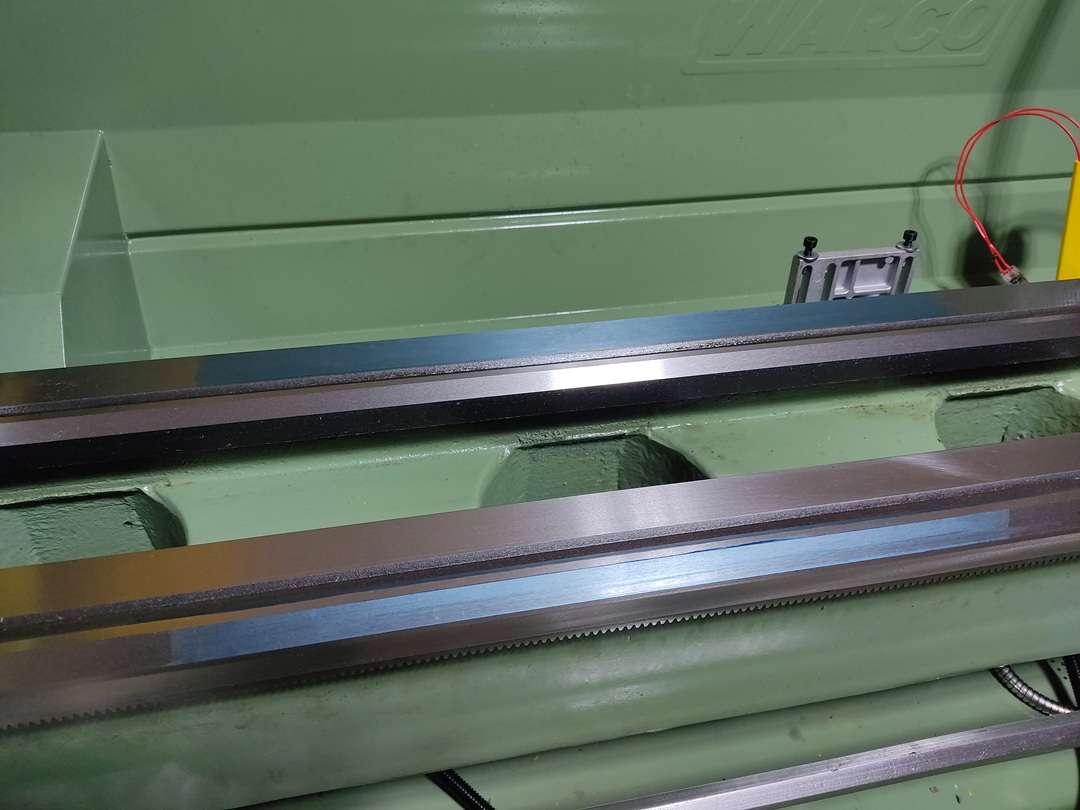

                                I think my justification for stripping the machine was warranted as I seem to have uncovered an issue in an area that the average buyer might not have considered to look at. Put another way time/money was potentially saved by the manufacturer in an area they thought no one would look! Incidentally getting the machine apart to this level was not very difficult and required no special tools apart from a slide hammer to remove some tapered pins, and nothing has been modified in the process, it can be put together in the same condition it left in.
                                This machine was expensive, it was at the very top end of my budget but I thought I’d make the purchase in the hope it was good value. I think apart from this saddle issue it is good value, you get a lot of features for your money.
                                I did have a chance to blue the saddle to the bed this morning, it’s not inspiring great confidence as the bearing is very sparse:

                                  I would suggest the OP puts his lathe back together and see if it is ‘fit for purpose’ i.e. turns parallel & faces concave, if it performs as designed just use it, if not contact Warco and see what they are willing to do after your strip down.
                                  My 290V lathe has just the same horrendous machining but it performs well so I just enjoy the machine and it’s capabilities.

                                        I bought a new Warco GH1330 in 2004, after just several hours of use I noticed a scuffing pattern appearing on the bed guideways.
                                        I removed the saddle to find exactly the same rough finish to the bearing surfaces on the underside of the saddle as on your new lathe.
                                        Checking revealed just a few pinpoints of contact with the bed, I had to do something about it as it was damaging the bed surface, the early scuffing would eventually become premature wear.
                                        So I cut long strips of Aluminium Oxide paper and used a mild glue to secure the strips to the vee and flat saddle guides of the bed at the tailstock end. The strips were around twice as long as the saddle in total.
                                        The saddle was sat on the abrasive paper with oil and slid back and forth, without riding off the end of the paper. The bed surface remains untouched.
                                        The result was a vastly improved surface finish, smooth but with a few shallow pockets left for oil retention. The saddle felt much better when sat on the bed, with a smoother sliding action with a little drag from the cushion of oil.
                                        Accuracy when facing was just as good as it was before I touched anything.
                                        Your new lathe isn’t really faulty, and overall they are good lathes. This rough surface with poor contact is typical of the relatively low cost Chinese lathes, it’s simply the way they are produced, and if you had it replaced you would just find the same sort of thing on the replacement.

                                          Hi lathejack, thank you for the reply. The wear to the bed you suggested is what worries me slightly too, and is exactly what I’m hoping to avoid by improving the fit as you did. Can I ask how much material you think you removed with your fix? Did you notice any problems with how the apron lined up with the feed shafts and leadscrew etc as I assume it was sitting slightly lower after the modification?
                                          I’ve decided to go the bedway epoxy route on my saddle, and use the bedway as a template while its still in good condition.

                                            i did not check or make a note of how much material was removed from the saddle. i didn’t over do it. I removed just enough to remove the peaks and high spots, and leave a smoother and broader contact surface, but still leaving some pockets, along the whole length of the saddle.
                                            There was no difference when refitting the lead screw or power feed shaft, and no deflection of the lead screw when the clasp nuts were engaged.
                                            The lathe bed has not suffered any more scuffing or scoring in the twenty years since i did the work. I chose to do it this way, rather than trying to scrape the rough surface, to try and ensure the saddle sat on the lathe bed vee way in the same position so that facing cuts did not end up becoming convex or too concave, and it worked.
