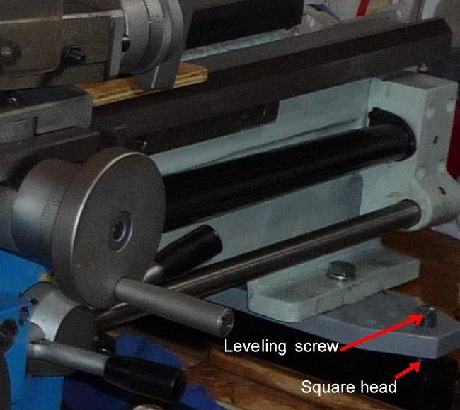

                                    Thor 🇳🇴
                                      @thor
                                      Hi Terry,
                                      I have a 290 lathe and used two 15mm thick steel plates with holes for bolting to the bottom of the headstock and tailstock. At front end rear end I drilled a hole and tapped MF 14 x 1 and made four leveling screws.
                                      The first photo shows a sketch (not my lathe, just to illustrate the idea):
                                      Here are a couple of photos from my 290F lathe:
                                      The height adjustment is done with a suitable spanner underneath the grey steel plate – the head of the leveling screw is underneath the steel plate and has a square head.
                                      I drilled 8mm dia. holes through the leveling screws and use M8 bolts to tighten them down after adjustment.
                                      Thor
                                      Edited By Thor on 24/02/2014 05:55:55
