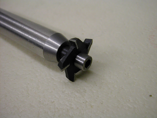

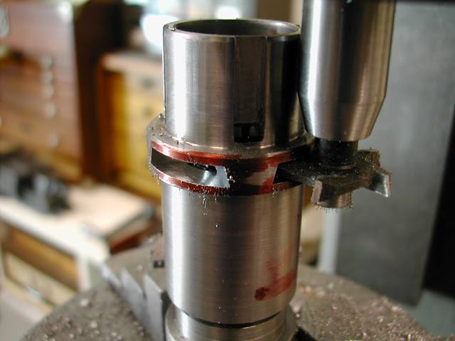

                                                Just an update on finishing these liners off.
                                                The original ports were required to be cut in with a woodruffe cutter with the edges ground at a fifteen degree angle. A cutter blank was turned to this spec from silver steel and the teeth milled in then bearing in mind the problems experienced on the Racers with insufficient backing off due course was paid to this by filing before heat treating. Quenched in oil it was left untempered and the cutting edges touched up with a diamond lap. It sailed through all sixteen slots with ease, no coolant, chipping well in the EN1a and no rubbing.
                                                The exhaust width at the inner face looked very small but comparing it to the original liner it appears in reasonable proportion. It’s fair to say I’m well pleased.
                                                Not much more machining to do now – just the pistons and conrods plus the incidentals – needle valves and comp screws and the lapping in of pistons and liners of course.

                                                #68179
                                                Bill Pudney
                                                  @billpudney37759
                                                  This is all really interesting Ramon, keep up the good work!!
                                                  About the woodruffe cutter for the exhaust ports…..is the cutter just secured to the arbor with a socket head screw?

                                                      The cutter Bill is a separate item to the mandrel. It is held by a 4mm cap head which had the head turned down for clearance on the exhaust flange. To ensure concentricity the 6mm diameter stem on the cutter itself locates 6mm deep in a hole bored in the mandrel
