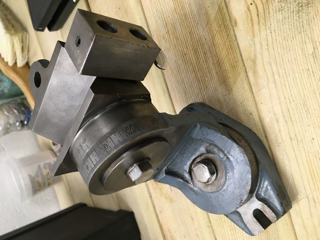

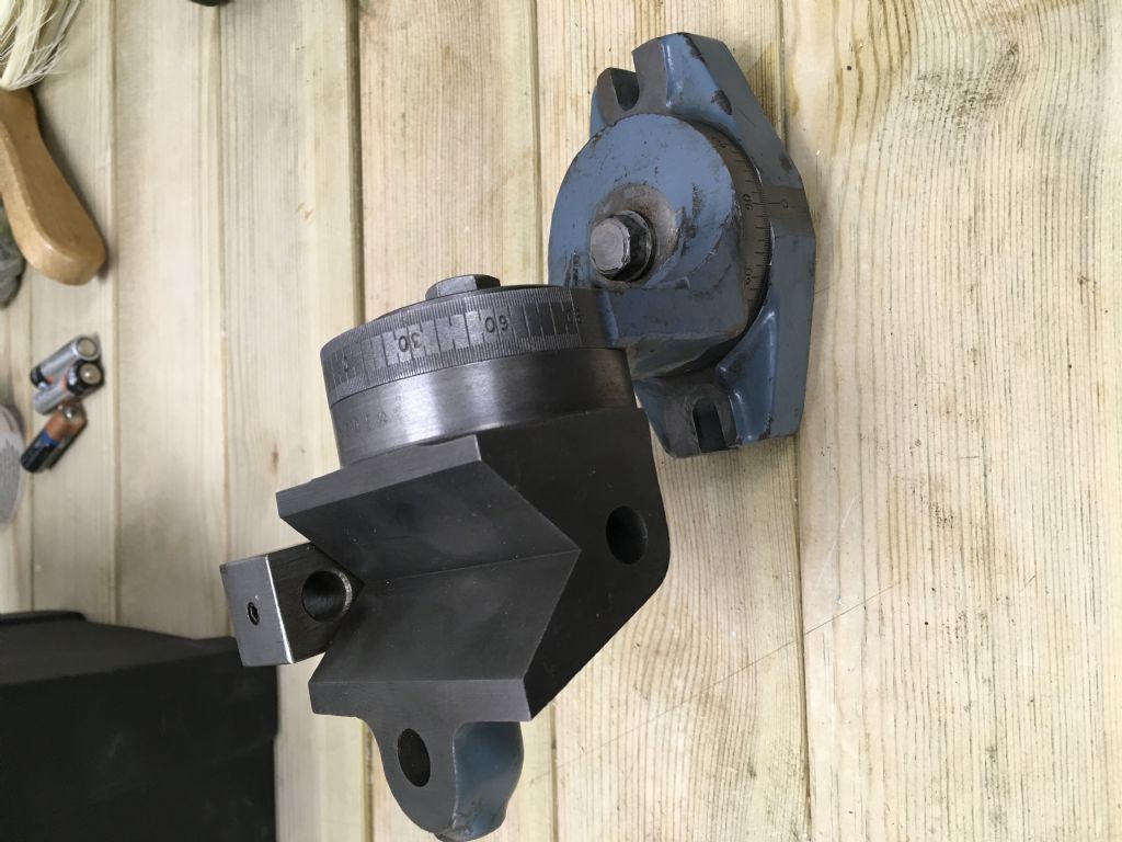

        Does anyone recognise this rotating V-block? There's no makers name or other marks that I can see. The key is for a 7/16" T-slot, so it doesn't fit on my Super 7, even though I discovered it in the stand that the lathe came on.
        Any ideas on what it's used for gratefully received.
        James

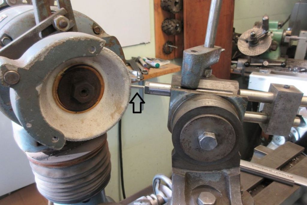

          Off a cutter grinder

            Thanks very much. Which model of grinder is that?
            #433347
            Phil P
              @philp
              100% Union T & C Grinder
              Phil

              Brian Oldford
                @brianoldford70365
                ICBW but the base looks not dissimilar to that of a Myford 2 way Vertical Slide.
                #433377
                Mick B1
                  @mickb1
                  Posted by Brian Oldford on 14/10/2019 21:19:18:
                  Don't know if they made other models, but mine has two studs in each swivel, and the base uses the same 2 studs to clamp to the crossslide via tee nuts. It's also a good deal more substantial.

                    Posted by JasonB on 14/10/2019 20:16:47:
                    Aha, so you have one too. I got mine free from work.
                    Martin
                    #433409
                      No not mine, just a friend's who happened to post that photo the day before.
