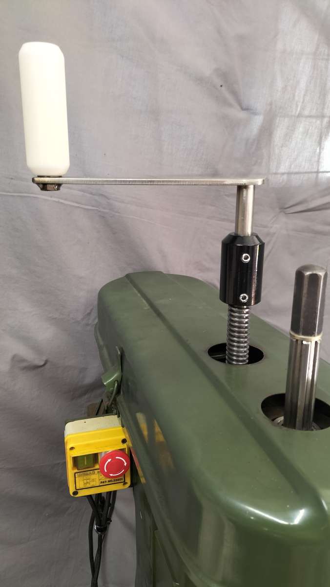

                    The aim is to have rapid head movement and reduce the number of loaded cycles, wear & tear on the fine feed mechanism.
                    A step will enable me to reach the new lift handle once the head is high.

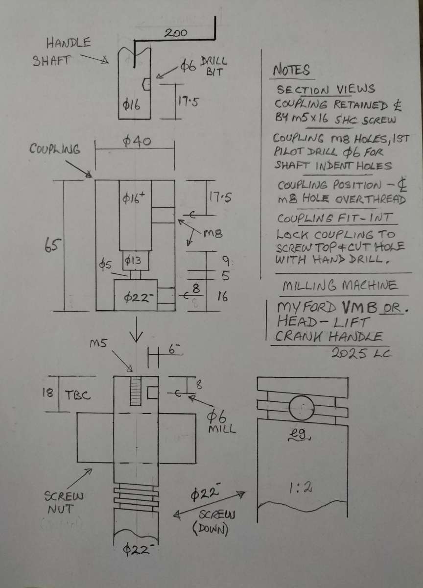

                            The rapid movement handle on the head screw is made & functional.  Can just feel the fine feed worm engage the screw through the new handle.  The pin type grub screw was positioned through the thread into the shaft 3mm, 8mm from the screw top, cut with a 6mm slot mill.  Total travel is now 55 turns versus 550.  Can give details if wanted or PM.IMG20251008151359

                              Thanks for the photo. Could you clarify – “…the shaft 3mm, 8mm from the screw top, cut with a 6mm slot mill…” please? Did you remove the screw to mill or otherwise how did you guide the cutter?  Was the screw hardened?

                                  See the drawing, grub screw holes were cut on the machine, the screw in not hard.
                                #819559
                                John Haine
                                  @johnhaine32865
                                  Thanks Lawrie, all clear now.  Using the threaded hole in the top of the screw to clamp the collar on so the grub screw hole can guide the cutter – neat.

                                      Pics do tell a 1000 words.
                                      One word missing on the drawing title is “RAPID” Lift.
