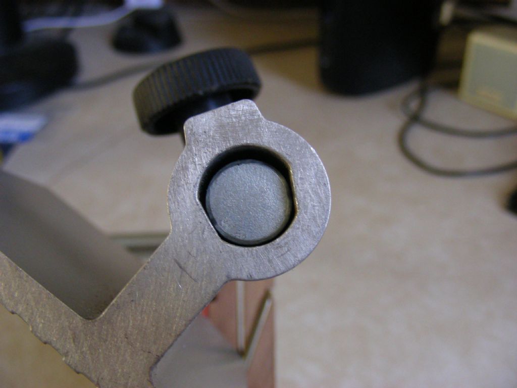

            Thanks for the link which I will pursue. In the meantime, as a patent buff, you may be interested in the three point arrangement of the Tormek work rest which I hope is clear from my photo:
            The wedging action is such that when the black knurled clamp screw is loosened the rest retains its position but is readily removed.
            I would accept "urge" to describe the action of the clamp here; in other situations, "bias" might be appropriate.

                Posted by ega on 09/10/2019 11:19:26:
                MichaelG:
                Thanks for sharing that ^^^ … it’s neatly done yes
