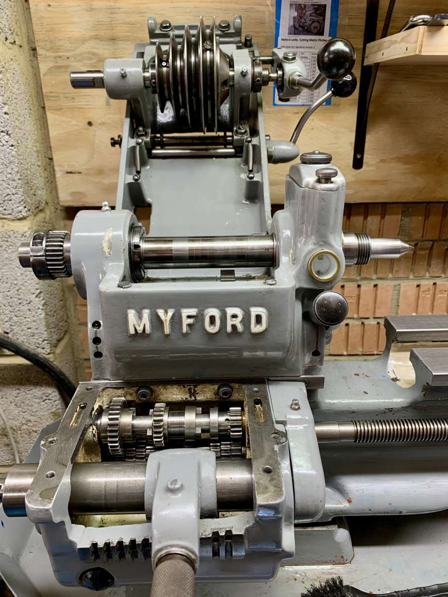

      Hi,
      I have just rebuilt my 1955 Super-7B; had the bed, saddle & cross-slide reground, etc…
      I also fitted 2 x new angular ball-races to the spindle, I left the phosphor-bronze bearing alone, as the spindle run-out at the nose was pretty much zero.
      However, when I fit a 3-jaw Chuck, a 4-jaw or a ER-32 collet holder I get the same result, which is about 0.05mm run-out… I have tried to load short videos of the DTI readings… but there seems to be some technical issue…
      Any ideas what is causing this run-out??
      IMG_5536

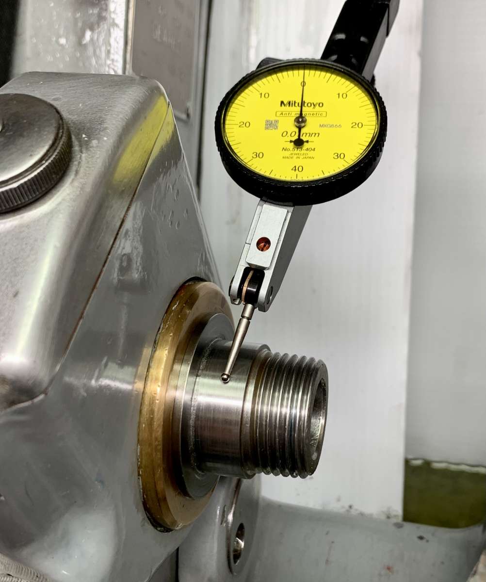

        Where did you measure the spindle run-out, and what type of collet holder?
        If the measurement was on the inside of the MT2 bore but the collet holder fits on the nose thread, the observed runout could be because the external register is not quite true.

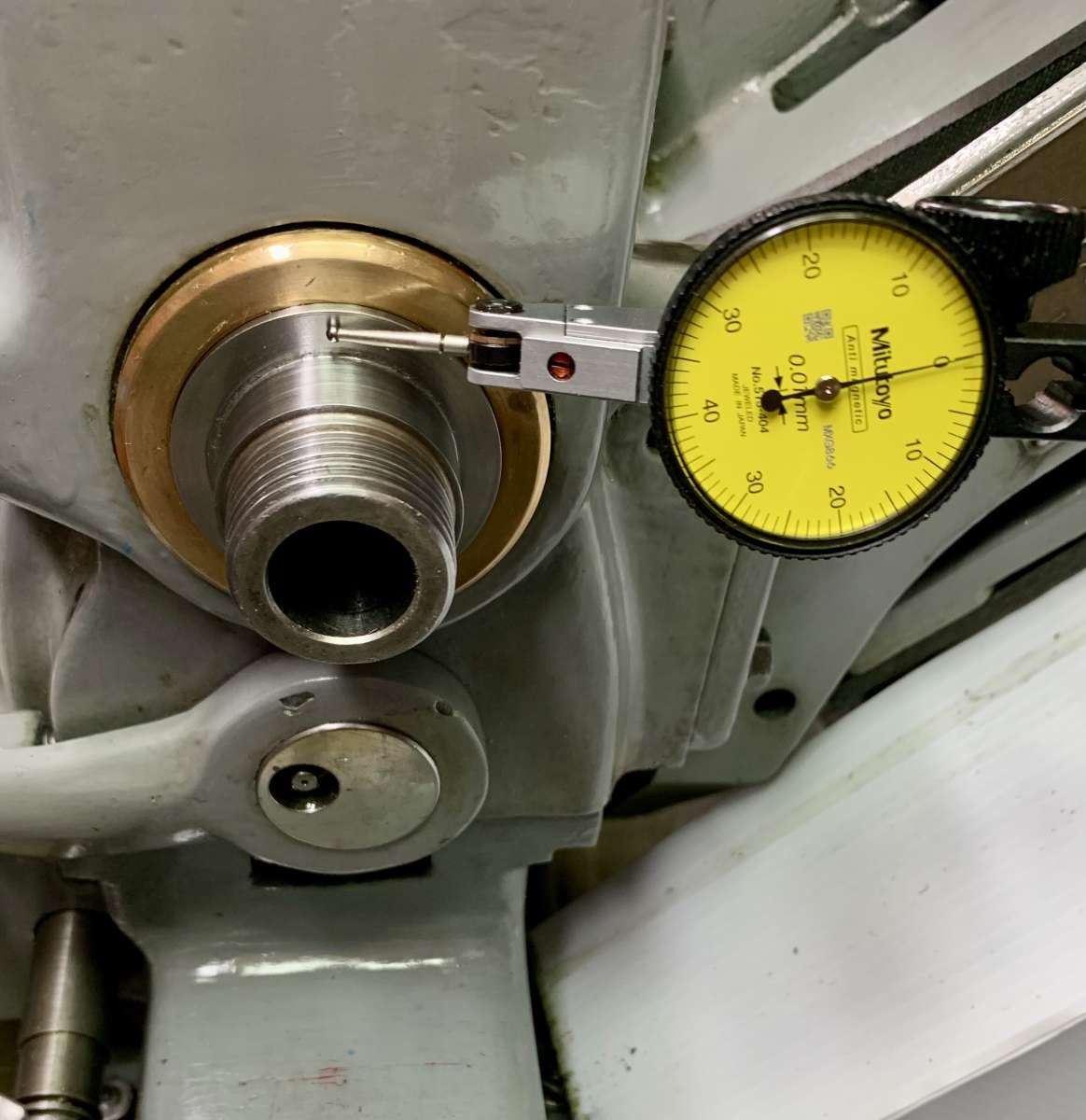

          #797032
          flatline
            @flatline
            Here are 2 photos of where I measured the spindle run-out…
            IMG_5679IMG_5680

              Thanks.  So on the cylindrical part and the flange of the register, and you measured negligible run-out?  Assuming that your collet holder fits on the register as well, maybe something is stopping the chucks seating on the register properly.  It looks like there’s a little bit of galling near where the cylinder meets the flange, could that be problematic?
              #797043
              flatline
                @flatline
                There is galling present, but it doesn’t affect the seating of the chucks or collet-holder.
                Of note is that neither of the chucks nor collet-holder use that cylindrical portion of the spindle to locate/register… it appears that they use the vertical back face on the spindle  & the threaded nose only…(?!)

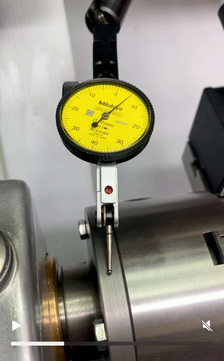

                  And where are you measuring your 0.05mm (2 thou) runout? 3-jaws can vary in accuracy and hard to say a 4-jaw has runout. Are they threaded body chucks or on backlates?

                      #797070
                      flatline
                        @flatline
                        JasonB … the 0.05mm run-out was measured on the chuck back-plate, threaded on to the spindle..
                        IMG_5685

                          The chucks should register on the cylindrical portion and shoulder face. The thread is only there to hold them on.
                          There are people who for some reason like to question this, but I would advise them to read the manual. It says this:
                          “Backplate register bores are held to very close limits. When backplates are supplied with the the machine, they are carefully selected and adjusted to suit the spindle nose so as to retain the closest possible contact between register bore and register diameter. When backplates are supplied either as separate units or fitted to chucks after the machine has left the works, the backplate bore may need very light scraping or polishing with fine emery cloth.”
                          It also says the same applies to threaded body chucks, and to use a bit of oil.

                            Your chucks are unusual in that they don’t locate on the plain 1.250 diameter of the shaft. Locating on a thread is never a good way to ensure concenricity. If your chucks did locate on the plain diameter, even 0.05 clearance on diameter could result 0.05 dti runout if you were unlucky with where the chuck, etc. decided to sit and it could be different the next time you fitted it. If the locating diameters of the chucks, etc. are greater than 1.250 inches (the standard Myford dimension) either a previous owner has deliberately bored them out to, perhaps, allow tapping them true or they are not intended for a Myford 7 lathe. Or an, extreme case, somebody has reduced the spindle nose diameter from 1.250 inches !
                            #797075
                            ChrisLH
                              @chrislh
                              Flatline
                              Just seen your 15:12 post. The runout of this part of the chuck doesn’t matter, it’s the runout of a decently round and finished piece of material gripped in the jaws that’s crucial.

                                    When people fit a new backplate, chuck etc the backplate step that engages with the back of the chuck is trued to fit the chuck. The outside edge of the backplate that you are measuring is not important.
                                    Some people allow a tolerance there to tap a 3 jaw to more accurately hold the work, which of course throws out the chuck body

                                        As already mentioned, the runout of the OD of the backplate is meaningless, what matters most is the face which the chuck bolts onto. It is normal for a backplate to require skimming on its face, after screwing it on and off several times to settle down the threaded connection, both halves of which must be absolutely clean. We have about 10 backplates for the museum’s Smart & Brown model A which have register diameters varying from plus 0.0005″ to 0.020″ relative to the spindle, and they all repeat perfectly, the tight one is a pain to fit and remove.
                                        You could skim the OD of the backplate if you want to, it will not harm anything.
                                        With a replacement second hand backplate, if the register which the chuck fits on has radial eccentricity, it will either have to be reduced slightly, or the backplate will have to be faced back to allow a new register. This can be done if there is enough thickness, or as I recommend, leave it loose, you will be able to adjust the running of the jaws to zero at any holding diameter. The bolts will stop anything slipping, after all, you only use bolts and clamps on a mill bed to hold things, and nobody worrys much about that.

                                                  We are all making the assumption that the register has zero run out compared to the spindle bearing diameters.
                                                  If the spindle nose is showing zero run out, the 0.05 mm is within whatever you fit to the spindle.
                                                  To have a 3 jaw chuck that holds work concentric within  0.05 mm (2 thou) suggests that it is a good one.
                                                  To engage any chuck on the cylindrical register, there HAS to be a finite clearance, probably about 0.05 mm. You would have a struggle fitting or removing if register on spindle and chuck were size and size!
                                                  If you think about the clearance necessary between register and backplate and then the clearances within a 3 jaw chuck (individual jaw / scroll, scroll/body) getting work held to less than 0.127 mm (5 thou) run out is pretty good.
                                                  If you want to have work absolutely concentric, then use a four independent chuck and keep clocking and adjusting until the eccentricity falls within your standards of acceptability.
