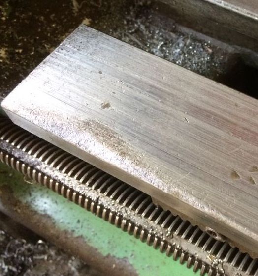

      I have uploaded two photos of my Super 7 bed, which show some rather nasty wear near to the headstock. My question is, does anyone know what this might have been caused by?
      I had seen several Super 7's before buying this lathe, and they had significant wear. I have nipped up the saddle gibs with the saddle near the headstock and the carriage only starts to tighten when moved to within 4" of the end of the bed, and even then it is still movable. Would you consider this average wear?
      The saddle has no movement when I try to lift it at the rear, so the shims seem to be doing their job. However, there is movement when I lift the saddle at the front, even at the very end of the bed. Is this normal? Do you think I should fit additional shims to remove this movement?
      Once again, many thanks in advance,
      Mike

          Looks more like abuse than use to me. Previous owner had an angle grinder, or hammer, and wasn't afraid to use it? Looks like said owner also had a triangular punch which he "tested" on the bed.

            You beat me to it—my thoughts were on the use of a coarse file on the front shear especially.
            The other marks may well have been made by chuck jaws as he dropped them on the bed with the sudden weight from unscrewing the chuck from the spindle nose. I think Mike would be well advised to check the lathe over carefully to see what other liberties may have been taken with it.

              Looks more like cleaned-up corrosion damage than wear to me.
              Quite a lot of materials attract water. Possibly the lathe was left for a long time with something like a heap of damp sawdust on the ways, or a chemically treated cloth was braced across that edge and the lathe did nothing but polishing. It's a bit odd.

                I looked again at your specific questions concerning shims and saddle lift. From what you say, the wear across the bed doesn't seem to be so bad, I would expect it to get slacker near the chuck end though and you might find the saddle slewing on return under power which will give another cut on a boring tool as it is withdrawn.
                If you know that is a feature of the lathe wear you can allow for it accordingly. At my last place of work I had to allow for a lot of that on an old DSG lathe but even with the degree of wear that had it was still possible to bore accurate bearing pockets.
                Lift on the front of the saddle is reduced by removing shims from between the flat strip bearing on the underside of the front shear and where it is bolted up to the saddle with two cap head screws. Test the result over the full length of the bed.

                  A friend had a similar problem on his old S7. The wear was on the rear vertical face of the front section of the bed. The saddle is guided by the the front and rear vertical faces of the front part,(the "shears". I overcame it by inserting a piece of ground steel, of the minimum thickness that would fit, between the unworn rear face of the REAR part of the bed, and the rear "flange" of the saddle. Small pieces of brass were screwed on to prevent the new piece of steel from moving sideways due to friction. The adjustable gib on the front was readjusted to give the correct about of clearance for the saddle to move smoothly, at the same time ensuring that the original short face on the saddle was just clear of the bed. Ideally, this face which is now redundant, should be milled back a little to ensure that the saddle is in the correct front to back position, for the alignment of the half nuts. We did not have the facilities to do the last bit, but that lathe is still doing its stuff forty years on.

                    I have just read your original post again. As Brian says, you reduce lift by removing shims; actually, in the case of the S7, the shims are soldered together in a stack and my be pealed off one at a time. The can be tricky to start; I seem to remember resorting to an old fashioned razor blade. I can't remember how thick each layer is I'm afraid.

                      Many thanks to you all for your help. The lathe was bought at a relatively low price for a powered cross slide model with a gearbox and being my first metal lathe (I've done plenty of woodturning) it was a risk I took to get me started in metal turning and lathe milling. I'll adjust the shimming of the saddle over the next few days as I assume this may help with milling..

                          My Spidey sense is saying to me ground out hacksaw marks from parting off with a hacksaw.

                                  I think it's also true as others have said that the bed wear itself and the bruise marks as shown aren't especially serious – it's whatever else there may be that's not so conspicuous that could be worrying.

                                    Not at all really. The carriage rides on the full width of that flat surface so the 1/8" missing will not alter the path of the carriage at all. Main guide when turning, however, is the vertical surface of the shear, the one at the rear, away from the operator. The pictured damage/wear does not impact that surface at all.
                                    Dings and dents don't matter particularly either, as long as the resulting "bump" of displaced metal is filed or stoned down flat. A 10" flat file, fine cut, will do the job in a couple of strokes.

                                      The individual shims in the laminated shim packs are 0.003" each. I measured them about 6 months ago when I was reassembling my S7 after a bed regrind.

                                        i would have guessed repeated use with a toolpost grinder without protecting the bed

                                          That was my guess too, Russ. Perhaps even a grinding fixture for grinding tool bits? It looks almost as if sparks have eaten away the metal over time. Is that possible?

                                            If that's so, all the more reason for a critical examination throughout, and a thorough washdown to get rid of the abrasive grit that could be in any and all parts of the machine.

                                                  I'm sorry to say but just cleaning may not be anything like enough to remove what might be lurking under the saddle. I would be stripping the saddle completely to be sure and checking all the other sliding surfaces and dovetails
                                                  Another felt wiper across the front of the tailstock is a good investment, you will have to make the holder and find some thick felt but it will all pay real dividends in keeping fine swarf etc away from getting into the sliding surface under the tailstock shoe.

                                                      Does not look like the results of toolpost grinder to me. Never seen that kind of spark erosion around grinders before.
                                                      Looks more like some kind of steel tool was rested there, many many times over. Wood turning? Knurled handle of a tap wrench – used over and over several thousand times in a production situation?
