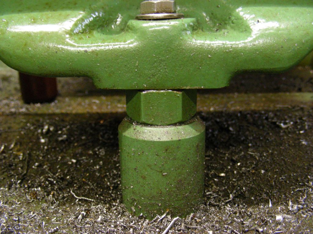

      Myford raising block
      #317043
      Ian Skeldon 2
        @ianskeldon2
        Hi,
        I have recently obtained a very nice Myford ML7, if I decide to keep it I might want to add a few extra useful tools or accessories. I have seen Myford raising blocks for sale and I basicly want to know, are these to go under the mounting lugs and raise up the whole lathe to a higher position or do they fit under the heand and tail stock to increase the sizes of tools that can be used?
        Sorry if this is a dum question.
        Ian
        #317044
          They go under the feet to raise the whole machine not to increase the swing.

              Raising Blocks also ease the task of leveling the lathe. See classified, i have an unused set for sale..

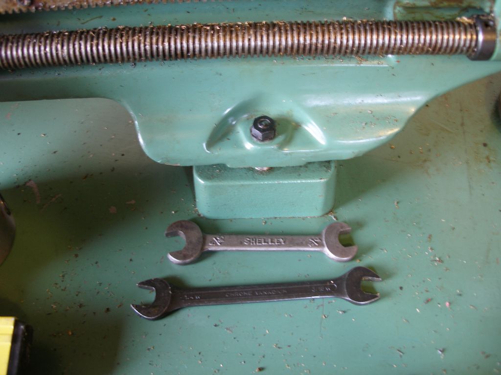

                        Sorry, I realise this an old thread, but I have taken over my Dad's old ML10 and it is currently mounted on wooden blocks. It is an early ML10 with seperate mounts for the countershaft/motor bracket.
                        Two questions: Would ML7/Super 7 raising blocks fit a ML10, and in my case would I also need to make up something to raise the pivot block for the countershaft/motor bracket?
                        #407612
                        bricky
                          @bricky
                          offcuts of 4"*2" steel channel will serve just as well as paying for Myfords own.I just get offcuts at the local steel stockist and crossing the palm works wonders.

                              Well not exactly. Myford raising blocks are threaded to take jacking screws which have hexagonal spanner flats in the top so they may be raised or lowered into or out of the block. The lathe foot sits on the top of the jacking screw with the stud part of the screw through the fixing holes in the lathe feet. To adjust the hold down nut on the top is loosened and the jacking screw is adjusted unsing a spanner under the foot to raise or lower the mounting surface. The hold down nut is tightened and the alignment checked by your favourite meathod. See recent extensive thread on this.

                                The ML10 style of raising block do seem to be just a spacer and don’t have the facility for adjustment as the blocks for the 7 series do. I don’t have first hand experience of the 10 series but they look a very different beast from 7 series raising blocks. If they don’t have facility for adjustment then heavy gauge box section would be a cheap alternative and making an adjustable insert would not be too difficult if required.
