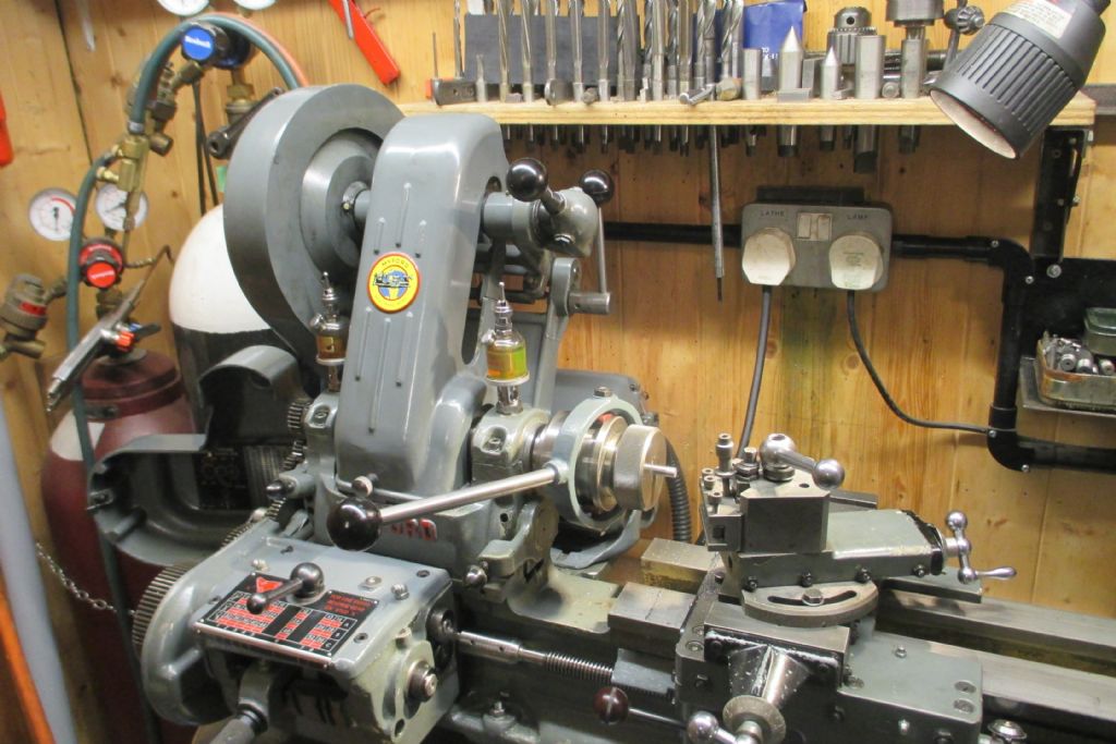

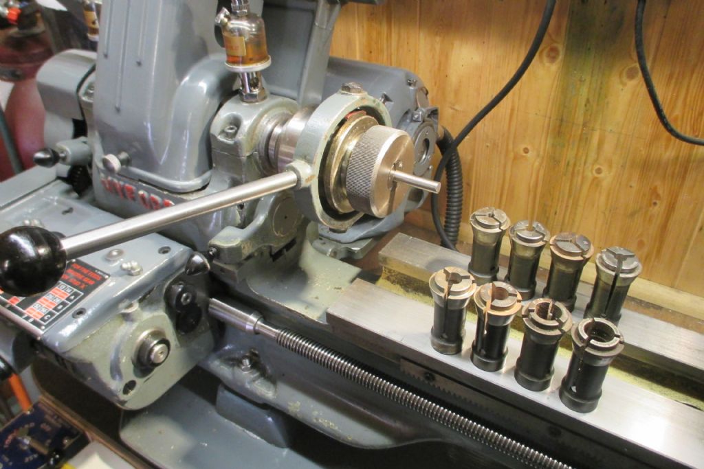

              #203701
              Andy Smith 12
                @andysmith12
                Hi John,
                Mine differs from yours by having two nylon slippers in the chuck groove rather than the brass ring yours has,i think mine is an early model as there seems to be a couple of variants,i took it apart and the ball bearings seem a bit loose,not sure if that's right,it clamps up OK but seems to be on the verge of the lever wanting to come back to the collet open position,like i said earlier i've no idea how to set one of these up and cant find anyone or any info on them.It has a fixed stud to headstock and not the linkage but the outer can float and is not hindered by chuck rotation
                Andy
                #203704
                Andy Smith 12
                  @andysmith12
                  This is the one.

                        #204294
                        Andy Smith 12
                          @andysmith12
                          Thanks everyone for the advice,
                          I finally got the Lever collet chuck gripping tight after machining the backplate to suit my lathe with no perceptible run out,and after a complete strip,clean and re-grease and a bit of fiddling setting it up it works fine,a very handy tool for me as i do repetitive work most times.
                          Eagle eyed viewers will see the 'Bison' QCTP needs a longer locking spindle nut and handle as it fouls the tool-post cam lock nut,i was just trying it out as had been given it free with 4 toolholders about a year ago,i might sell it and get the one from RDG tools as they may not be industrial quality but the tool-holders are more readily available than the 'Bison' make.
                          Andy
