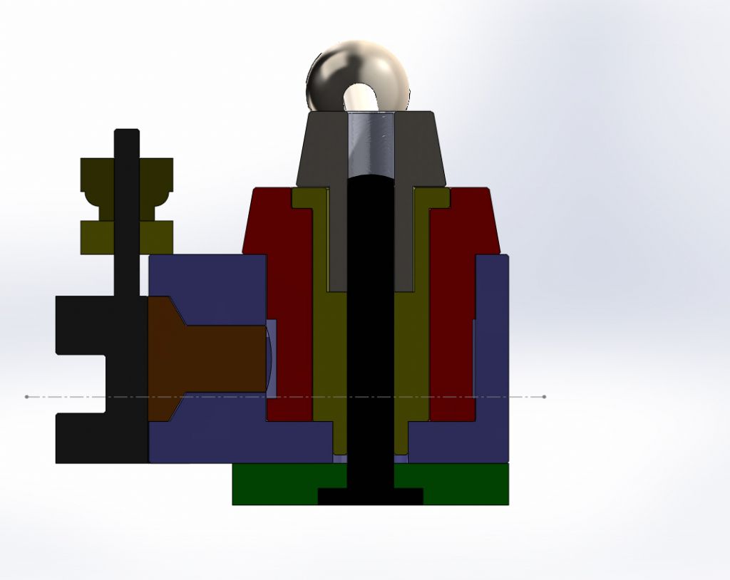

                                    Decided to make a beefed up modified version of nifty/amigos/qctp design to overhang the base and to allow rotation.
                                    If there is anyone familiar with this or having made one. I would like to know if the "fixing shaft" clamps the "body" to the surface. Or if it clamps through the eccentric cam by means of the shoulder on top of the "fixing shaft" It can be done either way. Which is best?
                                    Since this is for the Myford I will post design and build

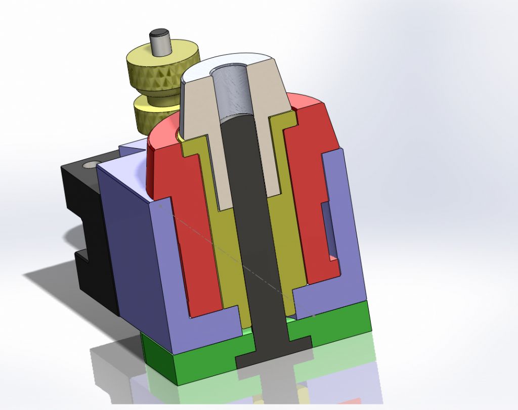

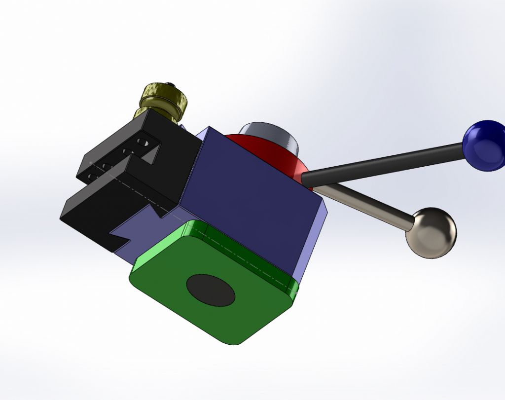

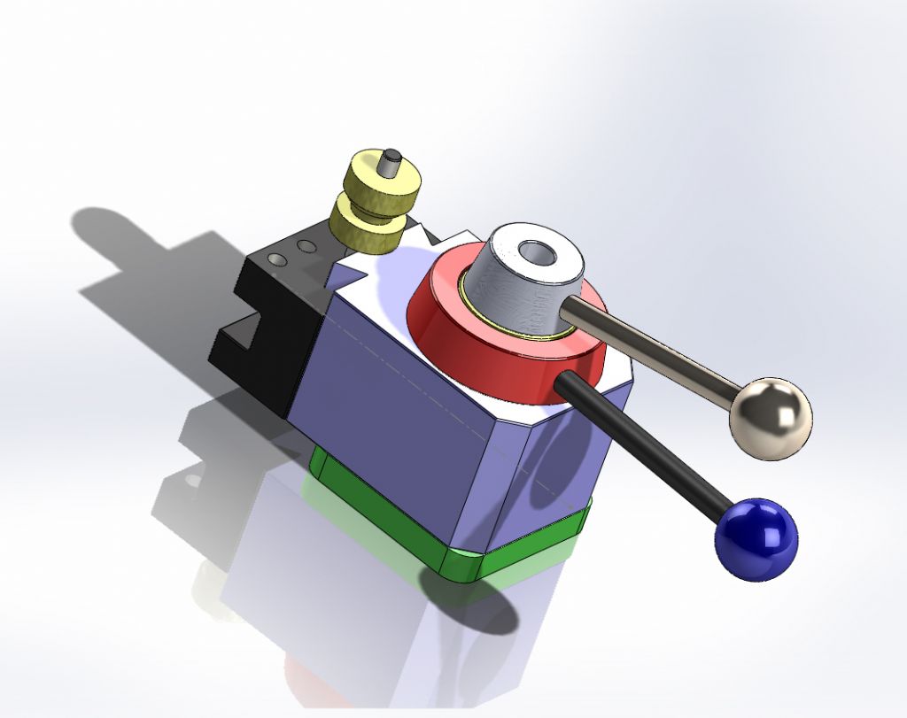

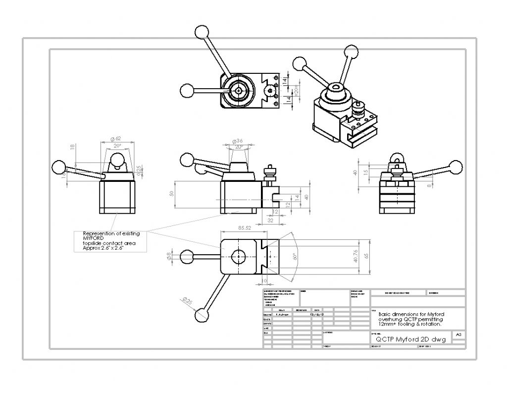

                                      #100736
                                      Rod Ashton
                                        @rodashton53132
                                        I decided to use the "japanese" basis for an overhung QCTP design. The green base represents the contact area of the Myford topslide. (Approx. 2,6"x2.6&quot All toolholders will drop below the top plane of this part and still rotate, until limited by the sides of the topslide. There are many variations that can be made to personal taste. But I publish the basic part and min. dimensions in case anyone else is looking for a similar type of "workaround"
                                        Can offer the 2D and 3D files to any interested party.

                                            Yes I have a crossslide block. It is not QC but the old 4 way rachet type. Pain itb to move it and have not used it for years.
                                            Peter E
                                            I would like to discuss your design with you if possible?
