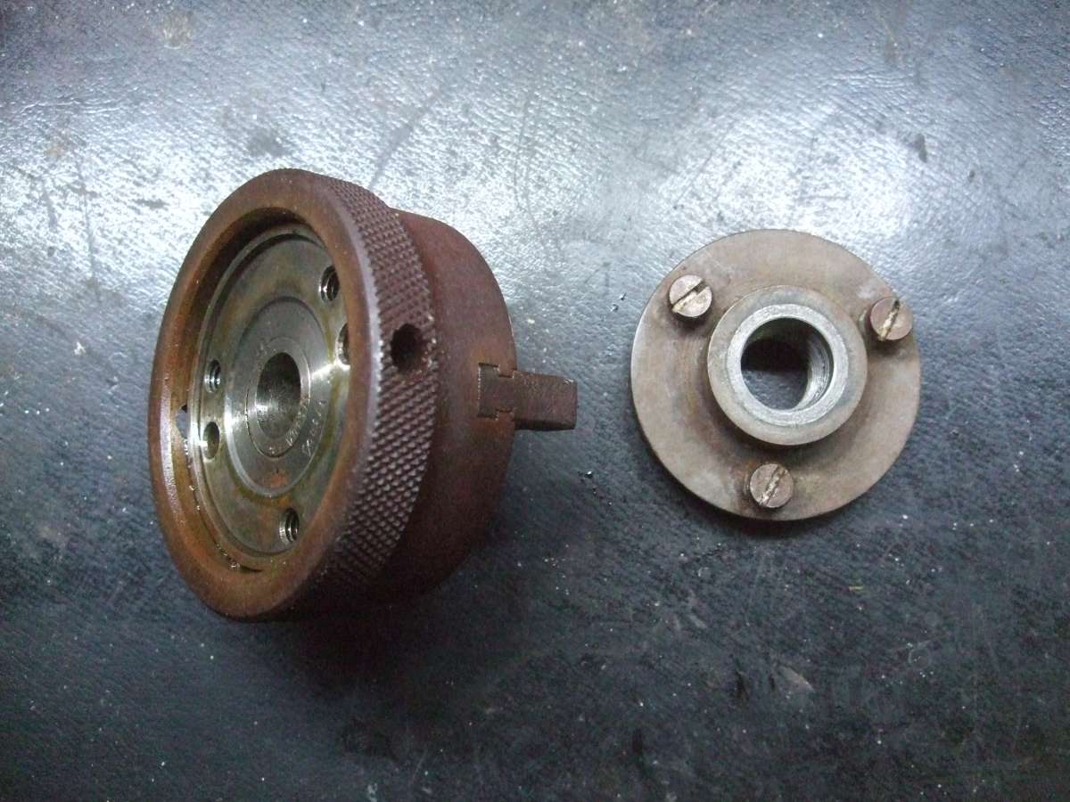

      I bought this lathe after thinking it was like my father’s lathe and that I might learn what my father’s lathe looked like when unmolested.  I later found out that my father’s lathe is a MK1, and this is a type “Major”. It’s much bigger than MK1. Anyway, the chuck: I don’t think you use a key, but use a twist action by hand on the chuck. Of course, things are likely to be a bit seized up. I suppose I must use something on that chuck to free it up. It’s complete apart from the tail stock spindle. I removed the connecting piece between the spindle and the leadscrew.

          This is the chuck. I’ve removed the back plate. I presume I hold the backplate fixed, and turn the outside collar anti-clockwise, to open the chuck jaws. Don’t know why there are holes in the collar on it’s outside.Flexispeed chuck
          #819999
            For tommy-bars

                    ?? you’ve just shown a picture of the chuck. Do you have the second set of jaws for that chuck?

                      The chuck you show is the standard type lightweight scroll chuck, backplate mounted used on most lathes of this class. If you have the two sets of jaws, that would be good, Soak it in paraffin and give it a clean and regrease and sure it’l be grand. In any case chucks like this are readily available from the usual factors.
