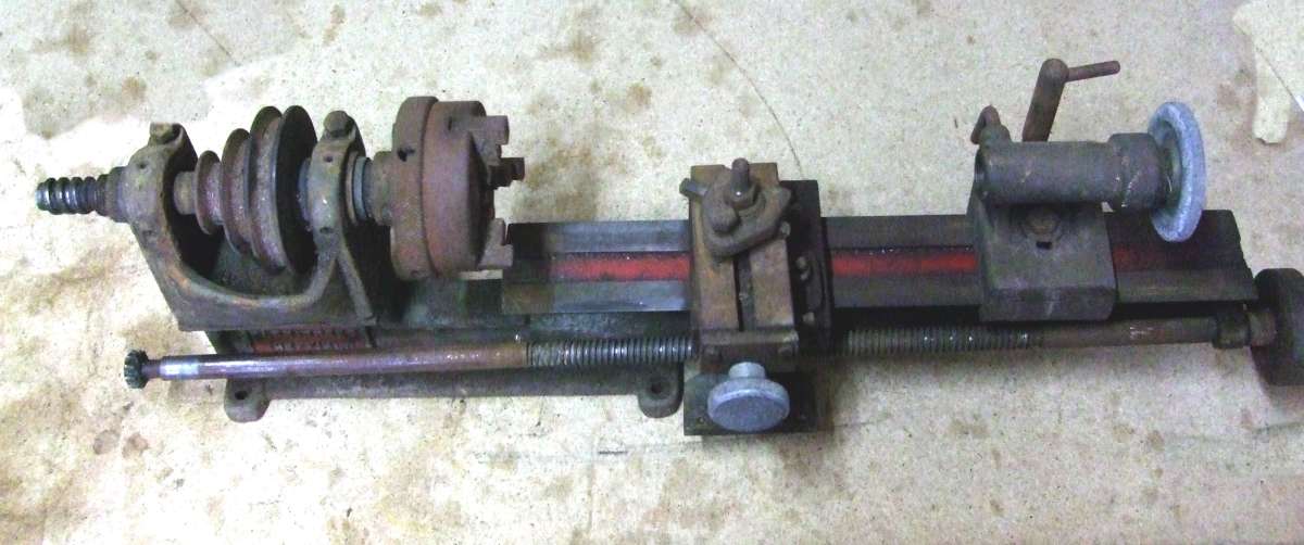

      Hi. Can anyone here identify my newly bought Flexispeed lathe? Thanks.New Flexispeed lathe (3) modified

        Further. I’m wanting to take off the old original parts that effected the turning of the leadscrew and keep them in a box. Then I want to engineer a new arrangement involving a gear train made of regular spur gears. It would be useful if I knew the TPI of the leadscrew. There might be plans somewhere of such a modification.
        #819672
          On richard3267 Said:
          […] It would be useful if I knew the TPI of the leadscrew. […]
          Not trying to be funny, Richard, but that’s a very simple thing for you to measure.

            Why not just measure an inch and count the crests contained. You will probably find it is either 12 tpi or 8 tpi depending on vintage. The later lathes have coarser pitch on leadscrew. See Lathes.co for further information.

                  Are you aware of the Lathes.co.uk site that gives lots of details about Flexispeed lathes?
                  You have a lot of work to do cleaning it up first while reading books on basic metalworking lathes. Then do some plain turning after working out a motor arrangement. Since it is a small lathe most threading can be done with dies and the parts you have removed I suspect are the worm arrangement for fine feed and will serve that function well.
                  When you are finally ready for threading look into 3D printed gear sets as buying your own used 3D printer will be cheaper than an Electronic Lead Screw and either item would be more than twice the value of the lathe.

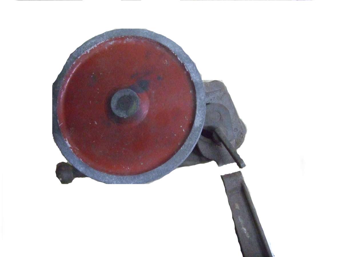

                    New Flexispeed lathe (4) modifiedOK, i think I have a Flexispeed “Major”. Counter shaft is broken.

                              Yes you have a Major with it’s characteristic long foot. The automatic feed is also known as ‘self act’ or just ‘feed’ and because it is continuous it gives a better finish than manual operation so is worth having – hence the provision they made. However it is vital that you don’t lose concentration and let the carriage hit the end or the tool crash into the chuck.

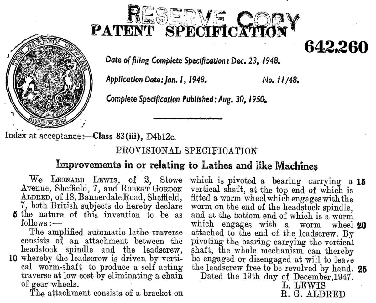

                                    #819862
                                      Although I have never owned a Flexispeed … that drive for the feed has always intrigued me.
                                      Thanks to lathes.co.uk and to Espacenet … the patent is readily found.

                                            The key part of the patent is line 11/12 “traverse at low cost” because at the time the two worms and spur gears must have been cheaper than the large gears needed for the same level of reduction.
