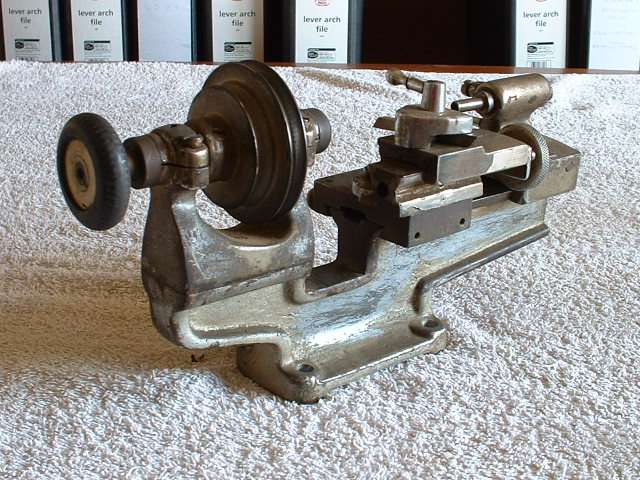

      Hi. My late father’s watchmakers lathe is a modified Flexispeed lathe. It was modified either by my father or soneone else prior to it’s acquisition. I’m not sure what the model is. I atttach pictures.Flexispeed 01

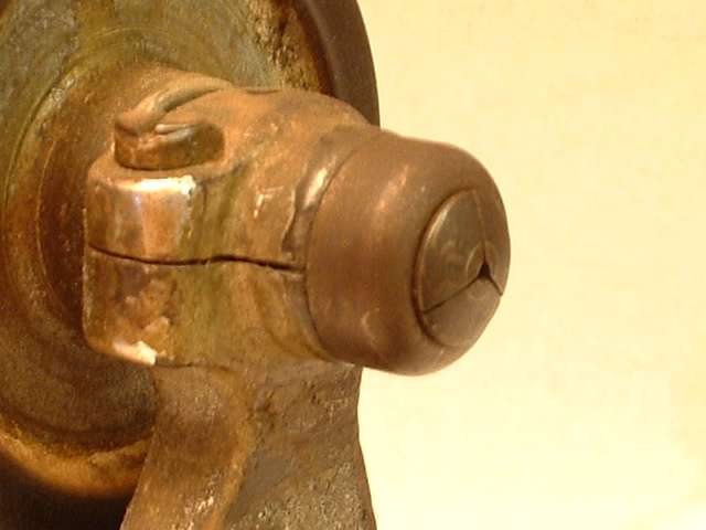

        It was modified to hold collets:DSCF0003
        #818873
        Bazyle
          @bazyle
          An interesting modification to this early Mk1. When you have released the collet look closely into the bore and see if it was recut to accept the collet or has an insert as used on some small lathes.
          The lack of leadscrew and seemingly short bed if it is not a photographic perspective effect leads me to wonder if it was damaged and sawn off short. The body from the gap to the right hand end should be 8in.

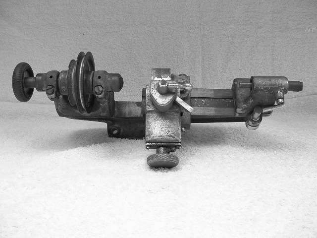

            Hi. The bed is definitely truncated.  The wheel on the left, is from a toy car that I had in the 1960’s. Dad bought an Expensive Bergeon lathe, then later sold it and went back to the Flexispeed.Flexispeed (2)
            #818916
            Bazyle
              @bazyle
              The tailstock is on backwards and also modified, probably to get extra length between centres.

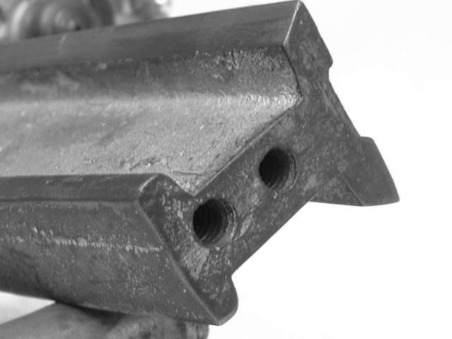

                                You know, I’m not entirely sure that this MK1 lathe is truncated. Here is a picture of the end of the bed. I think something to do with a leadsrew attached to the end, using those screw holes.Flexispeed (10)

                                        Looking at the latest photograph, no I don’t think that lathe has been truncated, either. That looks like an as-cast surface, not sawn or machined.
                                        The two holes may well have held part of a leadscrew arrangement, perhaps as an accessory, but if so I am surprised there is no machined seating around them.
