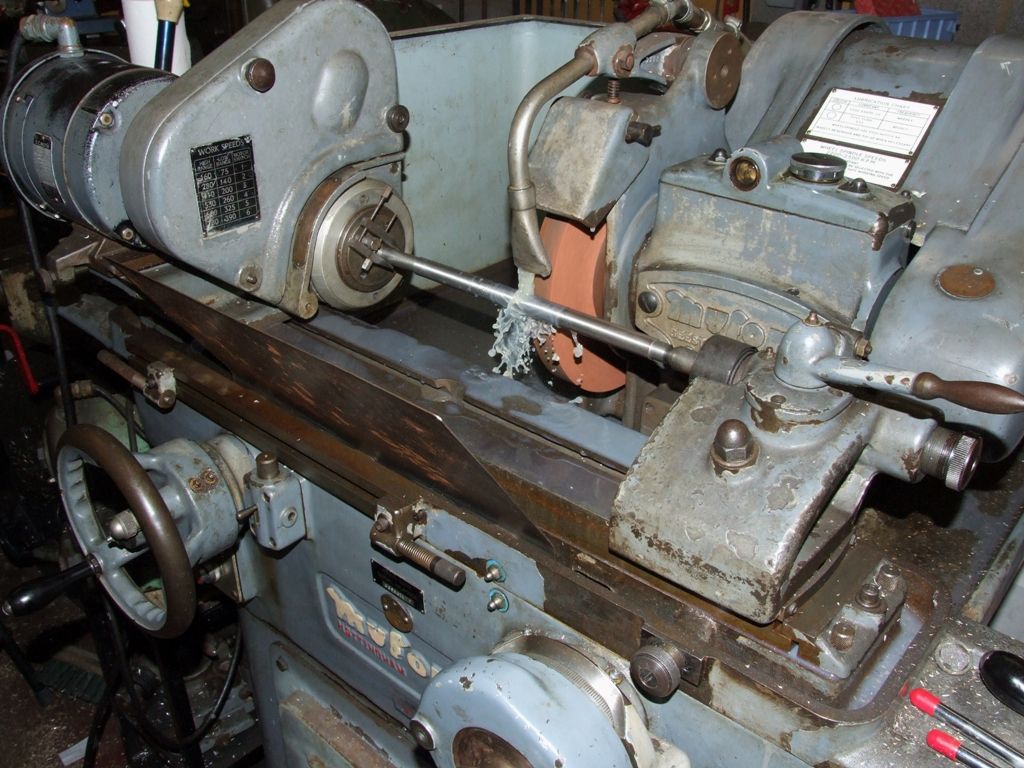

                                I don't get hung about stock tolerances. Out of interest I've just measured some offcuts of 3/16", 1/4", 5/16" and 3/8" steel rod, all are between 1 and 2 thou undersize. That is perfectly acceptable for most applications with a reamed hole. Bearings need a gap for the oil film to work properly.
                                Tolerances are only of concern to me for precision stock, mainly silver steel and gauge plate. A couple of pieces of silver steel measured 0.03mm undersize.
                                If I really need accurate and straight then I grind my own, but a pretty rare occurrence:
