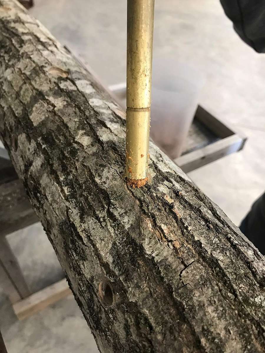

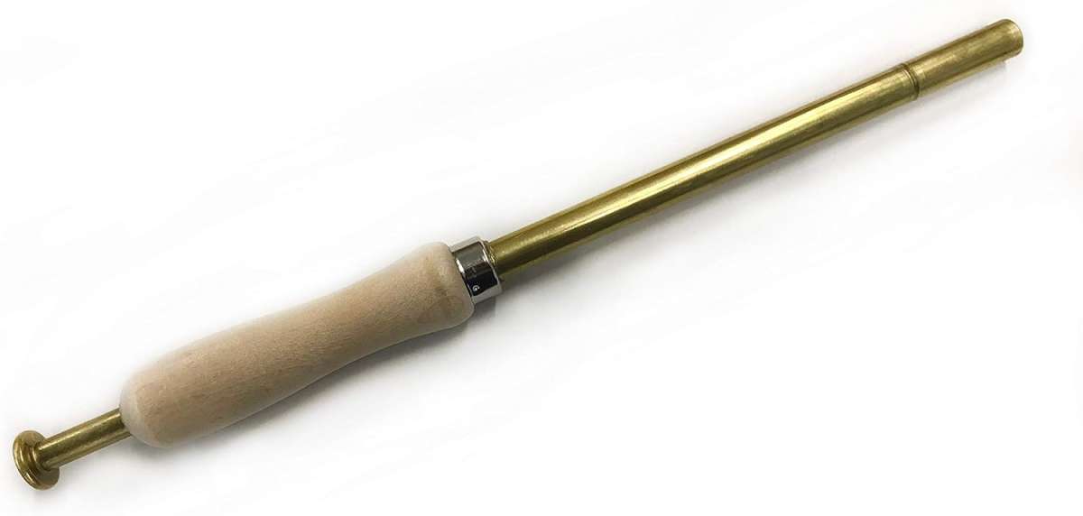

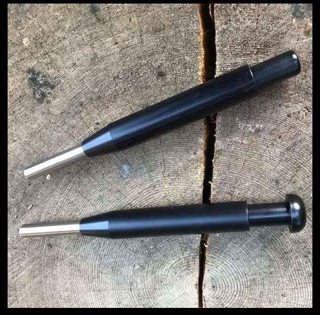

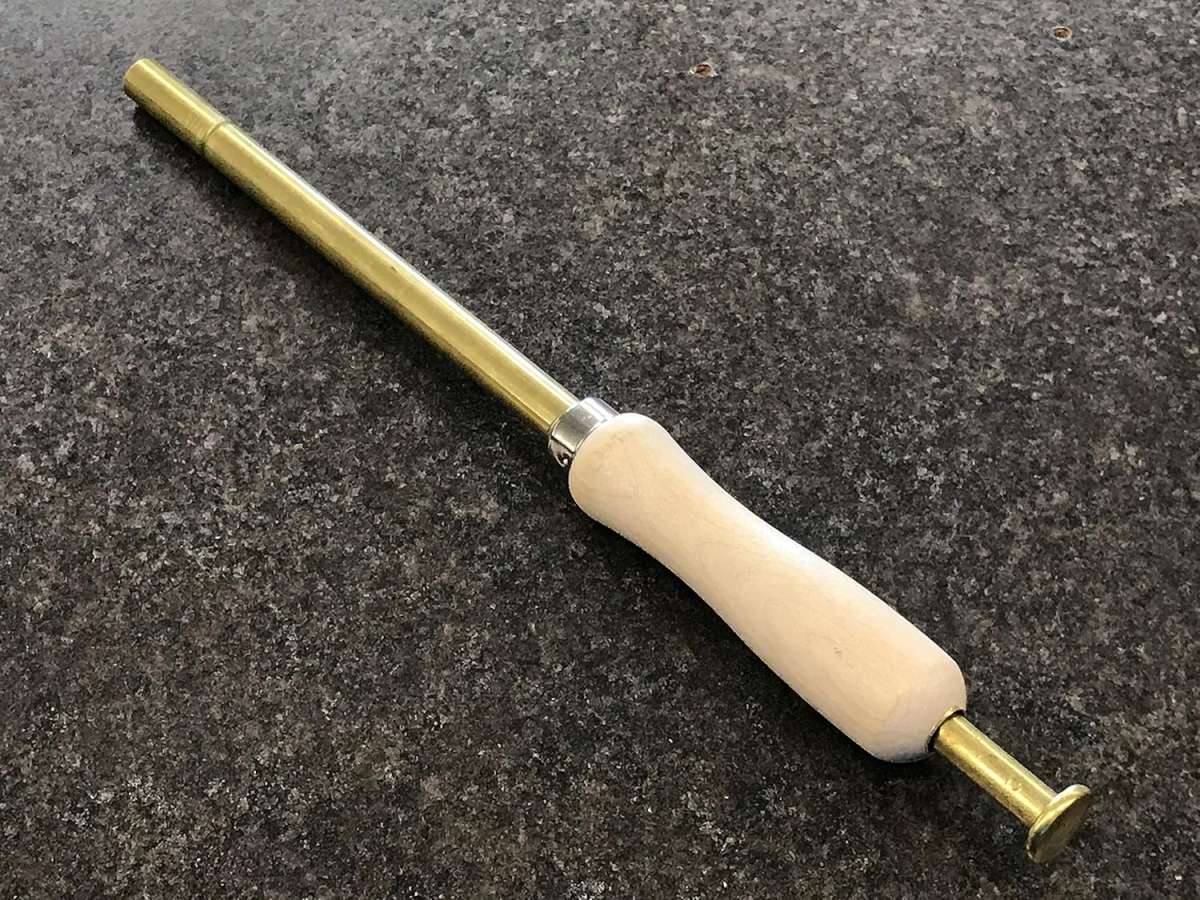

      Please excuse me if I’m unknowingly crossing any forum rules here, but I’m in need of someone in the UK to manufacture a number of what is known as a mushroom log inoculation tools. Photo attached.
      Model engineering or machining is not my remit, and I’m struggling to figure out where best to turn, or what even to Google, so I figured a community of engineers will likely be able to help point me in the right direction, I hope.

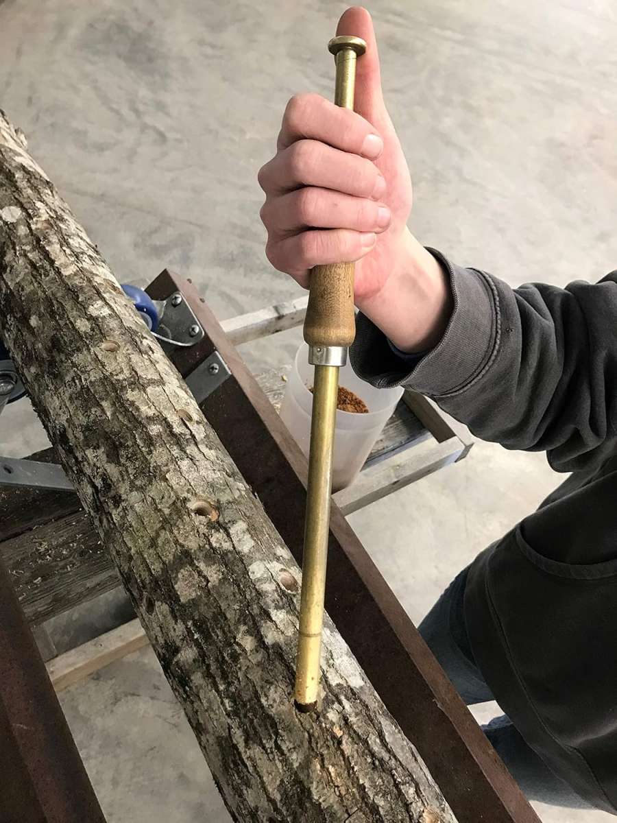

      The tool is very simple in nature; it’s a thumb/palm inoculation device consisting of a few parts.
      Tool in action: https://www.youtube.com/watch?v=Iw2BtznC4Vk

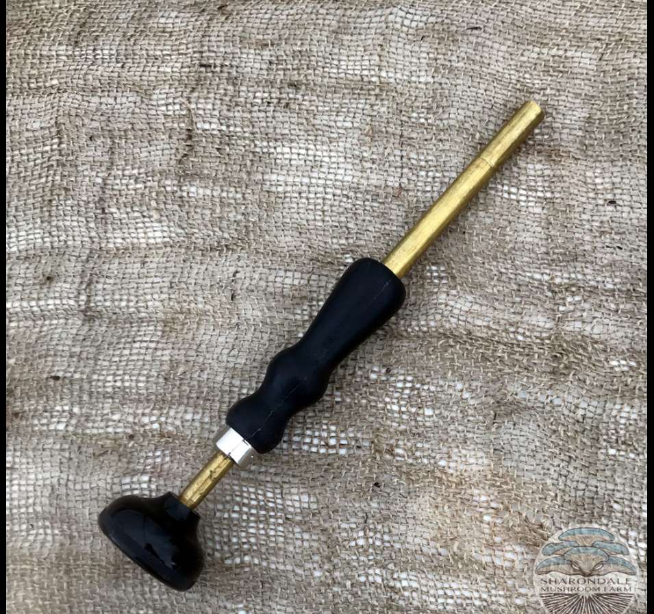

      Thumb Style: https://www.fieldforest.net/product/Thumb-Style-Brass-Inoculator/inoculators
      Palm Style: https://www.fieldforest.net/product/Palm-Style-Brass-Inoculator/inoculators

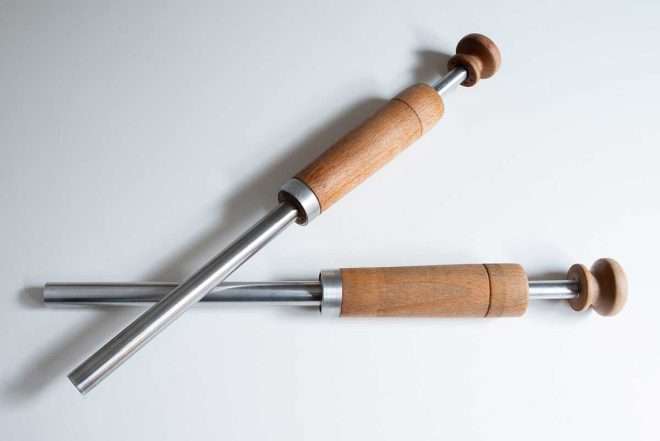

      Metal Style one: https://growmushroomscanada.ca/shop/growing-supplies/log-tools/inoculation-tool-for-sawdust-spawn/
      I’m trying to find someone who would be happy to make these up for me so I can use them and sell them to our customers. If I had the time, and a lathe, I’d love to get involved and learn how to do it myself, but sadly, I don’t, so figured I could pay someone who does…?
      Is this something someone out there (based in the UK) might be prepared to do? Ideally someone who already has experience in doing similar work. I have a few inoculators here with me of just one style and can post one to someone who might be interested for further analysis, if needed?

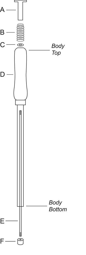

      Internals are a spring which is pressed up against a brass washer (held against an indentation in the brass pipe), with a threaded brass rod passing through, on the end there is a threaded brass tip/plunger a fraction smaller than the internal diameter of the pipe. Similar to a syringe, with a spring for rebound. Super simple.
      I’m not sure how many I will need in the future, but think a run of 50 of each type (palm & thumb) might be a good starting point, could potentially end up selling hundreds of them. A wooden handle would be nice, dipped in oil or waxed on the lathe. I don’t see why it couldn’t be an ongoing gig for someone who’s interested?
      Can be made out of brass, or I guess stainless steel which I also like. Thanks in advance to anyone who can help, and apologies if this is not the place to put such a post, if not, feel free to move or delete it.

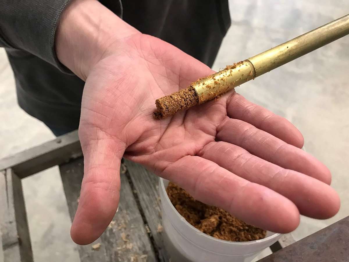

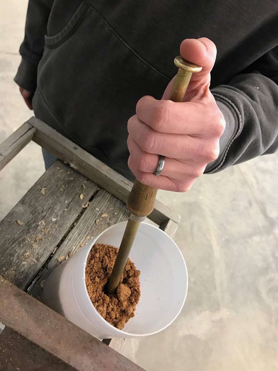

                      I wondered if the Lakeland versions might be a little broad for the application. From the pictures it looks as though the stuff injected is fairly dry and I question whether that aspect is important.
                      Cheap plastic syringes without needles could easily inject a sloppy wet mix through a predrilled hole. I’m sure they can be found on eBay.

                        Past experience would suggest that a wet mix of sawdust in a syringe would not work…the water phase getting squeezed out preferentially and the residue gumming it up.
                        It’d be easier to find an addition that would allow the creating of mini sticks that could be dropped into the drill hole and a soft wax thumbed in to seal.
                        If the drill hole diameter isn’t critical then say an old style cigarette rolling machine to form sticks? And cut into lengths.
                        #760848
                          A syringe with the end cut off so you basically just have the outer “tube” and the plunger would just push it into the hole, better than trying to get it through the reduced end which as you say will squeeze out the water first.
