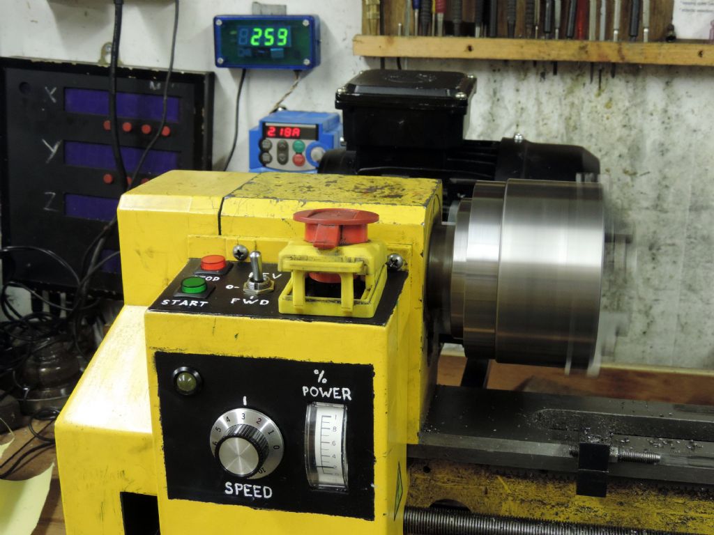

                                  Posted by Muzzer on 18/10/2015 09:44:45:
                                  Measuring the real component of motor current and voltage (and hence efficiency) when driving a motor from a VFD takes very expensive equipment due to the high frequency switching voltages used. You need a very high sampling frequency and deadly accurate measurement sensors. However, placing a standard 50Hz power meter on the input of the VFD will give a pretty good measure of the input power. The losses in the motor are much higher than in the VFD but you don't need to know how the losses are spread between the motor and VFD.
                                  Very true, but any VFD worth its salt will have that electrickery inside it and be able to tell you its instantaneous output power. I have mine driving a little analogue meter on the front of the lathe so I can see exactly when and by how much I am overloading the poor beast.
                                  Mini lathe with power readout
                                  Worth nothing, though, that the brushed machines in this debate don't have VFDs, they just have PWM DC drives.
                                  Edited By Neil Wyatt on 18/10/2015 10:08:24
                                  #208317
                                    Neil,
                                    I'm disappointed to see the scaling on your % POWER meter.
                                    … Would have expected it to read to 110% devil
                                    #208318
                                      The Marshall Lathe
                                      To be honest, I can't remember how its calibrated blush, FSD is over 100%, as that is the continuous rated power and it can deliver more than that, but FSD might be 150 or 200% – I will have to check the scaling some time…
                                      <edit> Just read my own article: "There are two indicators, a yellow LED showing the inverter is live and a power meter indicating 0-10, 5 is 100% of nominal power."
