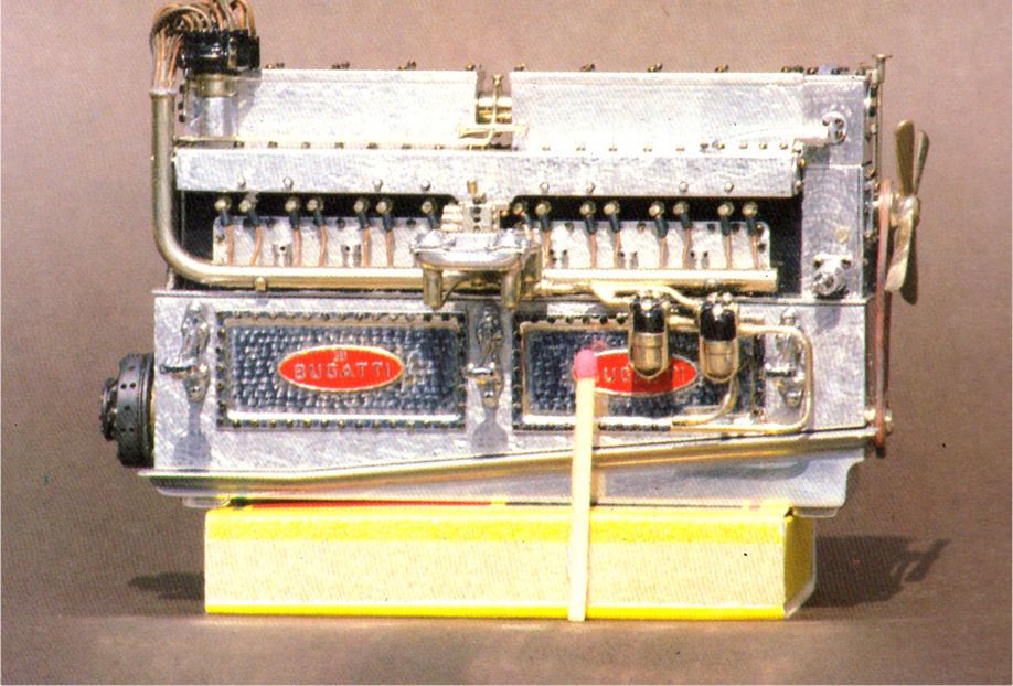

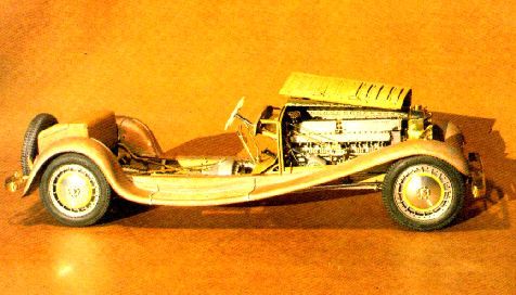

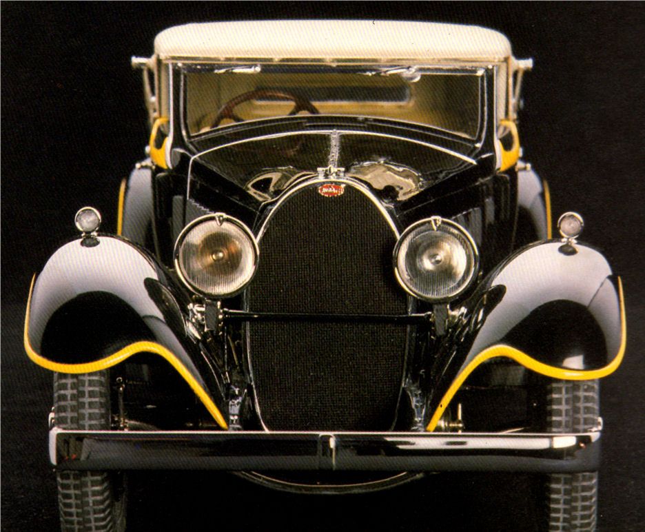

          I don't know of a source of these wheels commercially but the bible for this kind of work is Gerald Wingroves book – The Complete Car Modeller 2. It chronicles the build of his model of a Buggatti Royale. He describes how to make wire wheels, individual tyres and how to form complex body parts in copper and brass. It's worth getting in my opinion. The books 1 and 2 are usually available from libraries on inter-library loan if not in your local.
          Here's a couple of scans from the book. He models all parts of the car accurately as far as possible including the engines external features to exact scale.
          Engine
          Finished model

                  Hi Mike,
                  That would be very nice but unfortunately they are not working models, at least as far as the engines are concerned.
                  Regards
