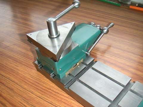

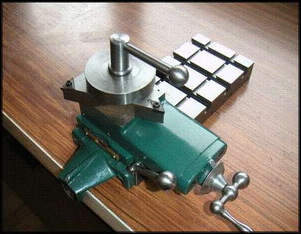

      I add these pics to show  my modifications for a Myford cross and  topslide. I have described this before in the MEW mag.
      Picture4Myford ML7 2
      The photos show a Myford topslide modified  to be a Lever  Locking topslide on a modified cross slide with two shallow vee groves running  the length of the cross slide. The  topslide can be moved  and rotated to  any angle anywhere on the cross slide and  locked by the  side lever.
      Alan
