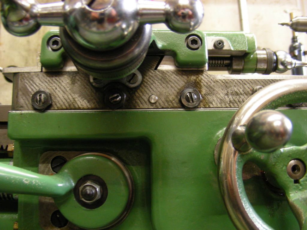

                    If you are removing the saddle then it's not much more work to remove and service the apron too. You could then take the opportunity to install a dowel to the gib. Here is mine:
                    Also visible in the photo is J A Radford's swarf-excluding ring on the half nut handle.

                      Thank you for that tip Ega – I'd not realised the handle can let swarf in.
                      Could be why that on my ML7 is sometimes very stiff and uncertain in action. (I know how it feels…)
                      However I have also found its stud tends to work loose in the casting, and that won't exactly help it work smoothly either.
