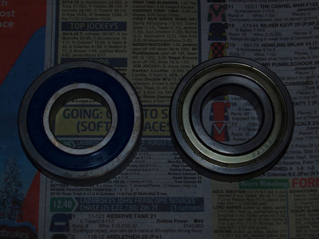

                            I have bought a 100mm chuck (on special offer at the moment from Arc Euro Trade) and a pair of angular thrust bearings, which I hope will stiffen up the spindle, and a new spindle with the flange which takes the 100mm chuck. Big thank you to Arc Euro Trade which sent out the parts for next day delivery and Simon at SPG Tools who supplied the spindle and was most helpful.
                            I was pleasantly surprised when stripping out the spindle and bearings: after reading a lot of negativity about the quality of workmanship on the mini lathe, I found that the parts were pretty well made, although not awe-inspiring like some engineering, the parts are solid and certainly of acceptable quality. I had expected the Chinese bearings to be shot after about fifteen year's use, but both spun perfectly smoothly and with no trace of play, so in future I will have no hesitation in buying Chinese bearings.

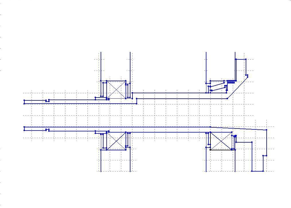

                              Can we see pictures of spindles side by side and bearings?
                              It will then be possible to construct the ultimate mini lathe spindle and I will be rich on saturday.
                              Something along these lines

                                The bearings are available from Arc Euro Trade and are a direct replacement for the standard ones. I'll try to post some pictures.

                                                    The top picture shows the new angular thrust bearing on the left, old ball race on right. The lower picture shows old spindle at the top, new at the bottom.

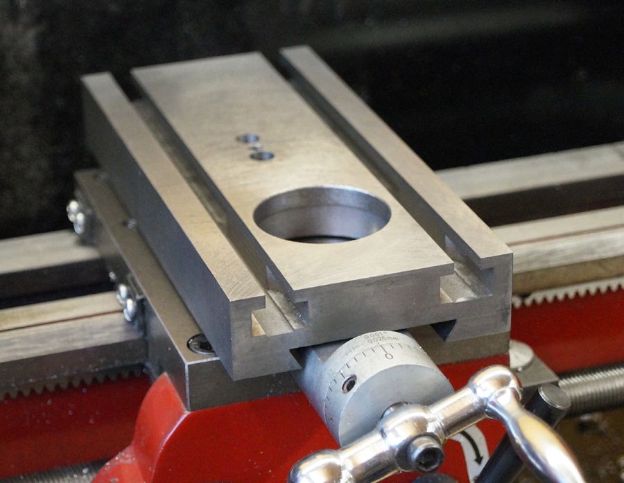

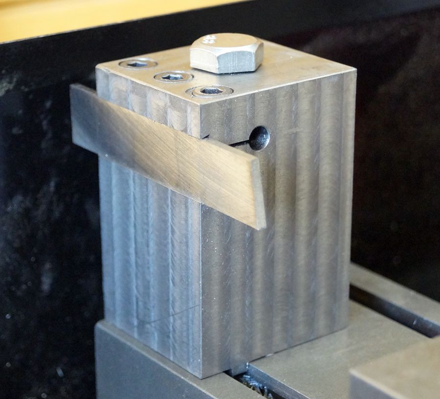

                                                      I've been busy doing a few more jobs on the lathe to try and improve it. A few days ago some play developed on the cross-slide area, which I traced to the saddle; on closer inspection one of the saddle shear plates had fractured where the grub screws are fitted. Those who have fiddled with this abomination will know, and those who have yet to do so will find out, what a stupid bit of design this is.
                                                      I found that the rear plate was very close to being right without the grub screws, so used pieces of 15thou shim to take out the play, but the front shear plate needed a lot of shimming, which was going to be very difficult to get right, so I found that a small spring washer sandwiched between the plate and the saddle was a perfect fit, so replaced the three Allen screws with small studs, fitted spring washers over each stud, replaced the plate, and fastened it with nylock nuts. Then using feeler gauges, was able to tighten the nuts evenly until the saddle was a good fit over the bed. While the lathe was apart, I also made a cover to go over the handwheel gear housing.
                                                      Lastly, I have made a swarf tray that fixes to the saddle, to keep chips away from the leadscrew and lathe bed. You are never bored when you have a mini lathe.
