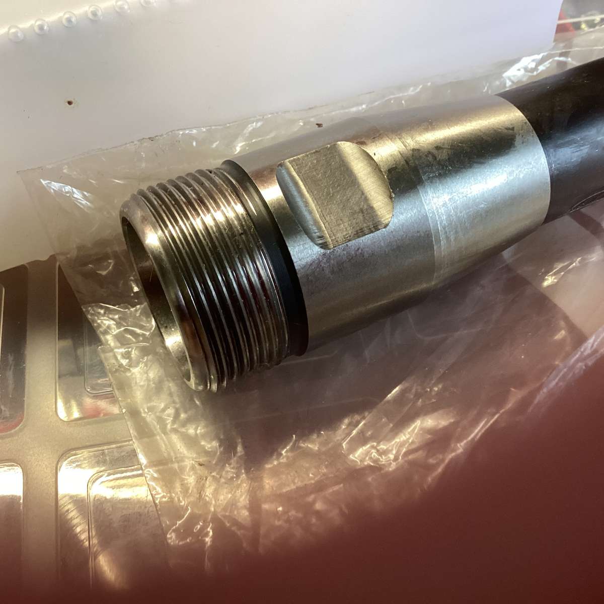

                              I had an ER25 chuck from Arc with no flats. I tried a strap wrench initially and then a pin wrench. These worked, but the first wasn’t very convenient and neither allowed adequate torque to be applied in some cases.
                              So I milled flats using a carbide end mill held in a direct collet. I seem to remember I tried with HSS first but it didn’t sound good so I moved to carbide.
                              IMG_1413

                                              #823465
                                              andy198712
                                                @andy198712
                                                Just to follow this up.
                                                10mm arc carbide endmill cut it fine!
                                                it was 50mm dia so made the flats 42mm which means I can use the pin/open wrench that came with the mill.
                                                probably make a 42mm tool at some point
