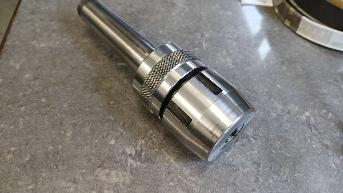

      @beardymike
      I’ve got an R8 spindle in my mill, along with a couple of Er32 tool holders, drill chuck etc.
      Sometimes it would be convenient to have a bench fixture to put tools in/out while not in the mill. Bench fixtures to do this seem to be common for iso taper holders, but more elusive in R8.
      Rather than making my own from scratch it’d be much easier to start with something containing a socket already. Does anyone have any suggestions of the best source? A replacement spindle would work, or some kind of adaptor; I’m just a bit overwhelmed by how many options and nothing obvious seems to come up from a quick Google.

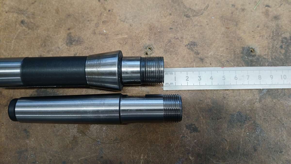

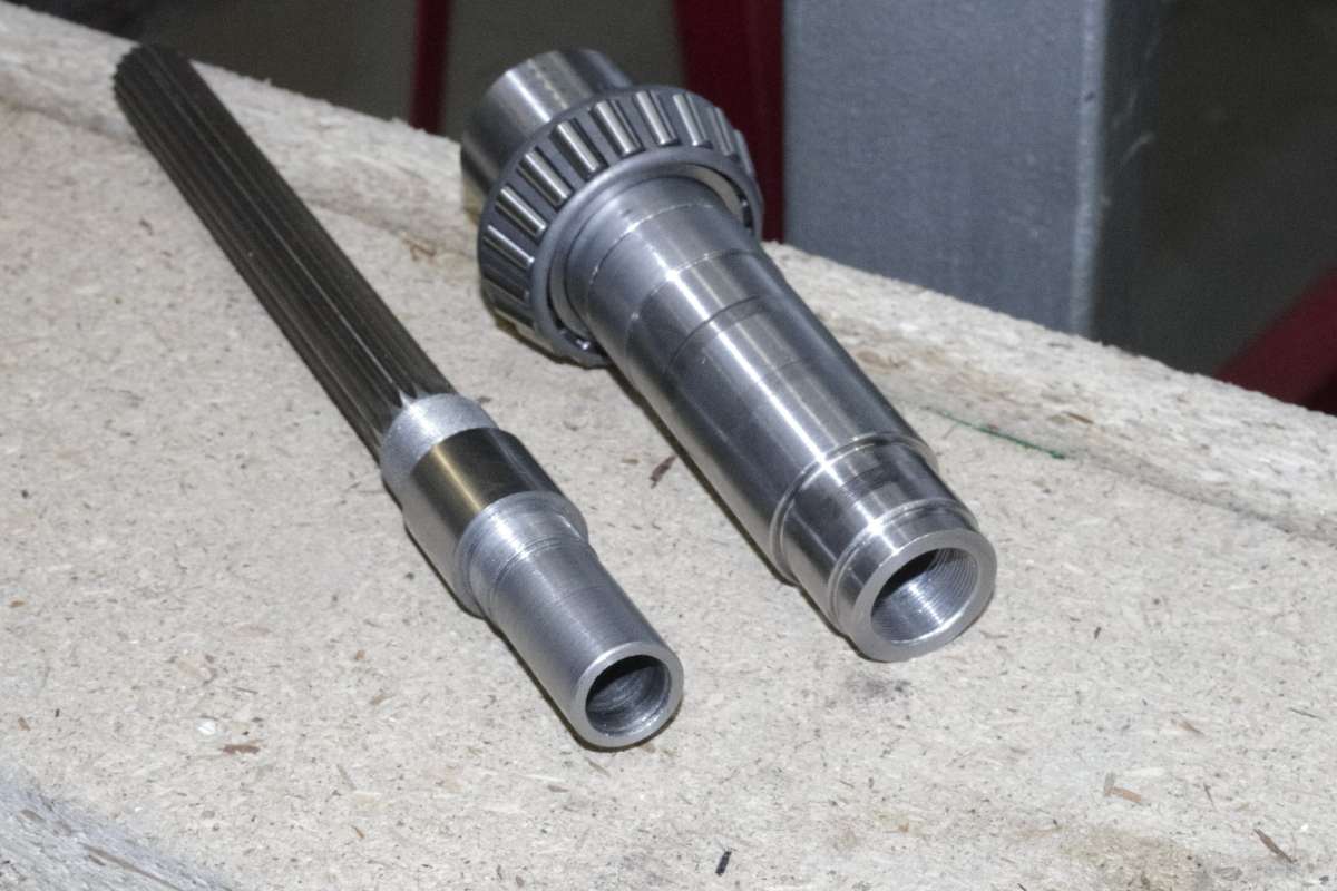

                I bought a short R8 spindle from ARC, a spare part for one of their mills. It has been running in the Tom Senior light vertical for years now married up with the splined original top half. check their machine spares, they are not very expensive.
                https://www.arceurotrade.co.uk/Catalogue/Machine-Spares/SX2LF-Mill-Spares/SX2LF-115-Spindle
                _IGP2435

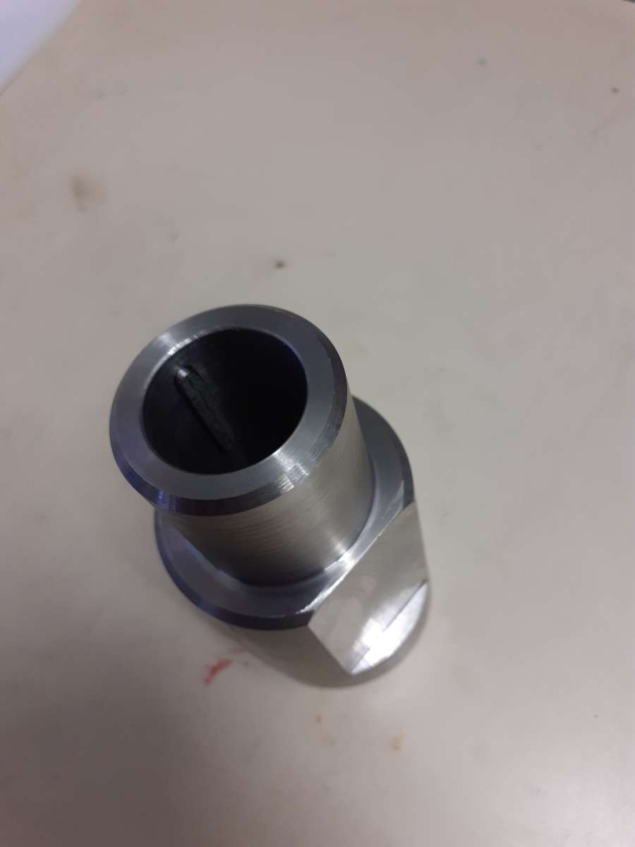

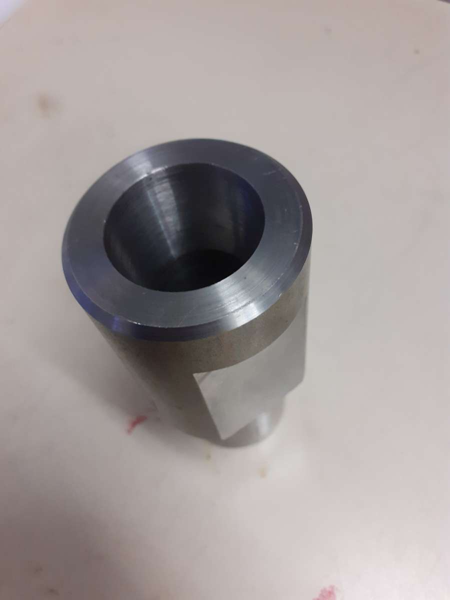

                    If you do decide you have to make one, it’s not too difficult. I finally got sick of struggling to tighten the ER collets when there are no flats on the chuck, and made one a couple of weeks ago.
                    For the key I milled a 4mm wide slot through the side and glued in a bit of 4mm gauge plate. I felt that would be stronger than just a pin.
                    R8Holder02R8Holder01

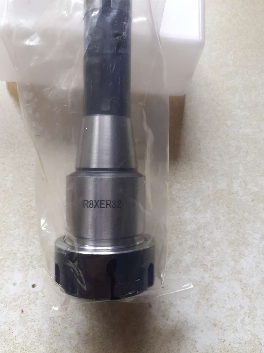

                          @iant
                          “Simply unbelievable that some ER collet chucks are still being made without those”
                          Given the R8/ER32 chuck that I’ve just purchased seems to be one such (e.g. no spanner flats on the body) – is there a good reason for this lack? I’m thinking of calling the (UK) supplier and returning it – as it doesn’t seem usable without them…??
                          Regards,
                          IanT

                                            I can’t see from the photos what the spindle locking arrangements are on my new mill but as it will be here Friday, I will wait till then and see what I have available to stop the spindle rotating. If it’s got tommy bar holes, I suppose I could make a ‘C’ spanner for it…
                                            But frankly, I’m still puzzled why they would make the chuck without ‘spanner’ flats.  The ‘body’ of the chuck is 1″ long, so plenty of room to do.

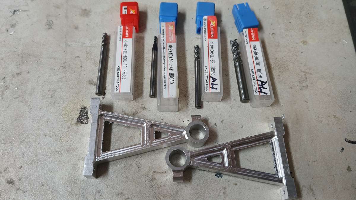

                                                It is hard to expect a supplier to take something back just because a user feels it is not fit for purpose when other people have managed to use tham without a problem. The ME trade have been selling holders without flats for years, if they are all NFFP and got sent back they would have stopped importing more long ago.
                                                Couple of parts I machined last week. Two identical items, machined on both sides. 4 cutters used per side so that is 16 cutter changes, two more if you include drilling and tapping the tooling plate. Fit enough for some!!
                                                As I said the shorter distance is a bonus as far as I’m conserned and why I bought that one as it was listed with a short gauge length.

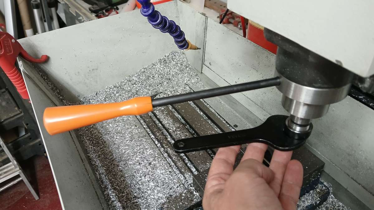

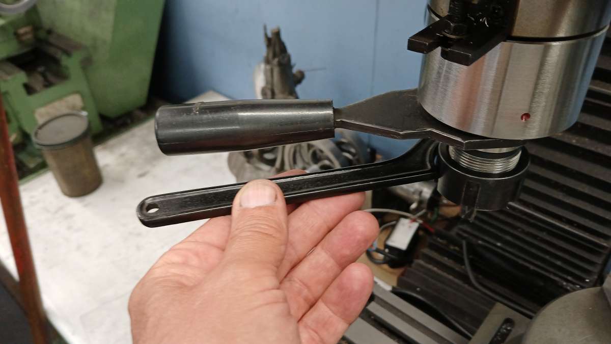

                                                    For Ian. This is the arrangement on my two R8 machines. Relly no different to putting a spanner around the chuck flats if they had them.
                                                    KX-3, supplied bar with my added plastic handle
                                                    20250719_134053
                                                    SX2.7 supplied spanner with a slight modification as per my MEW article. In both cases no need to go reaching upto the top of the machine and I quite often use the SX2.7 seated
