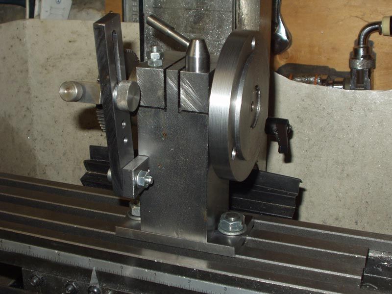

                Right then. I’ve done all the basic stuff and I now have a home made clamping set and I’m dead chuffed so no laughing . I made a few mistakes, but I know what they are.

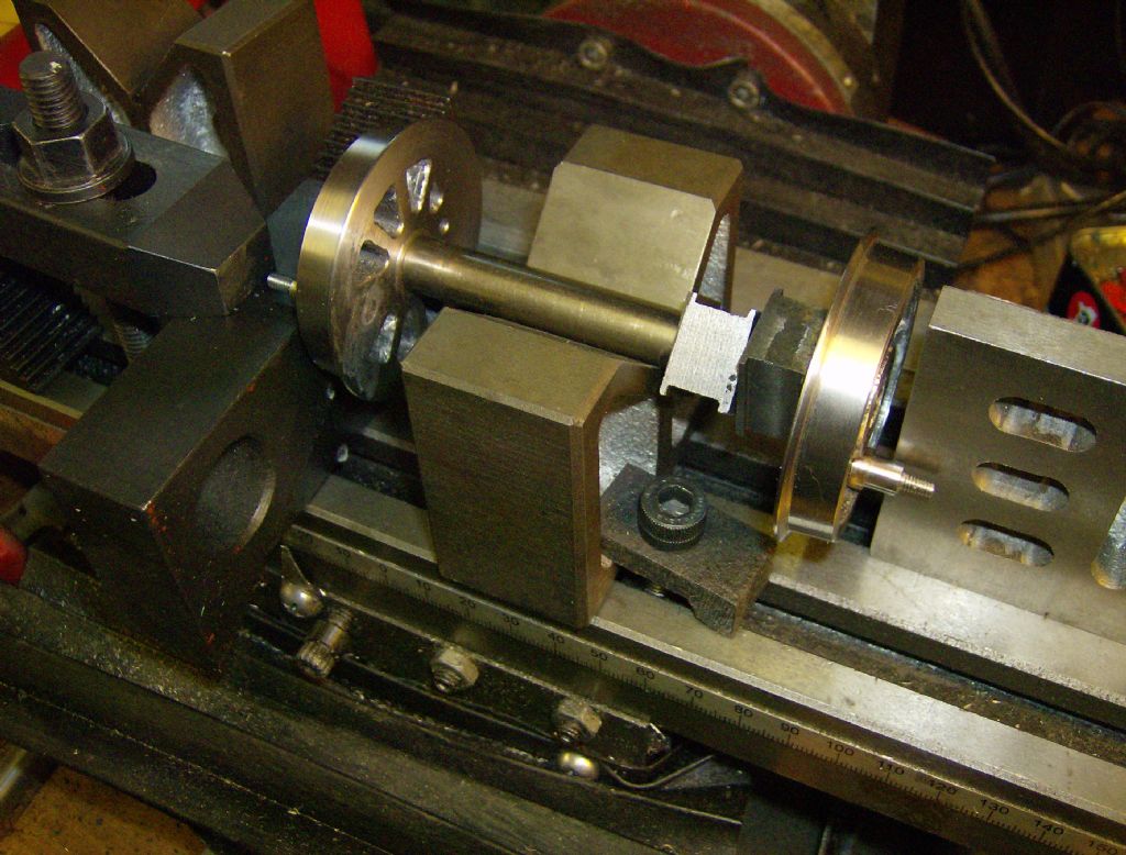

                                        Nice to see some pictures of your work Wolfie.
                                        Here’s some ‘interesting’ clamping – a temporary jig for quartering loco wheels I set up today:
                                        You can see the HUGE size of a ‘standard’ clamping set with M10 studs at left – the clamp and three packing blocks fill about a third of the mill table! The wee clamp holding teh V-block in place has a single M8 screw holding it (my home made clamps aren’t quite as pretty as yours – this was just a slice of a suitably shaped bit of scrap malleable cast iron with a hole drilled in it) and the angle plate is held by a single M6 screw.

                                          You mention Wolfie that you are making the Grinding rest prior to the boring head and dividing head but are concerned about needing the earlier items to get the experiance. It is though more a case of needing the first item to make the second.
                                          However, whilst the dividing head is required to calibrate the dials on the grinding rest, this is far from essential and can be used easily without calibrated dials. Tool and cutter grinding is done at very small depths and the calibration just helps to set on such small amounts. They can of course be calibrated later or use the method I suggest for the boring head, see Sk2 on page 56 and the text on page 57.
                                          The boring head is though required to make the dividing head as there are some large holes to be bored that will probably be difficult to do on the lathe unless you have a larger one, somewhat larger than a Myford that is.
