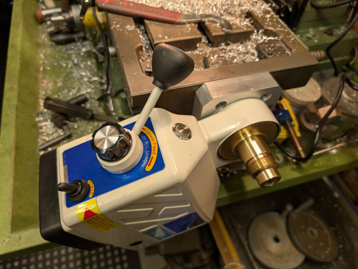

          I fitted one of the cheap flea-bay power feeds to the X-axis of my Warco GH Universal mill last winter – it’s been used a lot and so far I’ve been more than happy with it.  Certainly takes the boredom out of fly cutting and speeds up squaring the vice!
          It came complete with limit switches and everything worked perfectly out of the box.

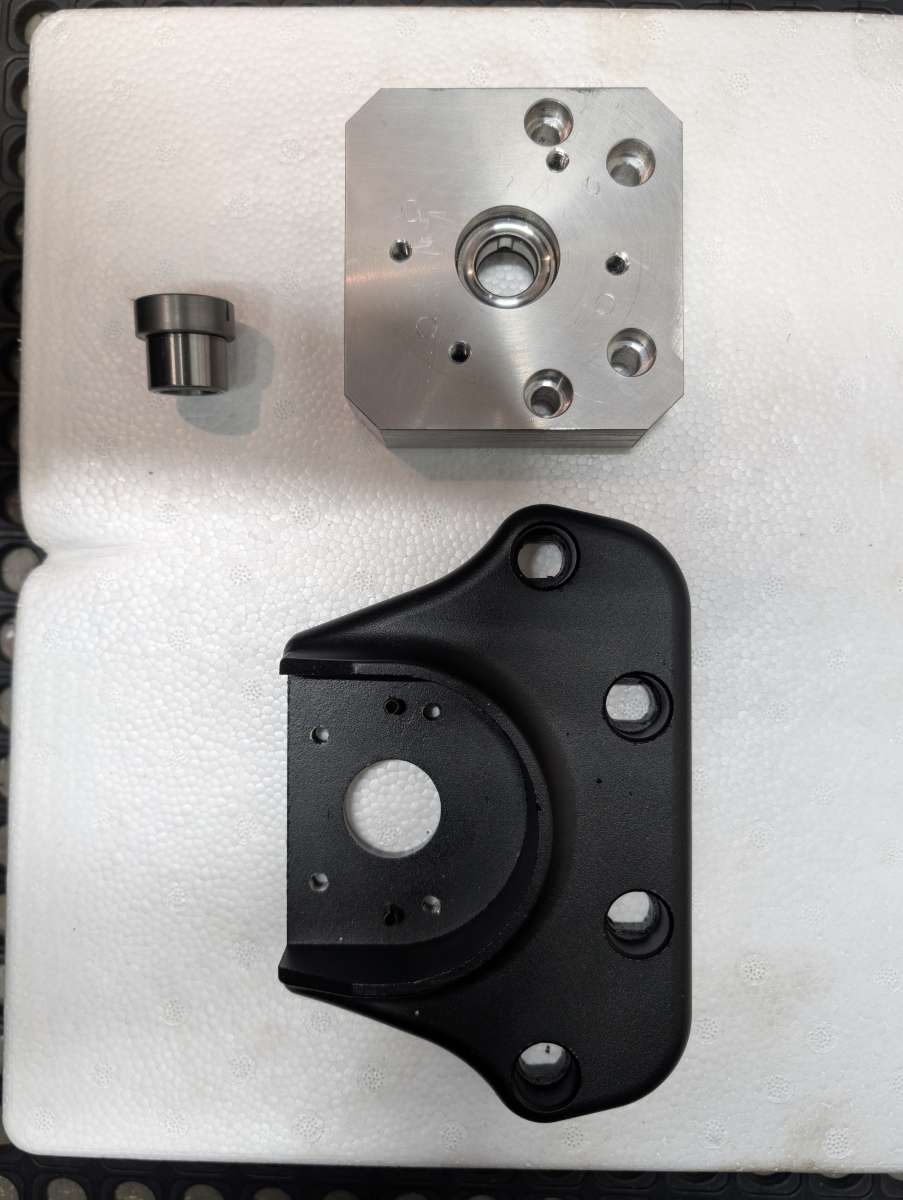

          Being probably designed for a Bridgeport clone a few modifications were required to adapt it.  The only tricky bit was milling the keyway in the leadscrew for the drive gear because once I removed the leadscrew I no longer had a functional milling machine!  Fortunately I was able to borrow a friends machine to complete this.
          First thing was to make a new mounting plate to replace the cast one supplied, I incorporated the thrust bearings as used on the original leadscrew support.
          PXL_20250215_143009249
          I mounted it at an angle as shown to clear the swarf tray. In use this works very well as the controls “fall readily to hand”

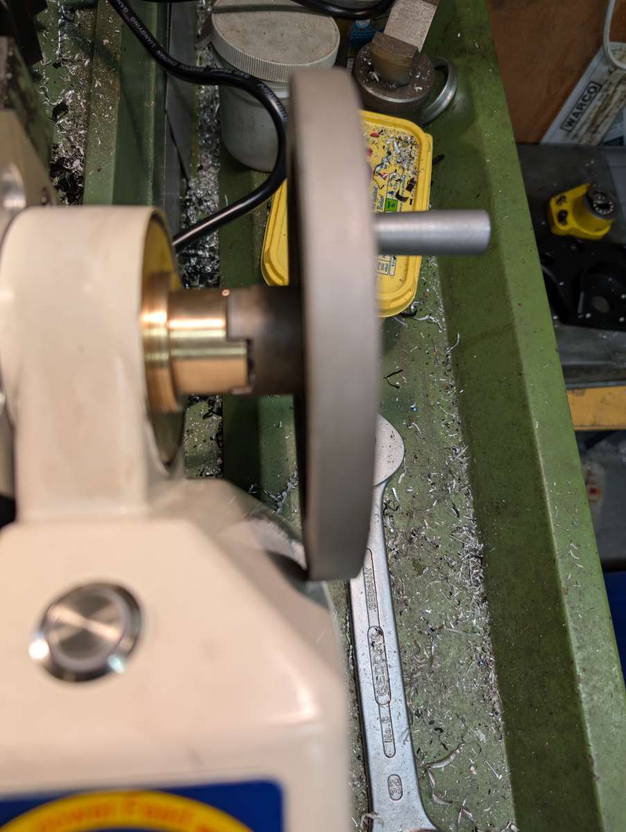

          PXL_20250216_121954637
          I also had to modify the bronze drive gear to enable the handwheel to provide drive, and chamfer the handwheel itself a little to clear the drive unit.
          PXL_20250219_124522310
