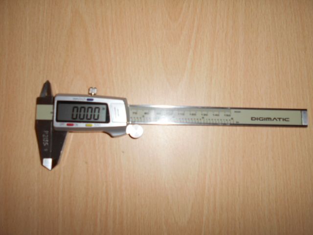

                                      BOB BLACKSHAW 1
                                        @bobblackshaw1
                                        dscn1130.jpgTried allsorts of batteries with no success, but this works a treat, tried and tested.
                                        Bob
                                        #436130
                                          Nice big display too, Bob
                                          … Every cloud has a silver lining yes
                                          #436135
                                            Posted by BOB BLACKSHAW on 05/11/2019 17:59:38:
                                            Bob
                                            Aldi body?
                                            #436136
                                            not done it yet
                                              @notdoneityet
                                              I somehow disbelieve the negative terminal has been arcing. 1.5 volts doesn’t do that trick too well. Corrosion is, by far, more likely. That could mean a high contact resistance, so much less voltage across the electronics than required.
                                              #436258
                                              old mart
                                                @oldmart
                                                It just shows how the Mitutoyo has been copied, if that top part fits. The main difference between the cheapo's and the Mit, is the superb fit and smoothness of the mechanical parts, well worth the transplant.
